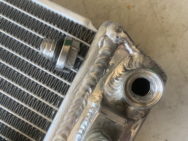

    I have had this happen once before. So let's say hypothetically from the perspective of the manufacturer, the drain plug went in just fine. Then when you tried to pull it out, it galled all up.
    In my case, I had just finished welding on an aluminum threaded flange for a threaded cap, for my radiator overflow tank(custom). It had just cooled down enough to hold. I threaded in the cap by hand, which was also aluminum. Anodized, if it matters or not. Unscrewed it, and rescrewed it to check that nothing was warped. Walked two houses down to show my neighbor. Tried to unscrew it......only a slight bit before bound up. And there I learned that it had galled up somehow. Had to twist it off in a vice and weld a new one on again.
    Something related to the timing of the weld, to the insertion of the cap, caused that problem. May not be the same. May be. Someone reading this may know exactly what happened. I do not. Just that I not give it more time to cool, when messing with threaded aluminum pieces.
    **edit** Just realized that I had already stated that. I will leave this explanation, as it has more detail.

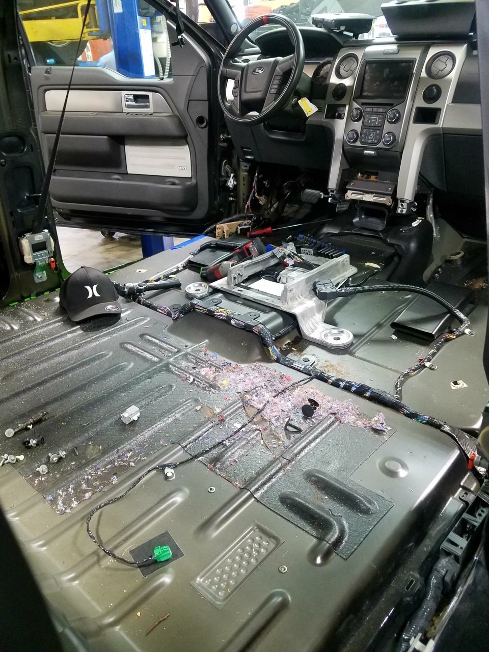

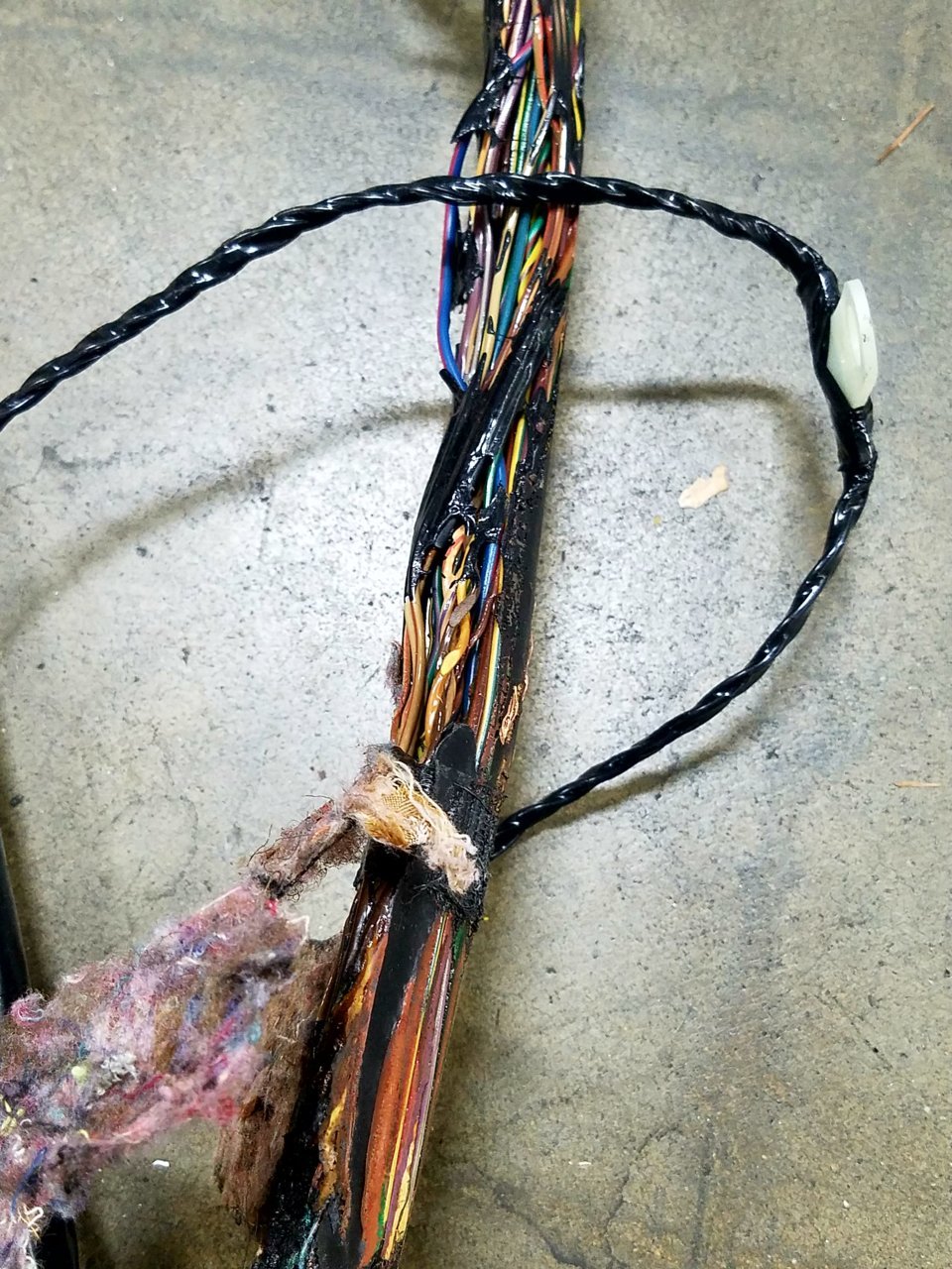

    Our quick service dept has a whole pile of old evaps, condensers and heatercores in a corner. I see what they do daily. Dash and underdash work isn't for me. I'll stay in my dept doing motor rebuilds and swaps ..
    How about a complete harness replacement on a Raptor due to excessive heat from the exhaust system. Harness was too damaged for any kind of wire repair.. One of the rare times that M time was allowed on a warranty ticket

    Eesh. Needs some better shielding underneath....
