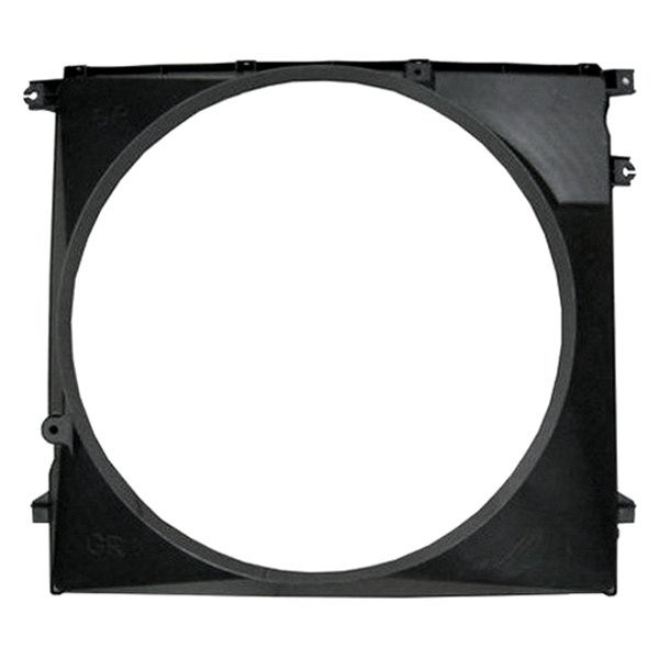

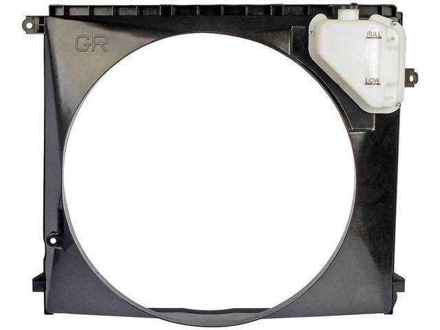

    The FJ shroud needs an FJ reservoir. I’ve got both ready. :thumbsup:
    The FJ reservoir mounts to the shroud just like on the Taco. It’s just a different shape.

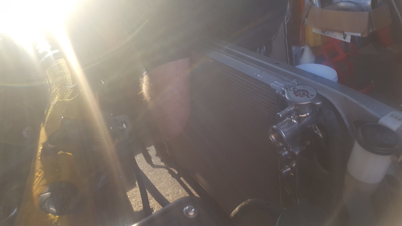

    The reservoir is a separate tank that bolts to the shroud. Unlike to taco that is molded in. So another $15_20. O look at both on rock auto and I want to say less than $50 for both
