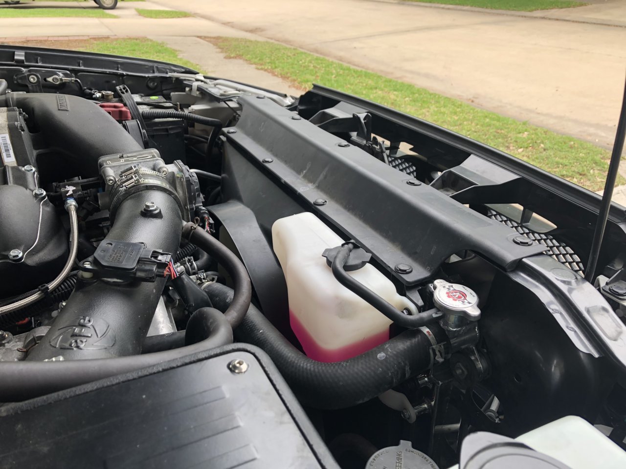

    I forgot to ask.....did you add the weather striping for good measure still to the fj shroud? Or just install it as is?
    loginfailed[QUOTED] likes this.

    Yes, I put a strip along each of the four sides. Same stuff that @Roostfactor linked to in the OP.

    I didn’t have any of these U-Nuts/Speed Nuts on hand so I used nuts and washers but for mounting the reservoir to the shroud, two of these are needed.
    Steel Tapped-Hole U-Style Clip-On Nut, Plain Finish, Metric, M6-1 Thread Size, For 0.8 mm-4 mm Material Thickness, 12 mm Edge Distance (Pack of 25) https://www.amazon.com/dp/B00C3MUY9K/
    You can probably find them at the auto parts store or hardware store.

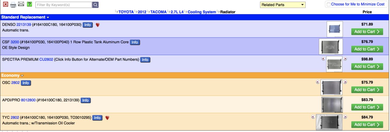

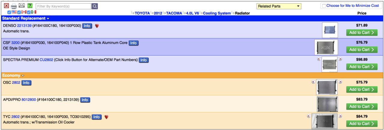

    Just to completely understand and revisit the purpose of the original thread, if we buy one of these radiators, and a FJ fan shroud, and an FJ coolant reservoir, its a direct bolt on for the Tacoma? I have an 06 2.7l with a 5 speed, but I would think it would be the same correct?
    loginfailed likes this.

    we know it works for the 2nd gen 4.0l thanks to @loginfailed. You can try it for the 2.7l but no one knows for sure
    Roostfactor[OP] and loginfailed like this.
  19. Apr 9, 2018 at 5:53 PM
    #439
    loginfailed

    If you believe rockauto.com, 2.7 and 4.0 radiators are the same part number. So if it fits a 4.0 it should fit a 2.7.
    www.rockauto.com
    2.7
    4.0
    Roostfactor[OP] and mynewtoy like this.

    06 Extended cab Prerunner 2.7
    Dirt King Mid travel with King 2.5 coilovers, Baja Kits chase SUA with 14in fox smoothies under custom hangars.
    100% it fits a 2.7l
    ....again
