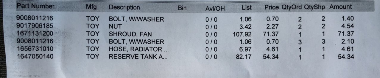

    Did the same, but I got them online and it all came to my house. I find this place to be cheaper than local: https://toyotaparts.mcgeorgetoyota.com/

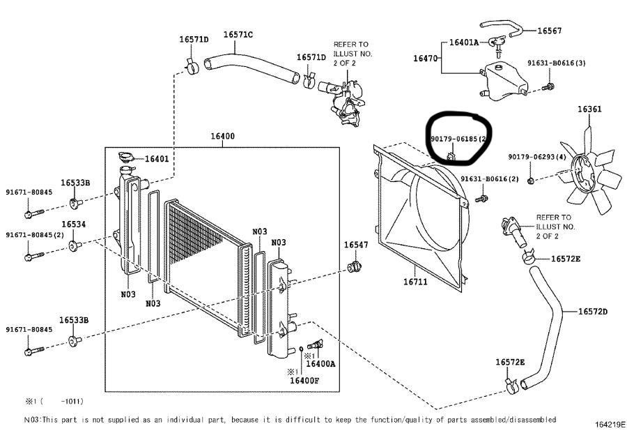

    Toyota part #s if anyone wants them. Parts are made in Japan. Well I don’t know about the 5 bolts and 2 nuts since it doesn’t say. The shroud, overflow tank and overflow hose are though.

    All my parts are stacked in my garage. Do I need bolts for those little clips?

    I just ordered the ones in that list....
