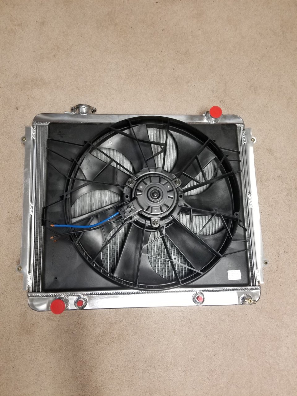

    Skip the flexalite junk..
    Do this:
    1. Buy Lincoln Mark VIII fan https://www.ebay.com/ulk/itm/123068019389
    2. Buy DCC fan controller http://www.dccontrol.com/relay_controllers.html
    3. Read this http://forums.tccoa.com/6-general-tech/136722-ultimate-mark-viii-fan-thread.html#/topics/136722
    And you end up with this.
    Still working on the shroud cover and controller box, but it will be a slick setup. Low speed for crawling, high speed for quick cool down and back road towing.
