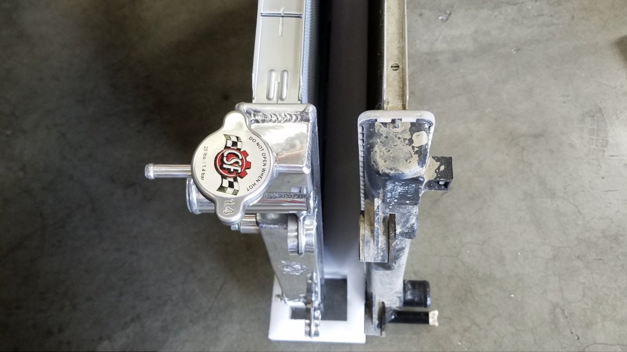

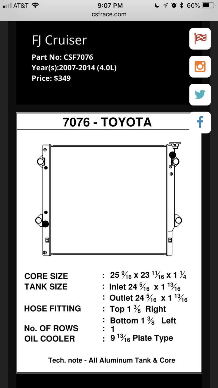

    Hey @Roostfactor is that FJ rad any thicker than the Taco one?
    I was looking at my truck again. I’m going to need to space at least the bottom of the FJ rad out to clear my custom crossmember.
    I measured tonight. It’s roughly 3.5” between the fan blades and the rad now.
    Not sure what’s needed to be safe. Obviously, less than 3.5”

    I don’t know the exact dimensions but it doesn’t look that much thicker overall, if you look at the end tanks.
    Roostfactor[OP] and Biscuits like this.

    Hmm. Once you have the FJ radiator installed, I'd be interested in the inlet and outlet temps.
    Living on the wild side.
    Y'all need to stop focusing on the problems and focus on solutions.
    @Roostfactor pack up your tools and come to Houston. Everyone wins.
    Is there a cut away or cross section available?

    Not that I have seen.

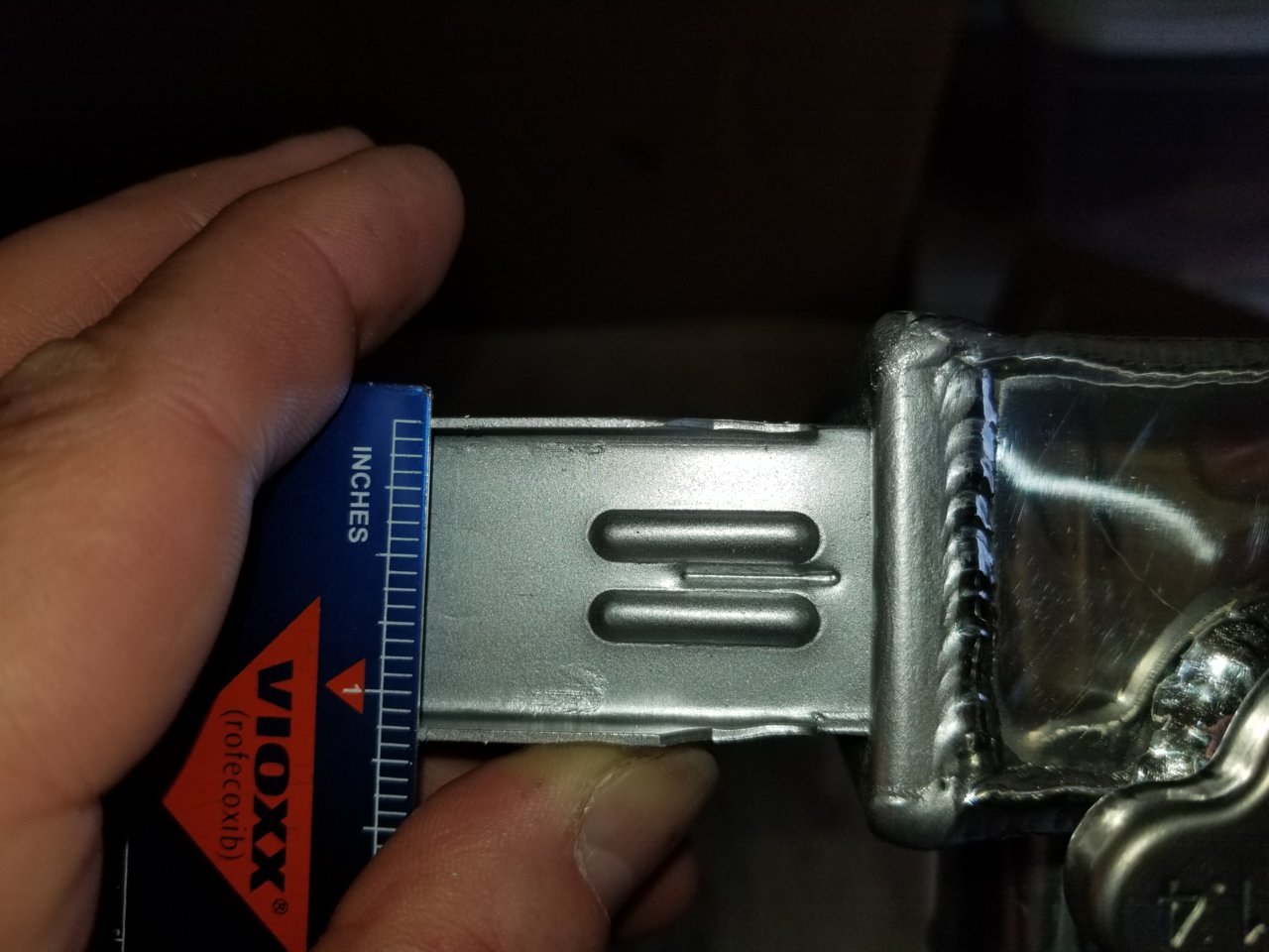

    I think stock is 5/8 or 3/4 thick on Tacomas.
    You need to check fan clearance though at full song which means hot radiator + max a/c so clutch fan is fully engaged then give it a run at max rpm.
    You need to have something that will indicate how much clearance you have, something that will wear away when the fan blades hit it but doesnt break the fan blades. (Thinking out loud here)
    So your saying your radiator as it is now sits closer to the fan than it did when stock?

    Post or send me a couple pics if you can so I can see what you are talking about. The lower drivers side of the CSF is about 1/4 wider than the stock radiator but there is still clearance to the drivers side frame rail.

    Right now, my radiator is right where it came from Toyota. My crossmember doesn’t neck down like it did from the factory since it’s beem replaced with a full square tube.
    I believe I will have to space the new radiator back towards the engine a little to avoid it contacting the rebuilt crossmember.
