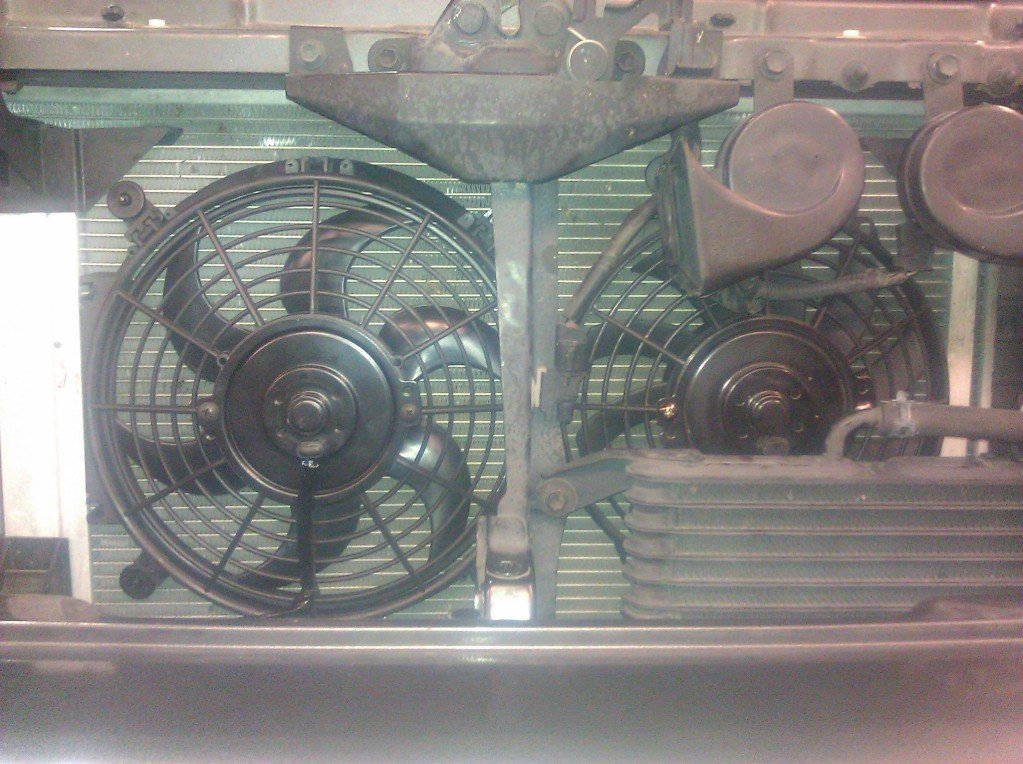

    What about keeping the clutch fan and installing this ? FD2115B1-21BB-4985-826E-6F628031E483.jpg

    One problem with pusher fans is they block some of the airflow. Granted, when they are running, the moving air will make up for the blockage, but when they are not on, heat won't bleed off as fast.
    IMO, running both types of fans is redundant. You won't get much(any?) additional cooling, and will have extra parasitic drag.
