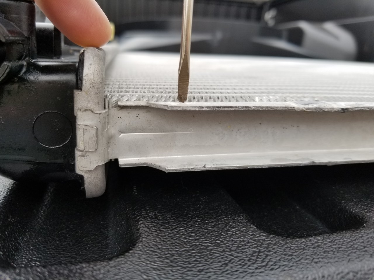

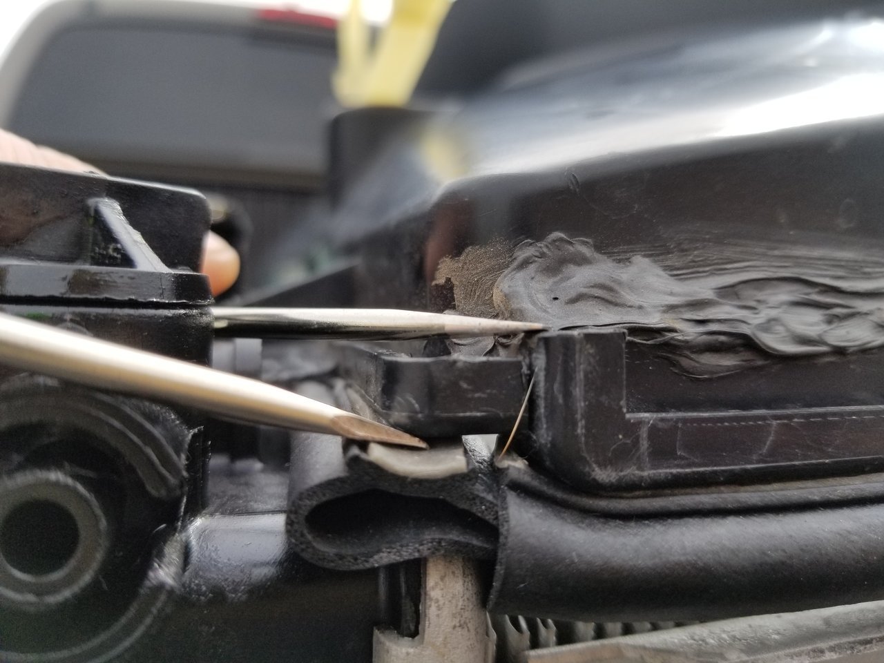

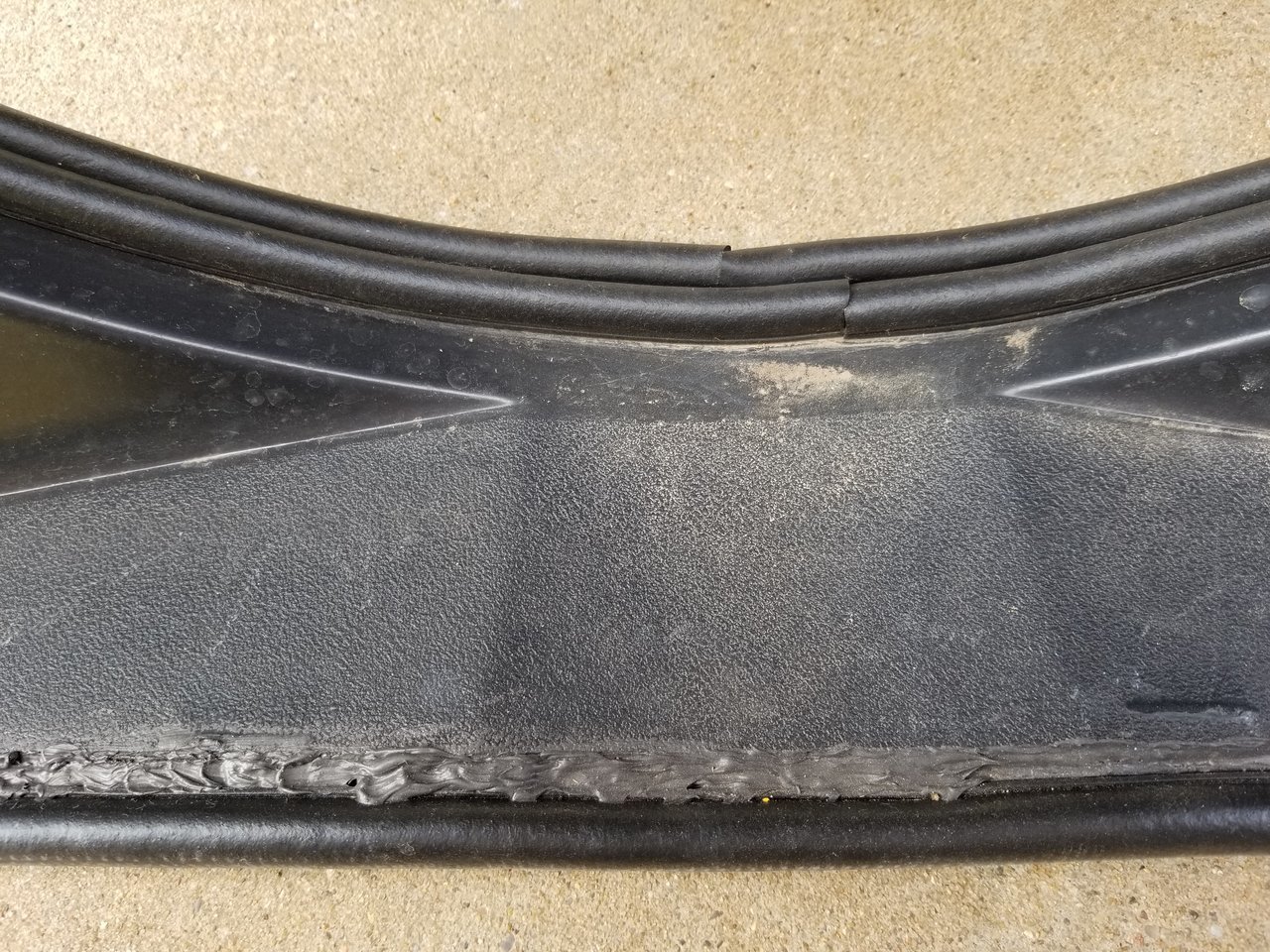

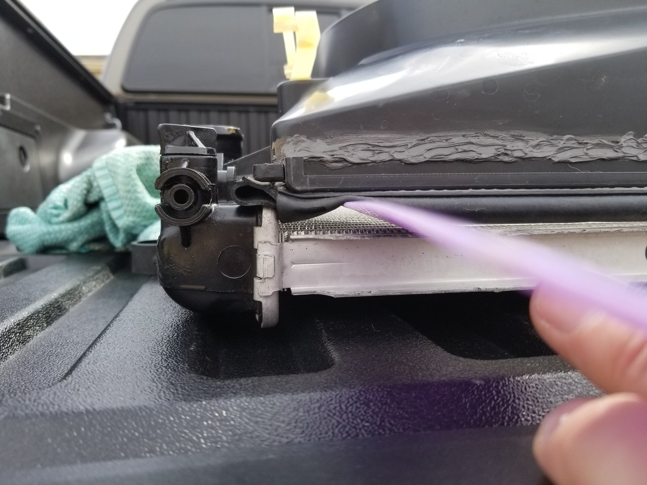

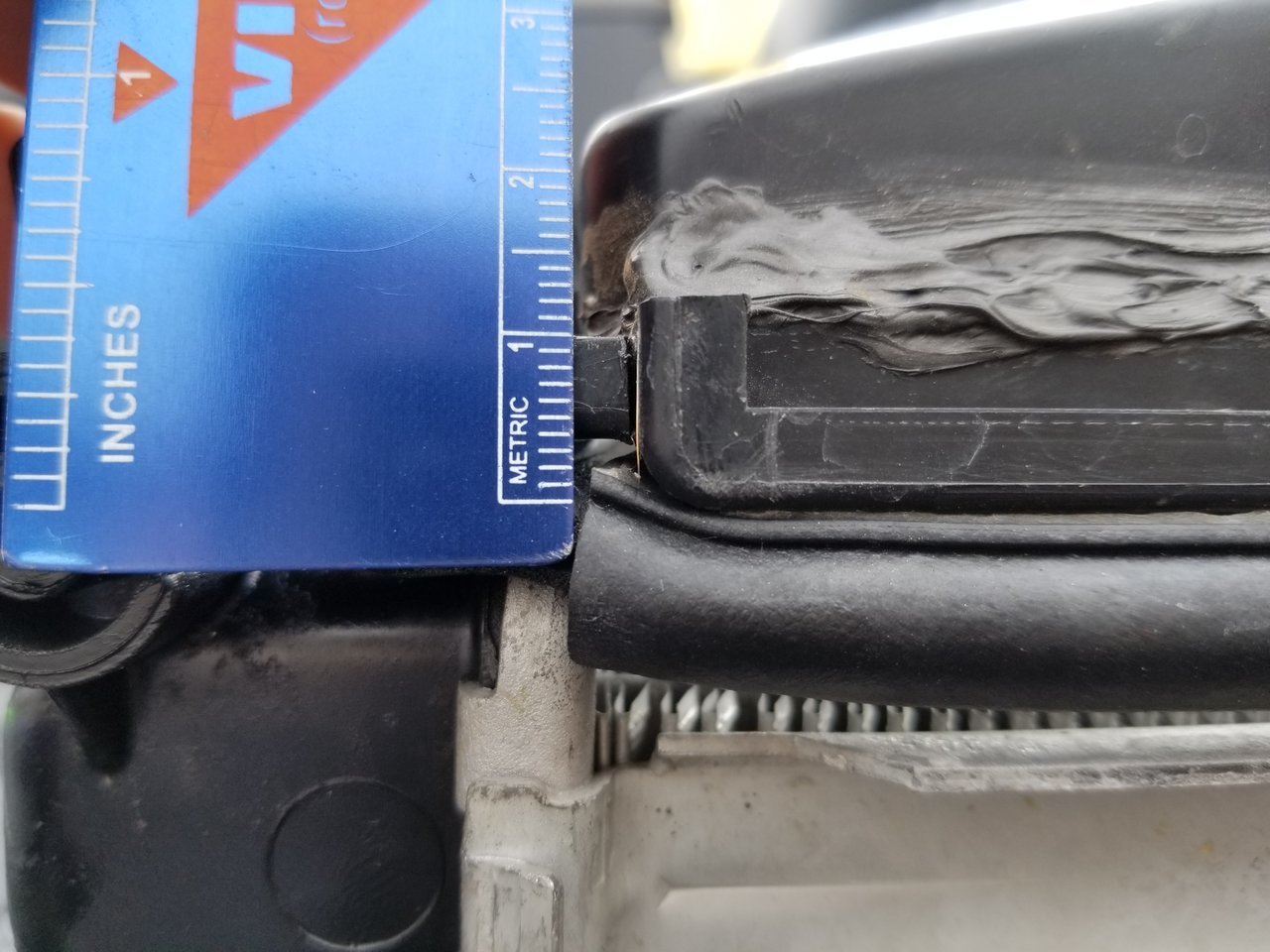

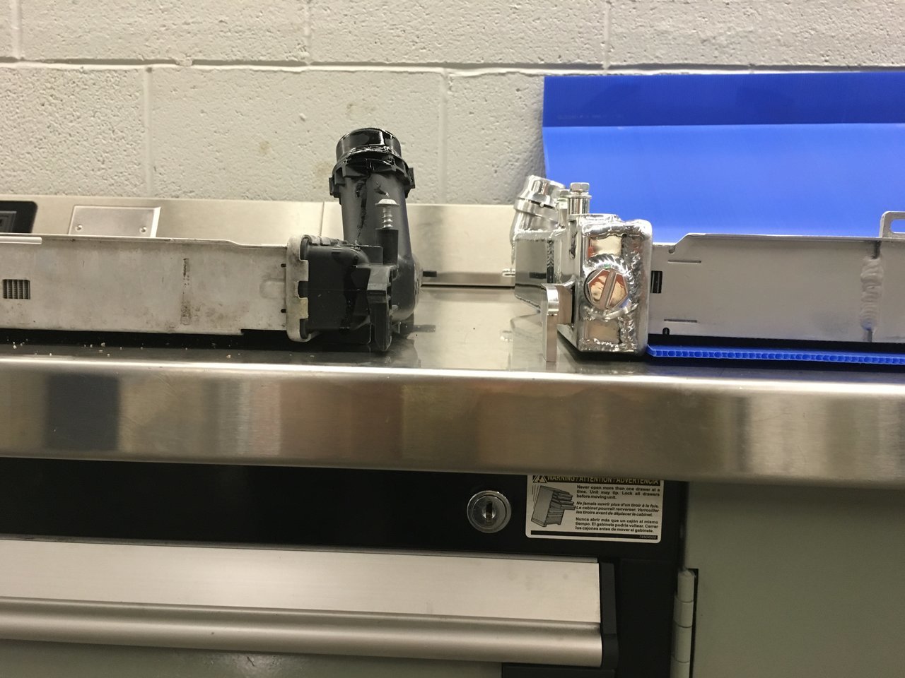

    I put the weatherstripping on the bottom and both sides. Don't put any on top.15213146596981928279961.jpg
    Rtv the top and bottom of the repositioned lip.
    Note the weatherstripping around the area where the fan sits. This is not required but it proves a closer tolerance of the fan tips to shroud which should increase airflow through the radiator. I used this method over other options because if the fan were to hit the weatherstripping the weatherstripping would give, preventing fan breakage.1521315236997373640731.jpg
    This is the modified shroud attached to the stock radiator. See the gap where I am pushing the weatherstripping up? This gap is not there with the unmodified shroud but since the new radiator is taller the bottom lip of the unmodified shroud rubs against the radiator fins and not on the bottom radiator casing. Recessing the bottom lip and installing weatherstripping prevents that rubbing but still provides a seal for the shroud.1521316356881128851961.jpgsee the two screwdrivers? The piece where the top screwdriver is resting used to sit where the bottom screwdriver is.15213166331831656165633.jpg
    The reattach piece is now sitting about 5mm (toward the radiator) from flush. This does not have to be exact since the weatherstripping will fill a pretty good sized gap.
    You can look at the pics in the first post to see how much the lip protruded prior to modification.
    The bottom lip rest where the screwdriver is on the stock radiator and the sides of the shroud rest where my finger is.
    Hope this helps clear up any confusion.
