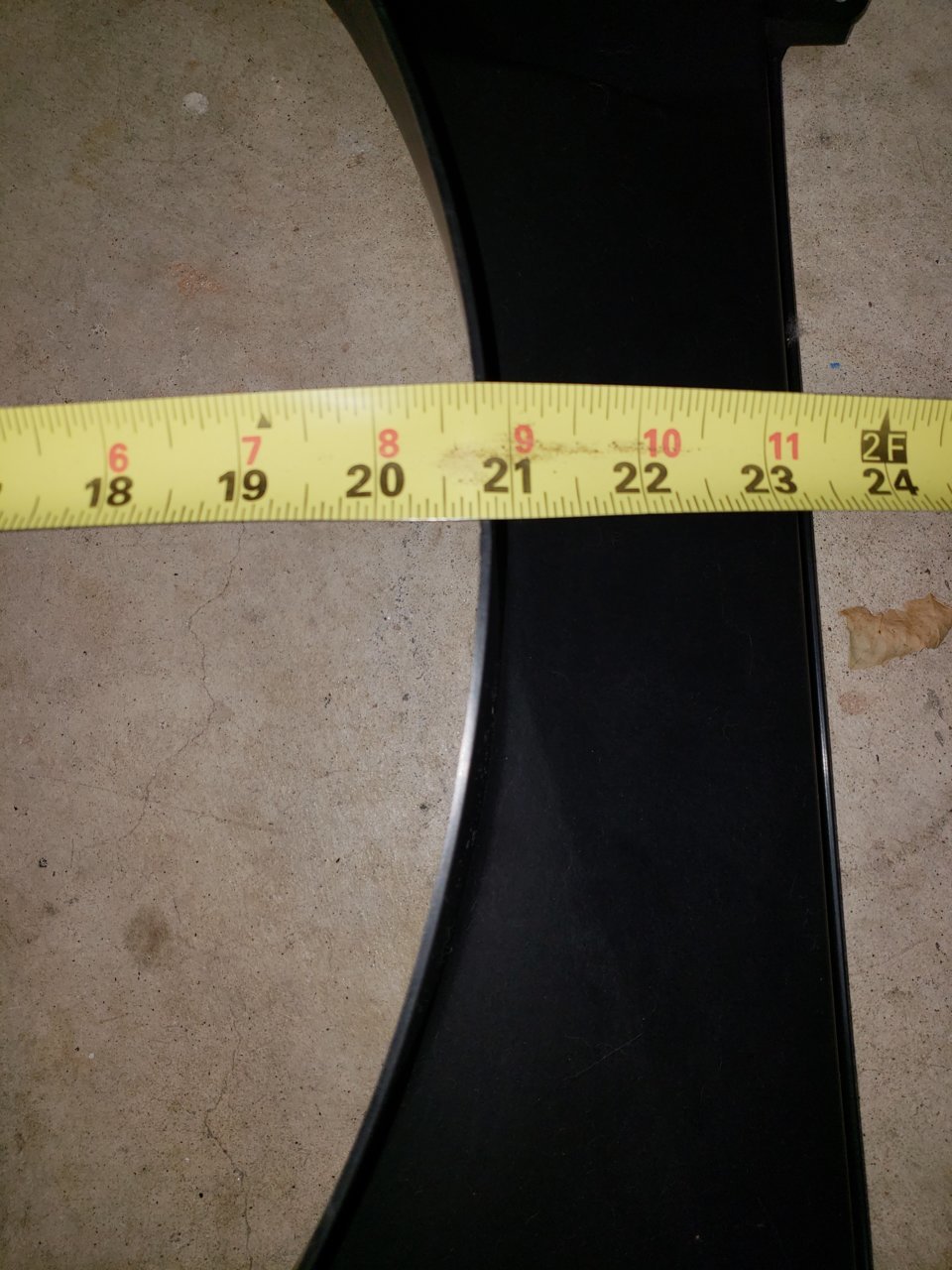

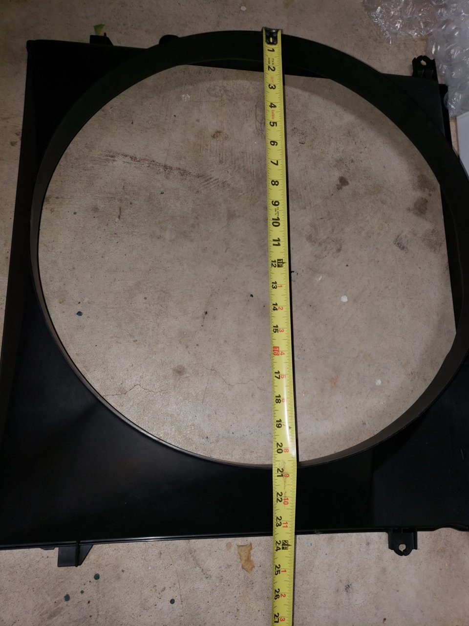

    Anyone the diameter of the stock clutch fan inside the shroud?

    I know my autocorrect fucked up but it was a pretty straight forward question lol
    What is the diameter of either the stock fan or the inner diameter of the stock shroud?
    I would grab it myself but I’m out.

    @Roostfactor

    Not really, I didnt know If you wanted the diameter of the clutch fan or the stock fan shroud. Very different dimensions.

    Aren’t they only off by a few inches or so? I have yet to pull it out but it looks like the fan itself rides pretty close to the shroud.

    The fj shroud is approx 2 inches taller but the same width. The opening for the fan is probably the same. I am pretty sure they use the same clutch/fan combo as the tacoma. There is about 1" gap between the stock fan and shroud. (Not actual measurement)
