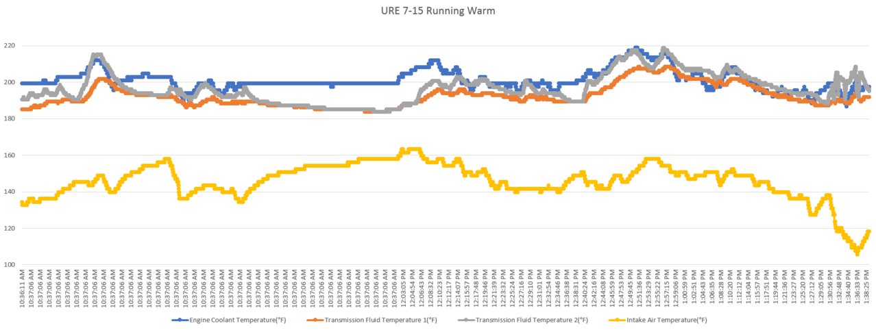

    On the topic of Trans temps with aftermarket coolers. Here's my data with factory Rad and B&M 70264, full skids and ARB bumper(not that I think that makes a difference).
    back roads
    offroad

    Very nice data, thanks for sharing!
    What are you using to log this?

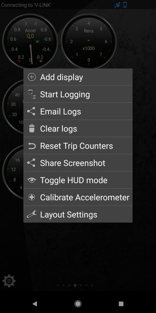

    ELM327 Bluetooth OBDii reader and Torque

    I have torque pro and I havent seen a log like that. Are you importing it to excel or something?

    Yea run the logging and then import it to excel and make a graph.
