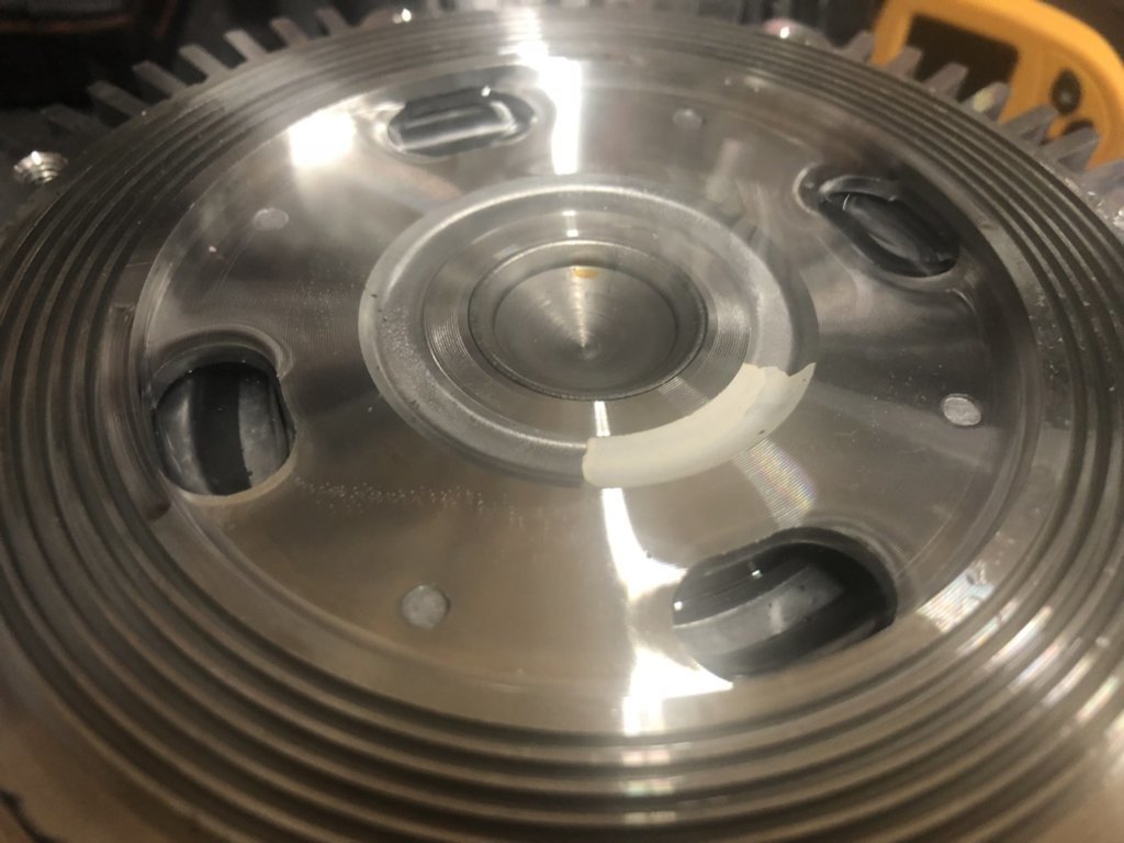

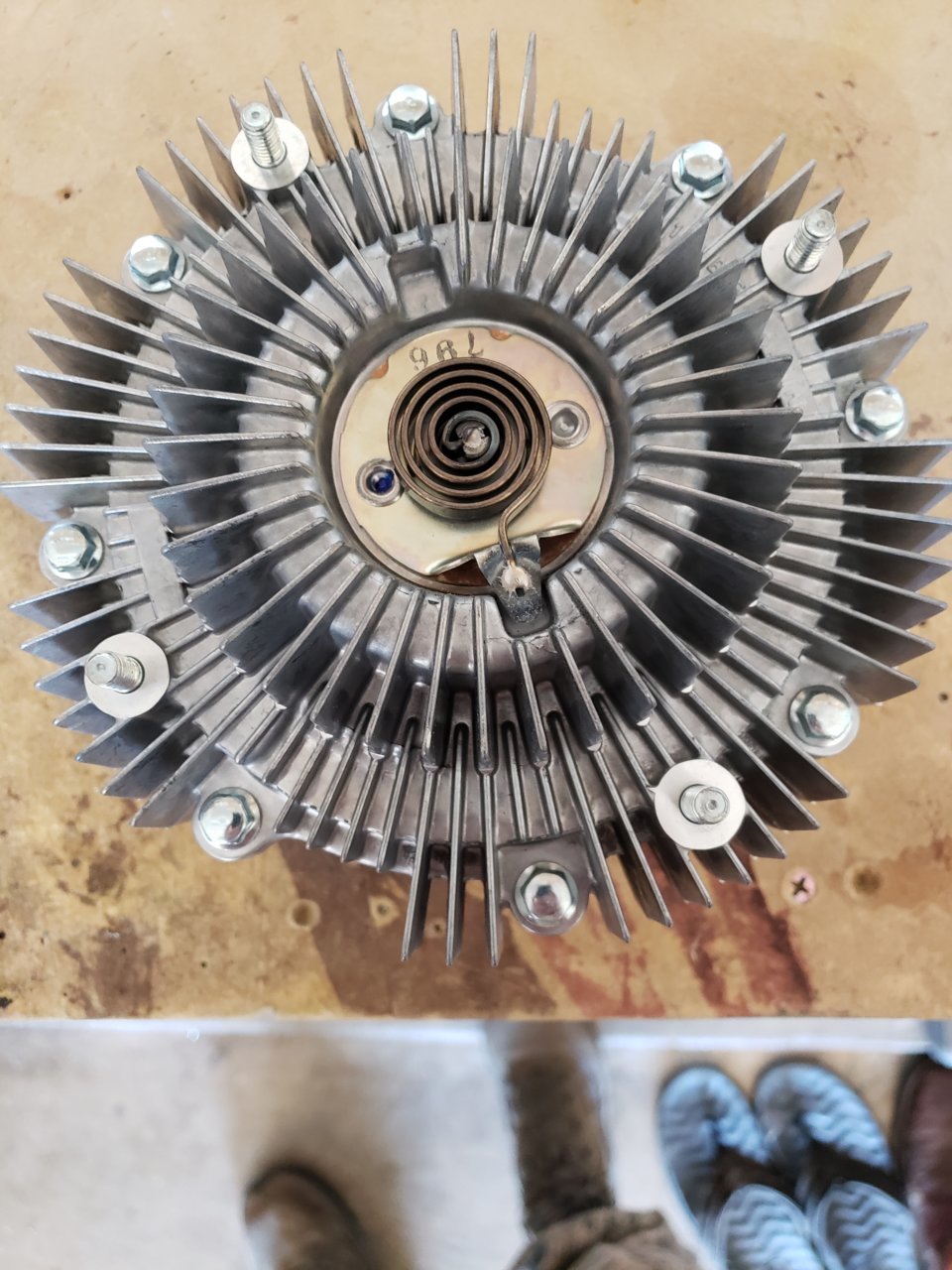

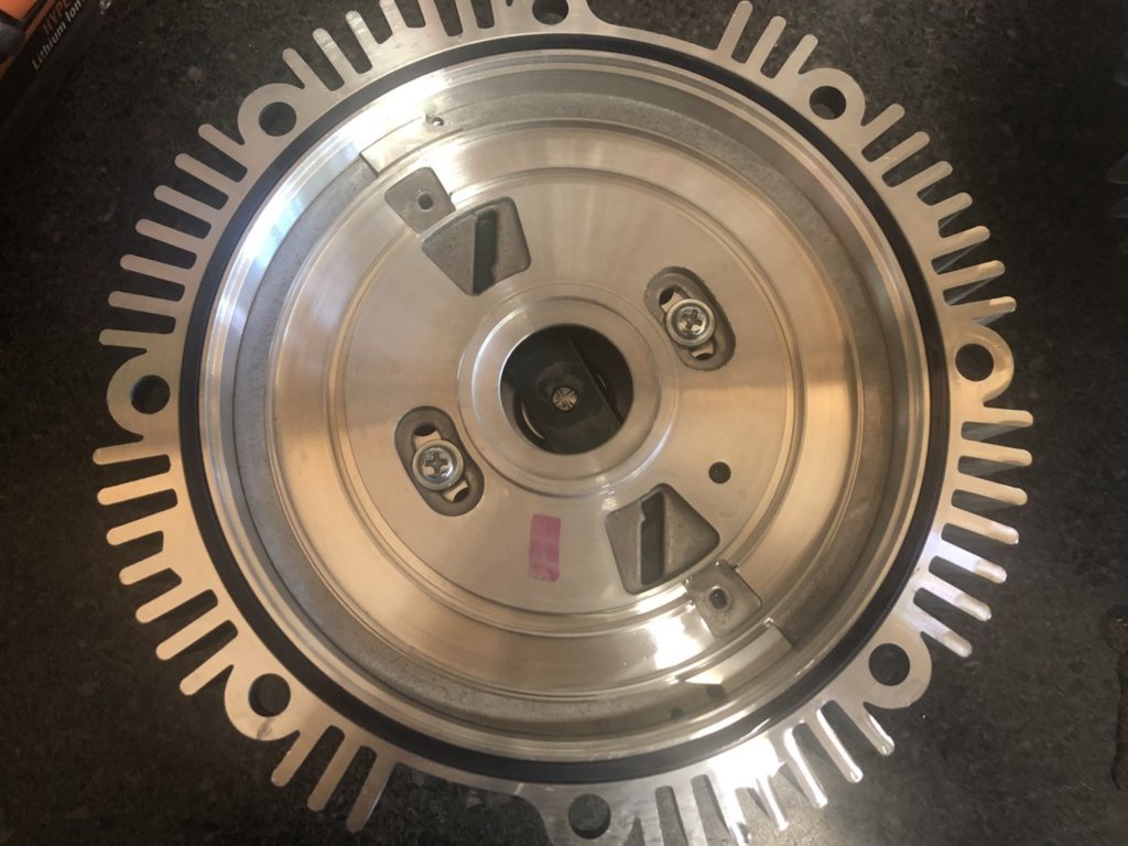

    Basically you split the fan clutch in half and change the silicone oil to a thicker oil and you can also adjust the temp in which the thermostat (the spring on the front of the fan clutch) starts to engage the fluid coupling.
    I actually have mine start to engage at a higher than stock temperature so it's not loading the engine all the time, then with the thicker oil it engages harder to pull more air through the intercooler, condenser, and radiator.
    This is the spring that senses temperature. It is adjusted inside with 2 Phillip's screws.03803702-6CDD-453F-AE39-8ED669642484.jpgthis is the reservoir side. You can see the clear oil in the hole. I filled mine to a little below the bottom lip of the opening with 10K Team Associated silicone oil you get from R/C hobby shops. Stock fluid is 3K I think so the thicker fluid engages harder.
    These are the adjustment screws. There is a black metal bar in the center which is attached to the thermostatic spring on the outside. When the spring heats up the metal bar starts rotating to allow more fluid to flow through the diagonal slots and the little hole outside of the slots.
    There is more info about it online if you google fan clutch mod but that is the condensed version.
    Like I said, I wouldnt mess with it unless you need to have your fan work harder. The downside is it will pull more power away from the engine more of the time.

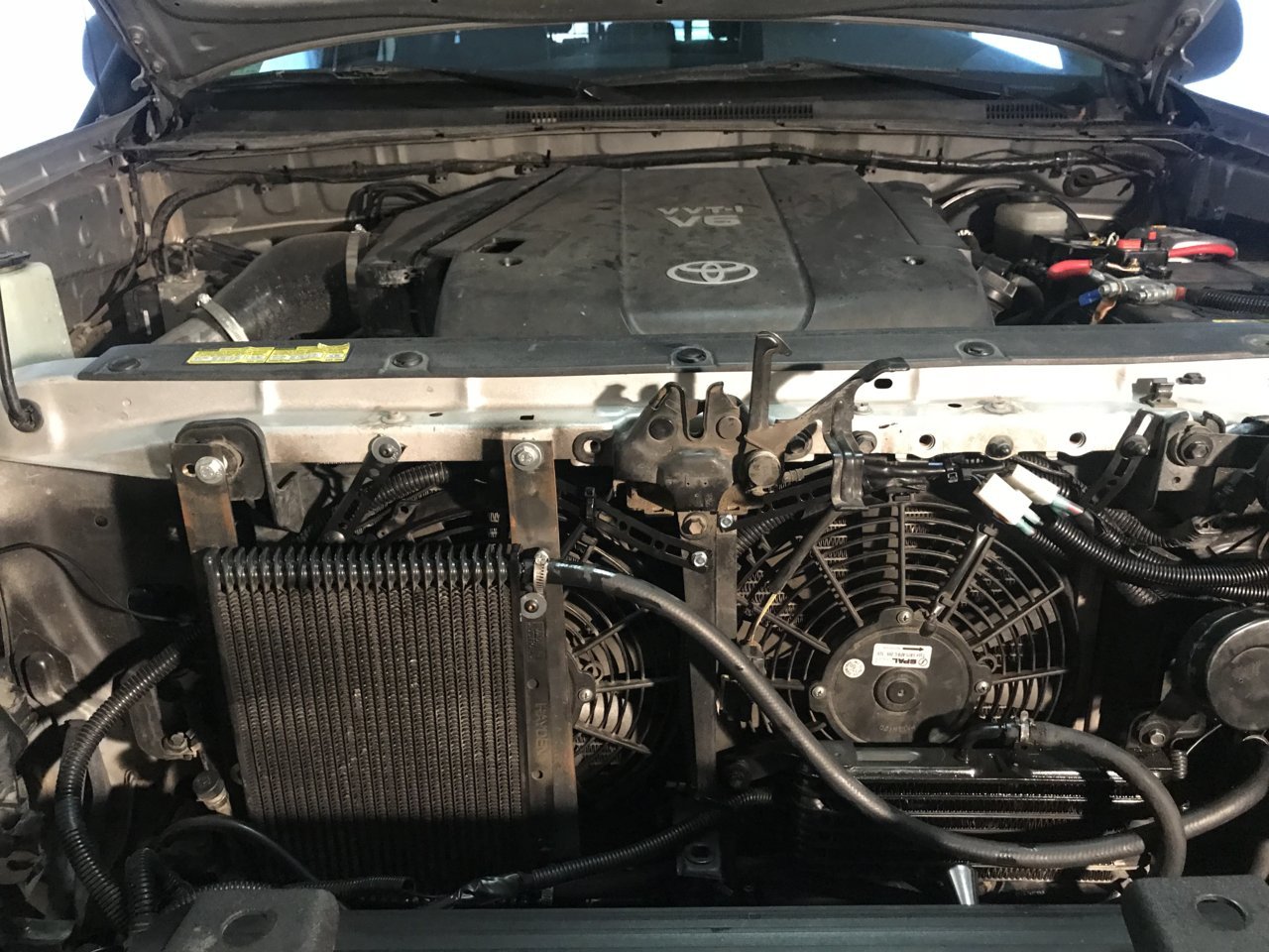

    Electric fan setup is working pretty good for me so far. But costly as @Roostfactor mentioned. My alternator seems to be keeping up, but I'm considering a Mechman alternator as one of my next mods. I like to bump my sound system while in traffic. Adding ~30-40a of fan draw to the equation, I'm sure the stock alternator isn't as comfortable as it once was. Also I'm considering a wider trans cooler and adding a couple small pusher fans on top of the trans cooler, since where the trans cooler will end up is at the bottom of the radiator (behind the plate bumper and winch).
