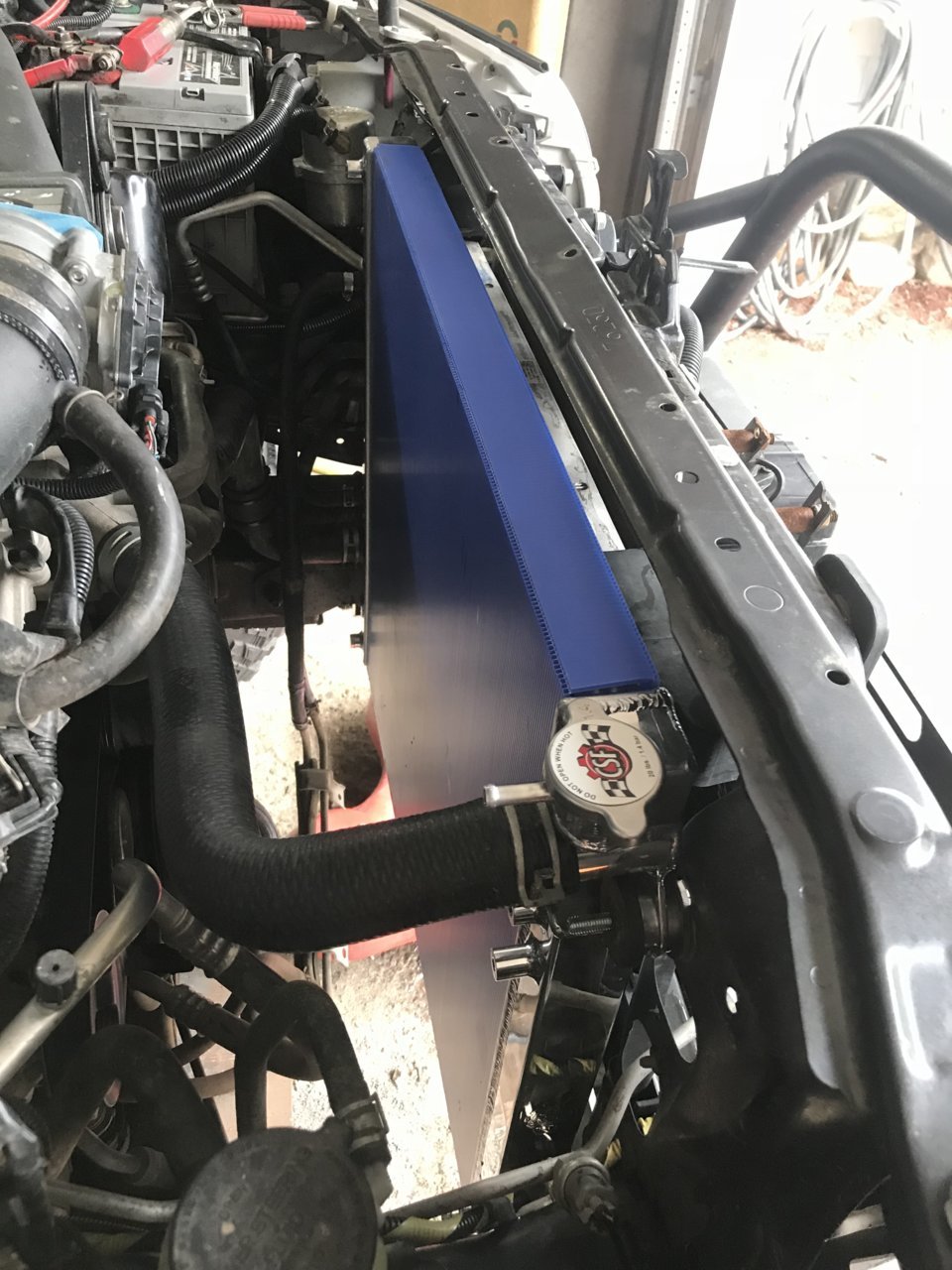

    Well, the install went well.
    Out with the old
    In with the new

    But, on the first drive. A very easy first drive because it was also the first drive on my new diffs, I hit 200*.
    TBH, I never paid much attention to coolant temps until I noticed it going over 210* while towing this summer.
    Wasn’t expecting 200* on an easy drive on a 59* F day though.
    Makes me wonder if I have another issue. Fan possibly.

    Just curious, did you use the rubber trim gasket between the shroud and the radiator?

    I did not. I was thinking that that was only needed if making the Tacoma shroud work with the FJ rad.
    I used the FJ Shroud.

    There is a gap. Damn it.
    I’m going to order a new fan clutch. They’re cheap enough. I’ll put the weather stripping on when I swap the clutch out. Maybe screw with the oil too.
