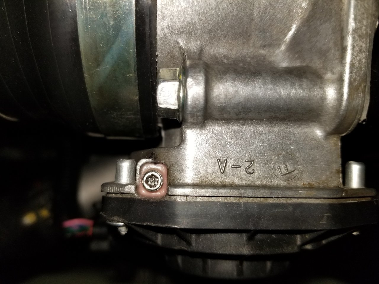

    76mm can be easier to find and I have tinkered with them some.15214221472211455725503.jpg
    See the adjustment screw? It is covered with epoxy from the factory. Chip away the epoxy, Mark the set screw for future reference, the turn counter clockwise one complete 360 degree turn. This closes off the butterfly some which eliminates the super high idle people have issues with. The ecu adapts much quicker because it doesn't have to compensate as much. I just dropped some locktite on top of it after adjusting which is what you see in the pic around the adjustment screw.
    Torspd, Lord Helmet and JuanitoBonito like this.

    That screw strips easily as you can see. I tapped in a torx bit because I had stripped the Allen key. I got my tb for $50 because the plastic cover was chipped.
