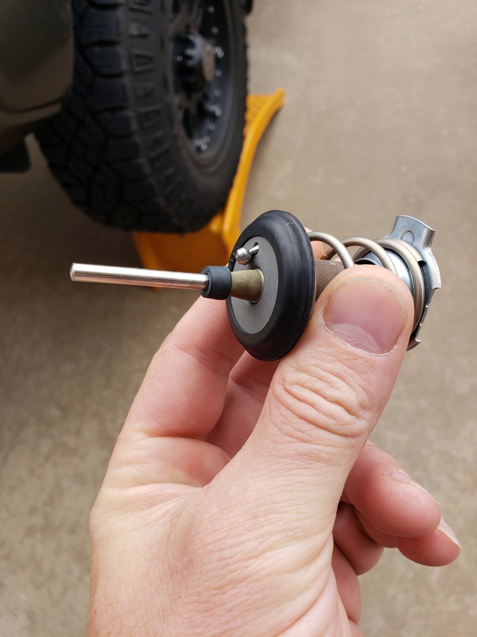

    Alright. Hood open, idling, 170 T-stat.
    Temps rose fairly steadily until 175-177. Slowed and climbed slower. Leveled off at 186. Holding for now.

    #994
    Roostfactor
    Roostfactor [OP] Well-Known Member
    Jun 2, 2015
    #156609
    3,885
    John
    TX panhandle
    2015 DCSB OR Pyrite Mica
    HPT/justDSM tuned factory ecu, URD Headers, JFR Y-Pipe/l 3" exhaust, Walbro 255 fuel pump, Maggy SC (JFR ported), JFR ported lower intake manifold, 76mm tb, 2.5 pulley, 640cc injectors, CSF Radiator, custom electric fan wit Autocoolguy controller, JFR SC pulley wrap mod
    Sounds like thermostat is working fine.

    Yeah, I let it idle until just now. 186 and stayed there.
    Ucon is supposed to come with a 170 thermostat.
    I have proven this in the past that the 170 tstat that comes with the ucon runs at 185. So does the stock tstat. I chatted with @Torspd about it and tested the 160 last winter. It runs at about 175 instead of 185.
    It's funny that now URD offers the 160 as an option :rofl:
