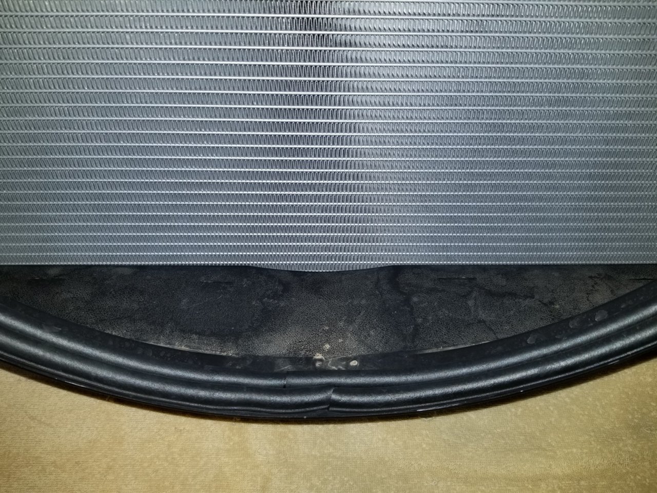

    I have two rows of weatherstripping on the inside of my shroud to get the fan to seal better. It definitely does and I figured when I did it that if it ever rubbed the fan would win.
    Just make sure you have clearance all the way around between the fan and shroud. I did (about an inch all the way around) but if you have modified or worn radiator support bushings alignment may be different. I know you have some beefed up front end trickery going on.

    @HolyHandGrenade, here is a pic of the weatherstripping I installed.

    Nice. Thank you Sir

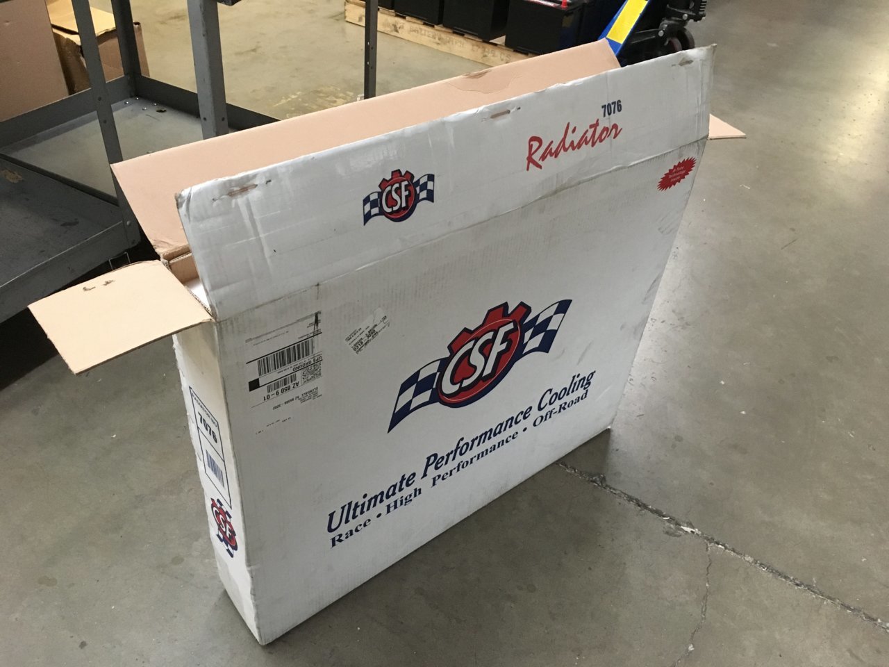

    It has arrived
