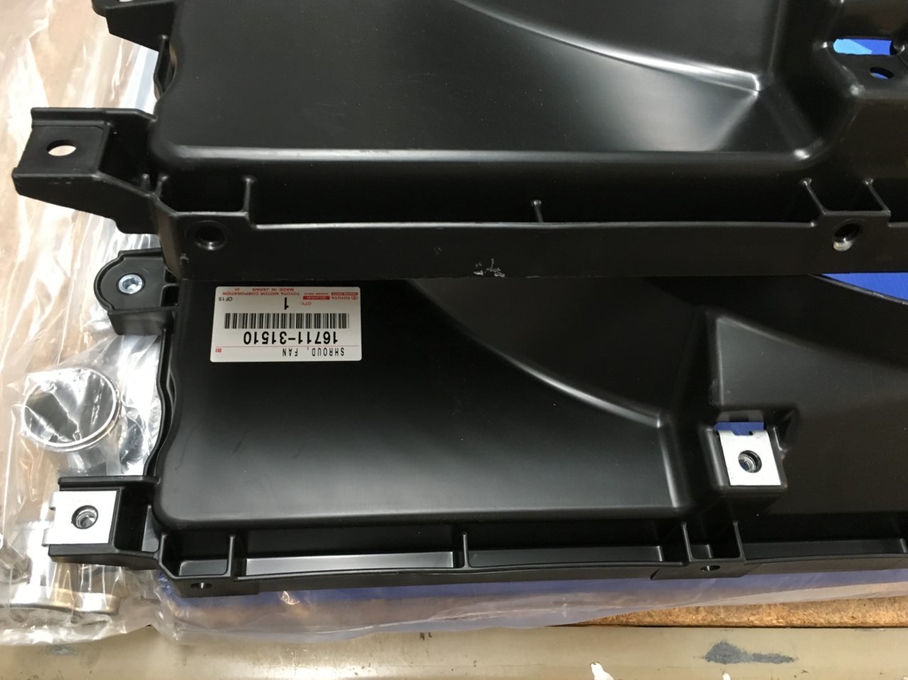

    Is it OEM?

    Yes, from toyotapartsdeal.com

    Yes. OEM parts. Pricing is not at my fingertips at the moment. They’re both in the same ballpark though.

    Never thought to even order an FJ shroud

    Nice! I didn’t know the later model range shrouds were a improved design. Doesn’t really apply to my setup anymore, but good to know!

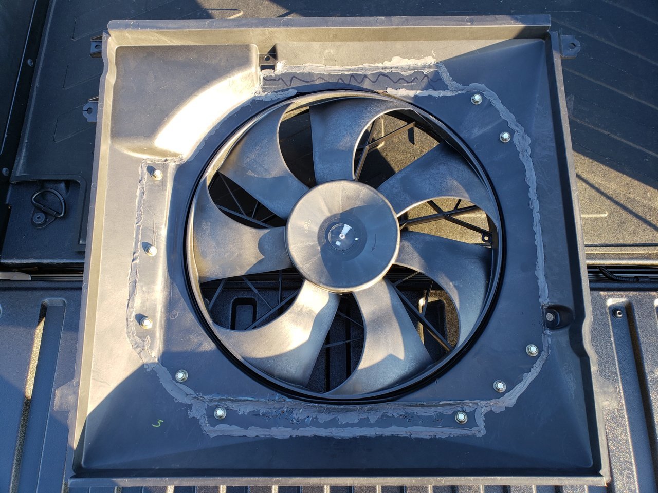

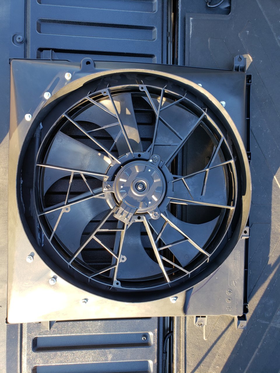

    Or install one of these.
    Yep that right, big ass oem fan in FJ shroud.
    WARNING!!! Not for the faint at heart. This was a pain in the a$$! But...oh so factory looking!
    The inside...not so factory looking, but sealed.

    @Roostfactor daaamn... that's awesome ( AND supercharged? you lucky duck)
    Are you worried about the stress/vibration cracks between the fan/shroud?

    I do NOT want to build another one of these! It was also a very tight fit getting the fan motor past the thermostat housing.
    This is a bigger fan than @loginfailed's. I think its 17.5 or 18" while his is 15" I think. His has a bitchen mounting flange though to make it much easier to install and supposedly they share the same motor.
    My fan is from a mid 90's Ford Thunderbird. Around $70 at Rockauto. But I also made a relay box to finally fix the sc intercooler pump running after shutdown and also for my Autocoolguy PWM controller to only come on with ignition on.
    The polls so much air and barely makes any noise and with the controller the fan soft starts then only runs fast enough to keep the radiator cool. Then there is an independent setting for fan speed when ac is turned on. I havent had time to mess with it much as @rjbiii is over right now.

    No, not at all. It is a balanced and smooth running fan. Plus with the two shrouds bolted and silicone sealed together they are essentially one piece now.
    If I did it again I think I would just make an aluminum shroud like @loginfailed did. It would have been much easier but I am hard headed and was determined to have the factory look.

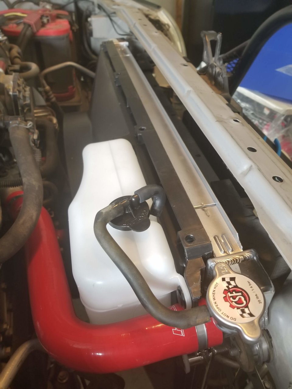

    Got mine installed today.
    I put fancy new hoses on and installed a new serp belt while that area was clear. Install was easier than I expected.
    I live in the cool part of AZ, but I recently started towing my SXS and was seeing coolant temps over 200* with ambient air temps 80* - 85*. Hopefully this radiator will help.
