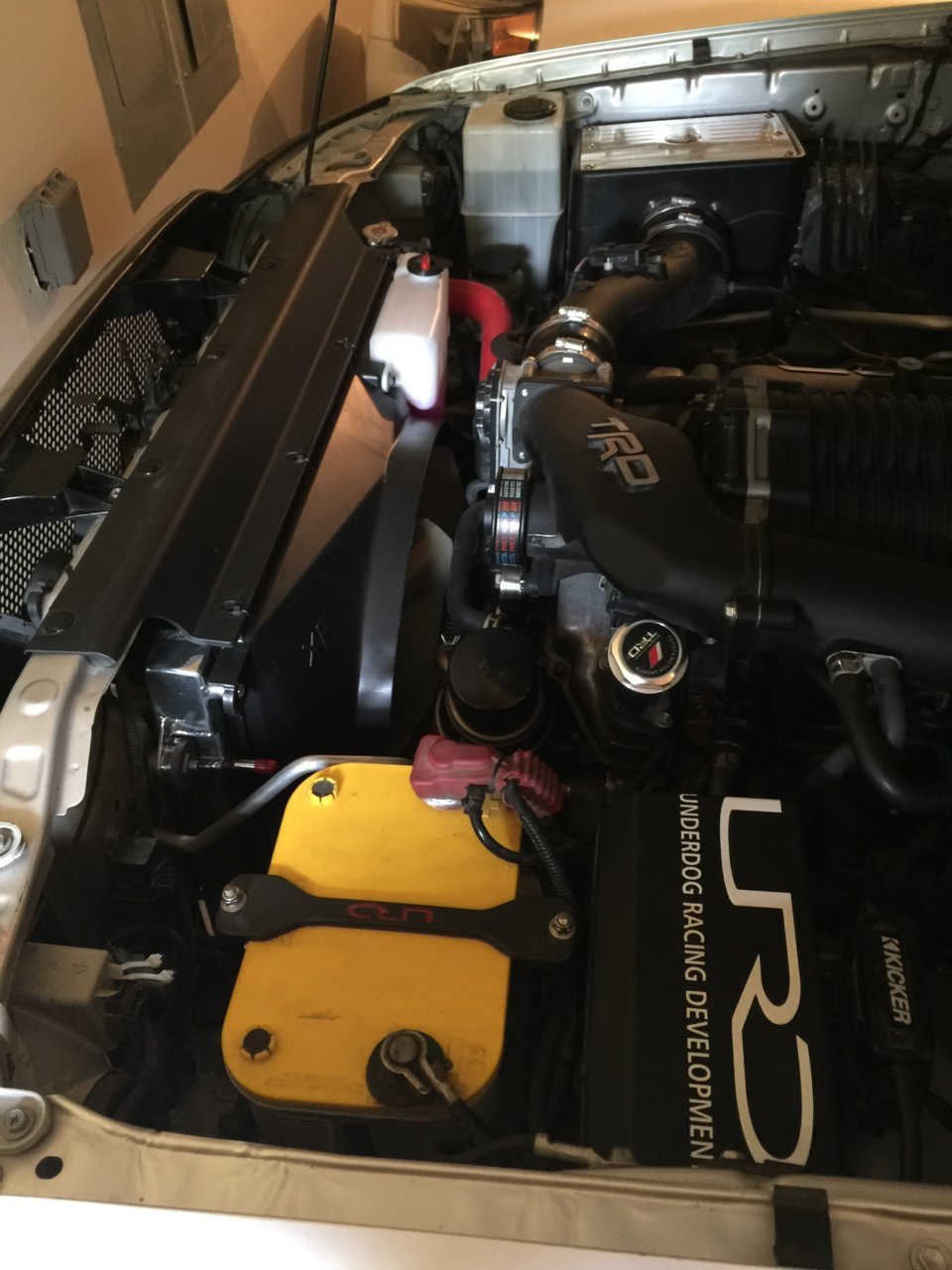

    I dropped mine in today. I used the fj shroud and reservoir method. I’m at 110k so I did the serpentine and SC belt while I was there. Changed the engine and SC oils, and did the diffs and transfer case. I checked one plug from each side and they were fine (@12k). So I’m holding off on that for a few. Replaced the fuel filter and that’s about it. This place is just awesome. It gives me so much confidence whenever I work on my truck.

    Good stuff! Nice clean engine too!

    What are these nice radiator hoses that I am starting to see more of? Where to buy when I do my CSF please.

    Look like they're just silicone hoses

    I bought mine at Amazon. They’re made by HPS.

    Yep, HPS. The only problem is the lower hose wont fit with the sc.

    I didn’t really have a hard time with mine. A couple of on and offs and cutting to fit. Truck is running awesome! Plus I went to fill up with 93 today and said screw it... so I filled up with 101 I’ve never done it and it was pricey but it will happen again. It’s really fun.
