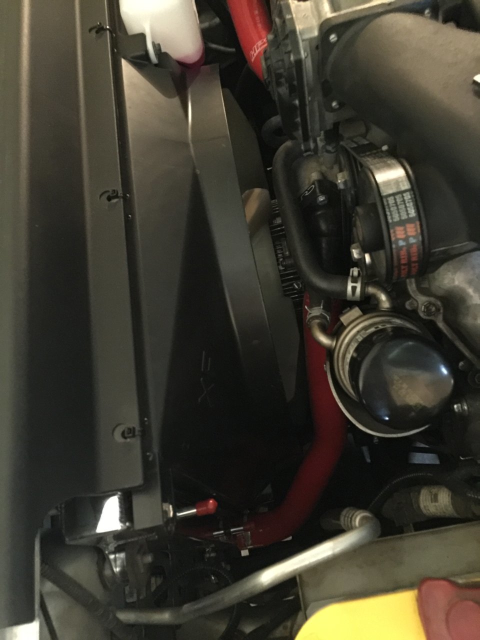

    Hold on.....
    What's with the zip ties?
    You noticed a difference with different octane? If so what tune do you have, etc.
    Welcome to the darkside... if I didnt ask oh so many others would!

    I broke some of the clips and the plugs were 30 bucks a dozen from the local dealer. I just haven't chased any down yet. As for the fuel I did notice a big difference. It feels kind of like it switched into two stroke mode. Just tingy and responsive(always on the pipe) even at lower rpm. Super quick to respond and get there. I will say it is noticeably different than 93. I'm running the TRD reflash with the URD 2.85 pulley, fuel kit, URD stage II clutch with hydraulic throwout, URD headers, ypipe 170 thermostat. Thanks for the welcome.
