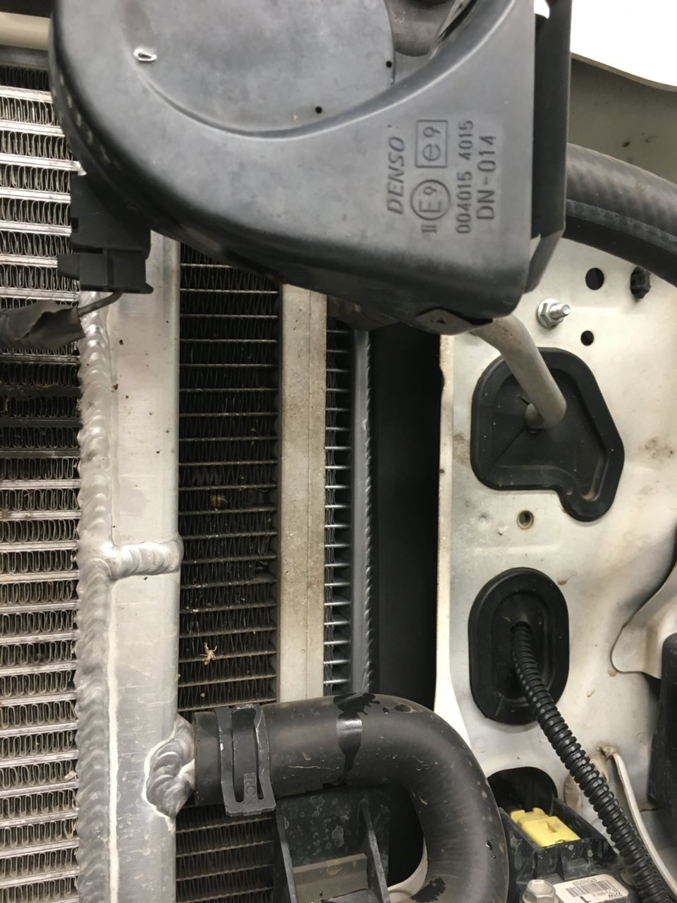

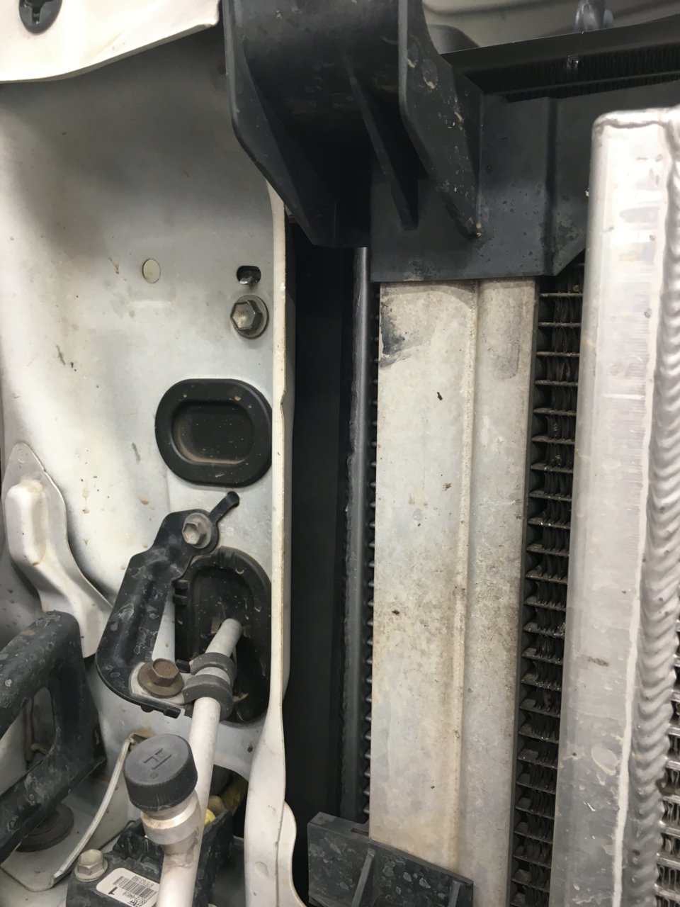

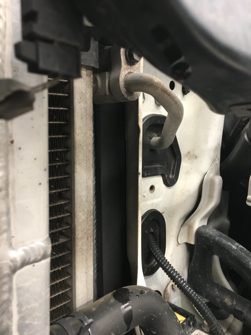

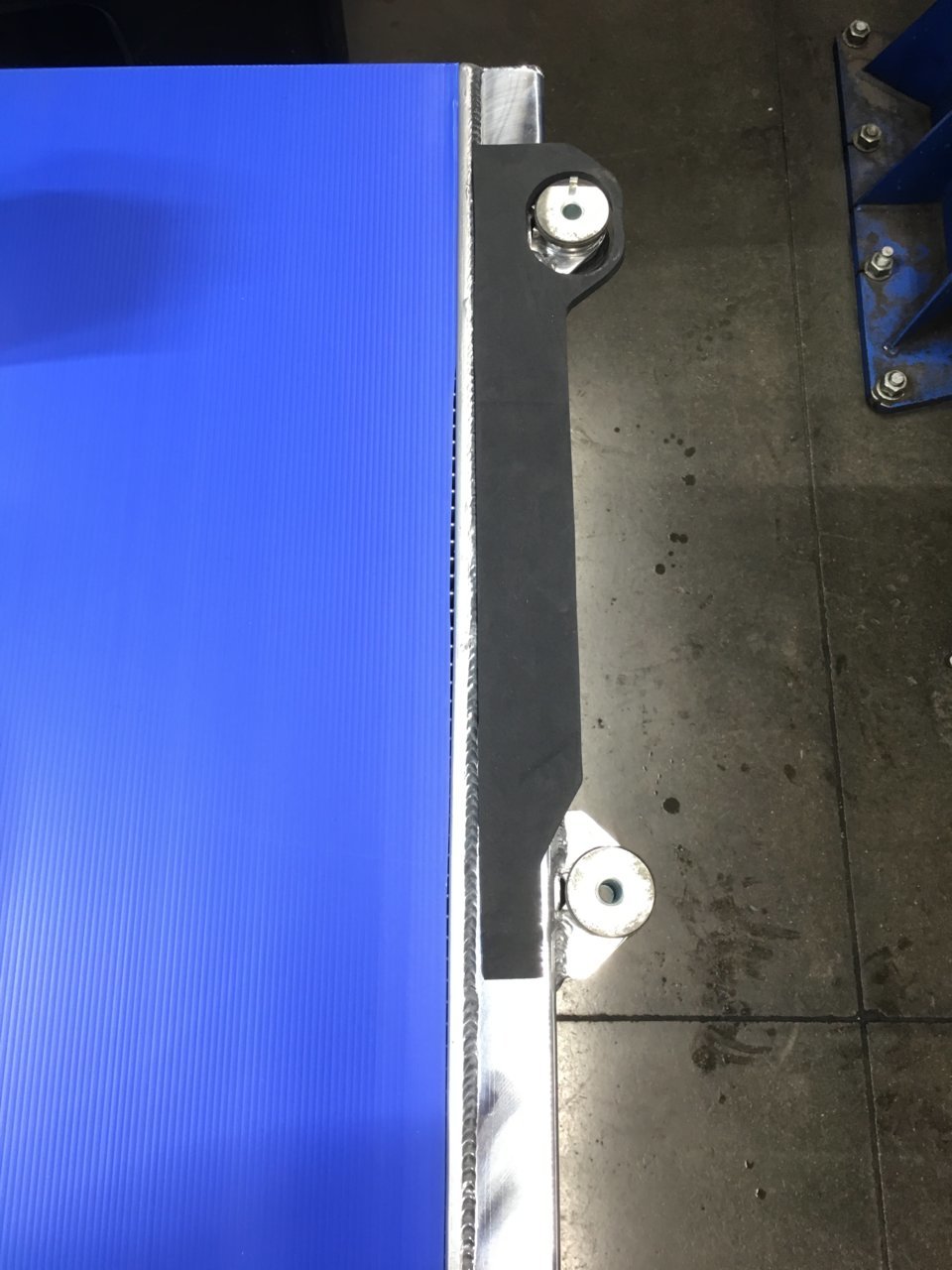

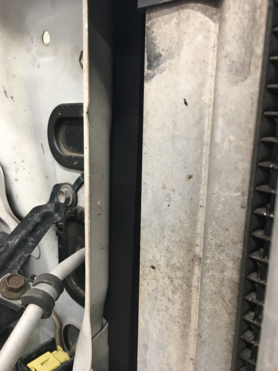

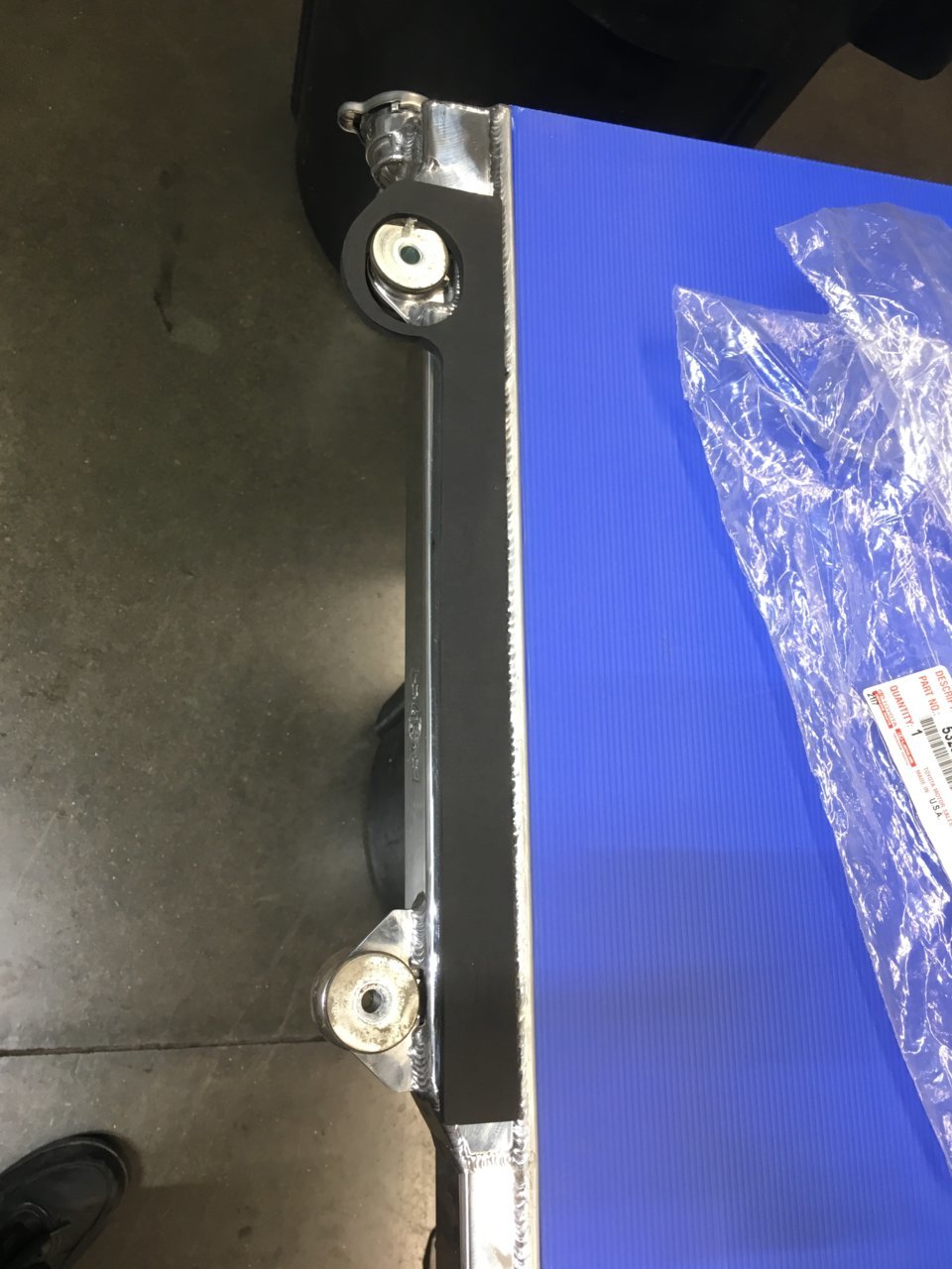

    Fancy radiator went into my truck tonight. The TSB/Mexico spec side seals worked very well to seal up the gaps. The bottom seal needed some trimming since this radiator is significantly longer than the stock radiator. No pic of the lower seal. I was under a bit of a time crunch to get the truck out of the shop.
