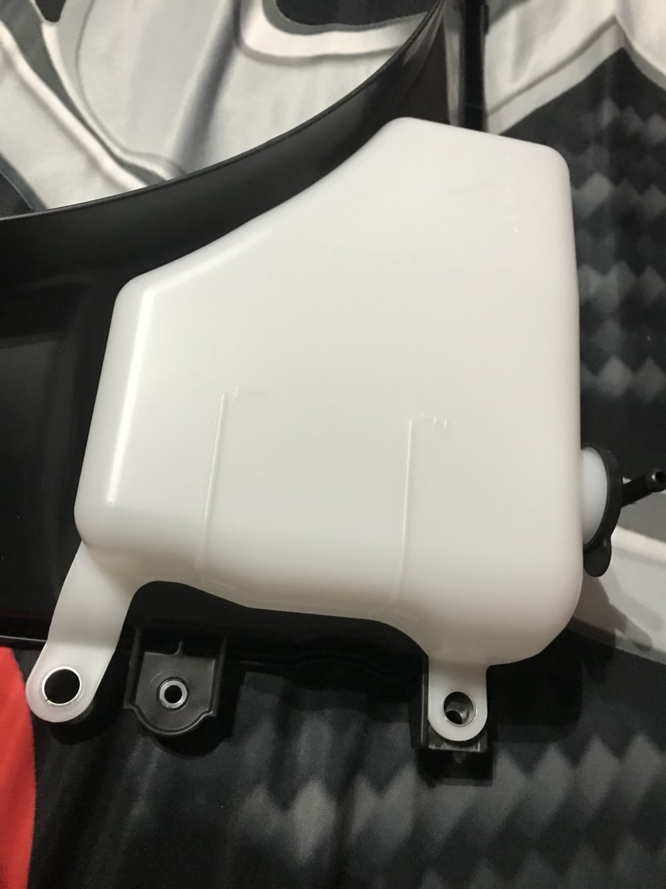

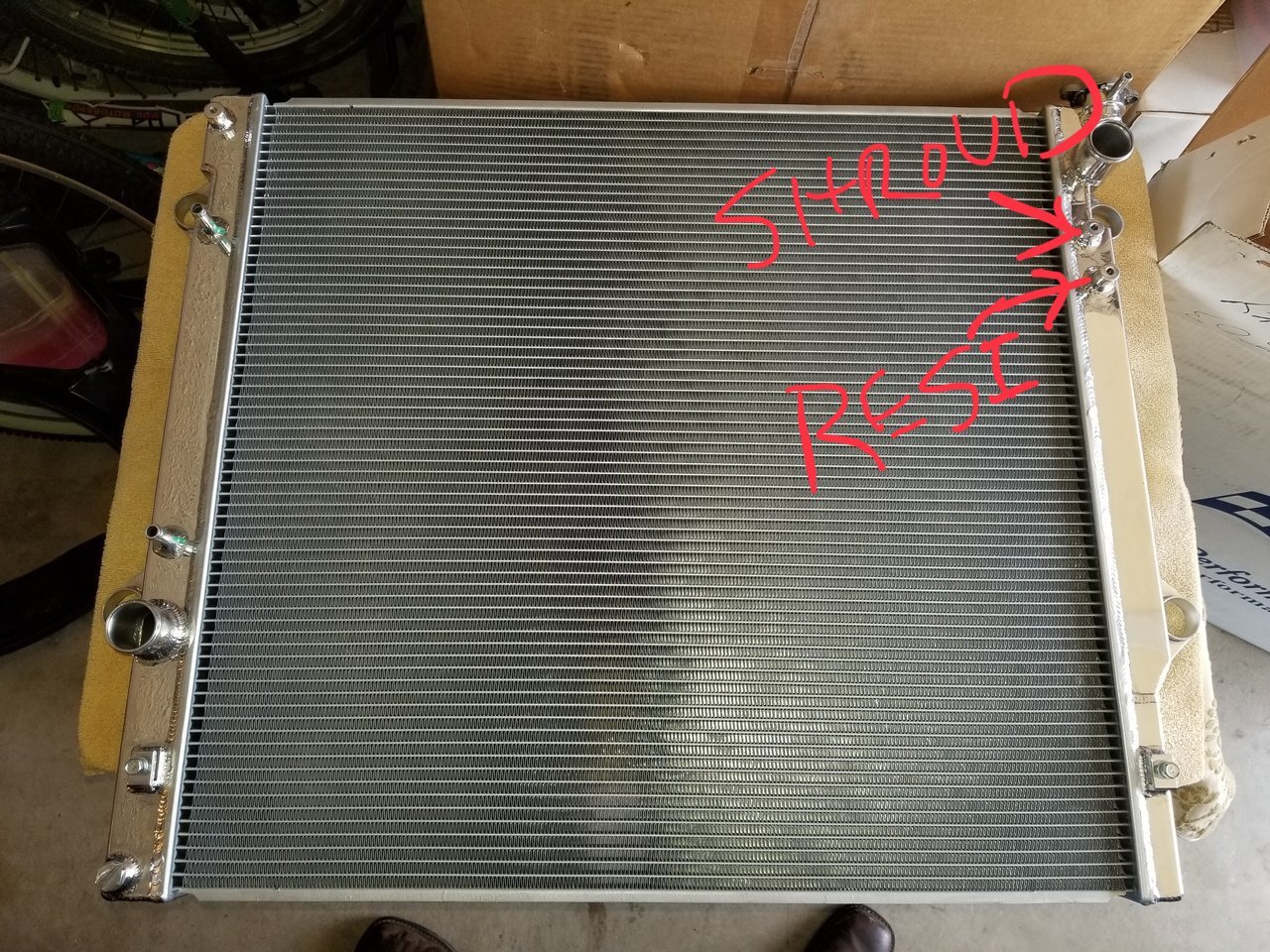

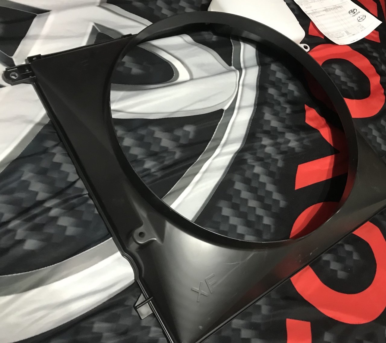

    I’m on my way to a bigger radiator as well!!.... only one concern though? Are all three brackets supposed to line up? Did I get the wrong part(s)? I got the nicer ones from the 2010+ FJ

    You would think they are suppose to line up, but maybe not. Those are the correct part numbers though.

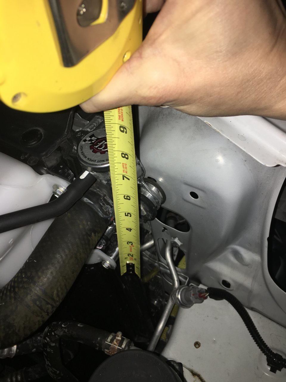

    On my resi those bolts are 6 inches on center or so (hard to tell with the hose in the way).... go measure yours.....if so, I bet they sent the wrong shroud

    If I’m remembering correctly, the lower hole on the reservoir connects to the radiator, not the shroud. I think you have the correct part.

    Lol.....that made me look at my pic above and I can’t tell cuz of the measuring tape......I didn’t pay attention to what was what other than trying to get the tape lined up for that pic lol. I’ll check first thing in the morning. My hood is still open
    Edit, actually yeah you can tell in my pic, you can see the stainless stem and how the lower part of the resi screws into it.....I’ll double check tomorrow though.
