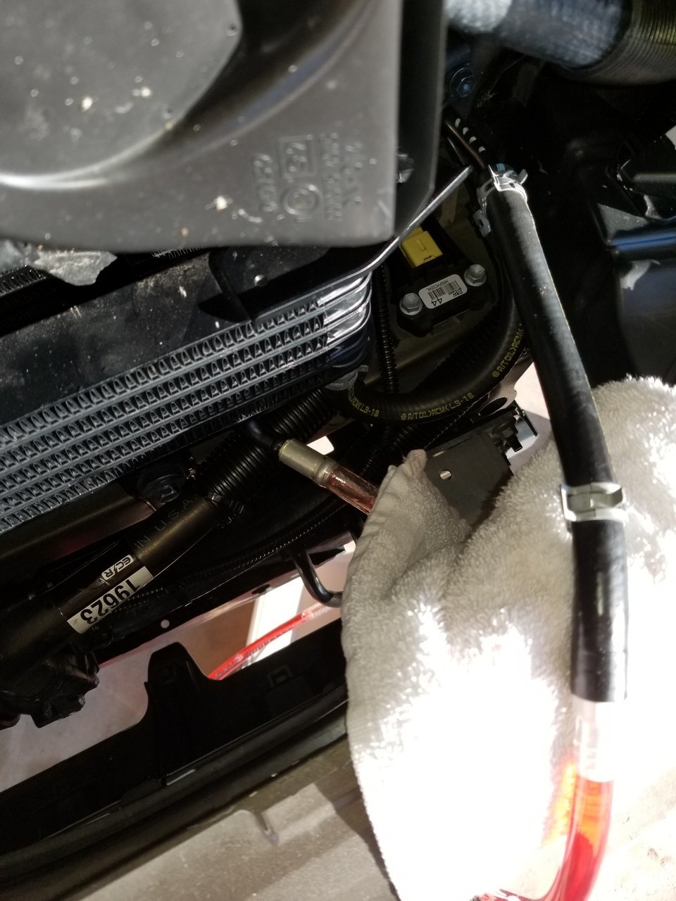

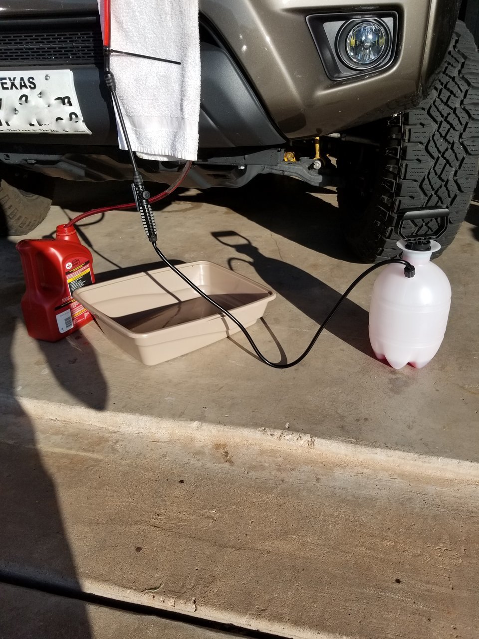

    There is not much tranny fluid in that little cooler. The new radiator probably holds a similar amount. I am not certain but I think the cooler is of the tube and fin style. Regardless it only holds a few ounces. What I did is used a brand new cheap hose sprayer, filled it with a little tranny fluid, and pumped it into the external transmission cooler line. When everything is hooked back up on the truck do you trans fluid check and let the excess drain out. Done! I'll see if I have a pic of my hose sprayer setup.

    Not the best pics but its just a $5.00 sprayer from WallyWorld. Remove nozzle and attach some clear tubing, connect to the line going from the radiator "out" to the external cooler "in". If you have a decent size syringe you could just fill like 8oz, pump it in there and call it a day.
