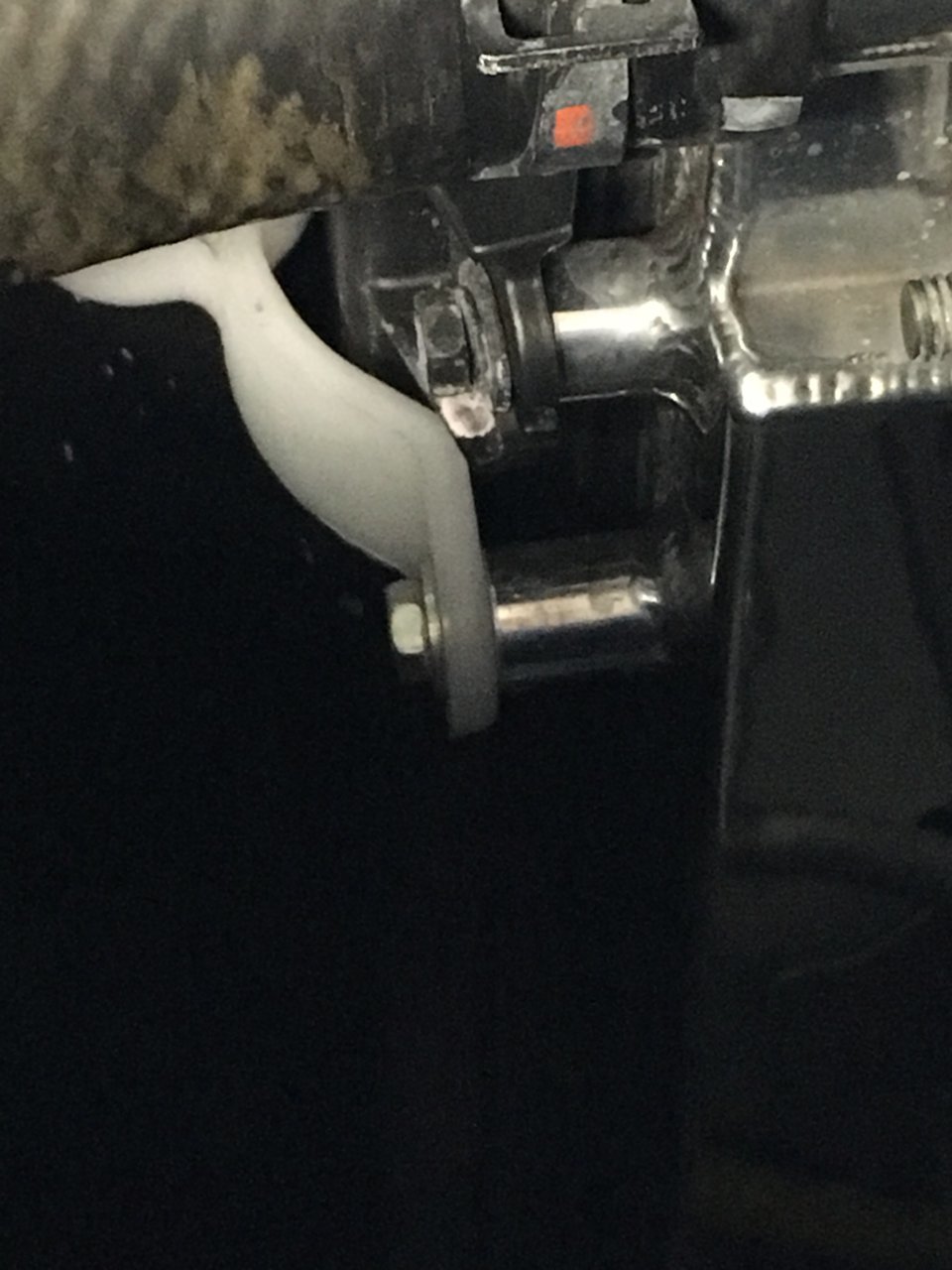

    @WorldWar546 just wanted to confirm for ya ....the lower resi does mount into the radiator.

    You are the man!! Thank you!!
