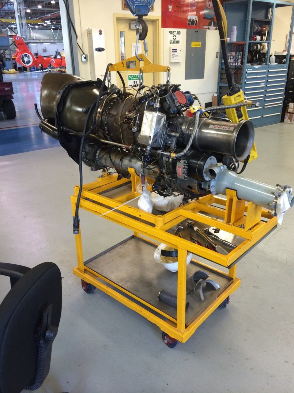

    lol believe it or not, when the turbine is installed on the helo, certain inspection require some spiderman skills, and that intake tube is placed right where id love to step. Common sense isn't so common LMAO

    ol its wierd. I can tear apart the helo, and fix everything down to composite and metal repairs, track and balance and even turbine engine swaps. But sometimes i doubt myself when i work on my daily driver.Not sure why. Maybe because uncle same pays for the helo parts. I have to pay for mine hahahah

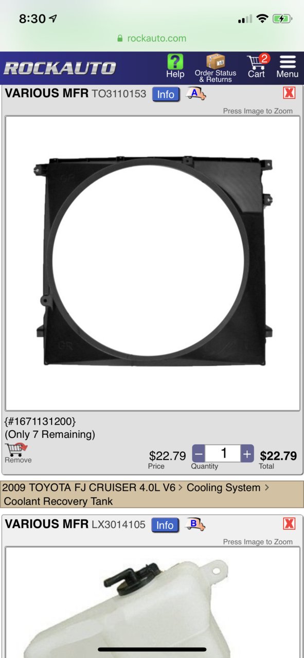

    That’s awesome! What’s your setup? What thermostat and did you do the fj shroud or modify the factory one?

    Anyone order the fj shroud and resevoir from rock auto? Want to make sure these would work before I pull the trigger

    I went with this and the FJ shroud and resi on my turbo build, paired with Evan’s Waterless Coolant & a 180 thermostat and I run 186-191 degrees. My temps actually DECREASE when I rev high and get into boost!

    I think I went with parts from Advance Auto online due to shipping costs at the time of sale but whatever Rockauto says will fit a FJ will work :thumbsup:

    Get these parts too and you'll be gtg :thumbsup:
    Reservoir Hose
    16567-31010
    Clips (2)
    90179-06185
    Bolt (5)
    91631-B0616
    Radiator Top Bushing (2)
    16547-0P110
    Radiator Bottom Bushing (2)
    16548-0P110
    I also went with the HPS silicone hoses and these clips (4)
    90467-37005
    Put these ^ on and pull the clips... watch out! lol

    Thanks for that man! Question, if i go with the 2010+ Fj shroud part number 16711-31510 and reservoir tank PN 16470-31130, do i still need all the other stuff like the bushings bolts and clips?

    I reused my bushing bolts.
    I’m not sure about the difference in FJ shrouds.
    You definitely need the clips and bolts I listed

    So finally done installing. After almost a gallon and half of fluid, and a sore back, she’s holding at 177 degrees at idle with ac on blast, and 181-183 driving temp. Still need to burp the system one more time so maybe the temps will get a bit lower.

    What’s the difference between the shrouds?

    What do you mean between shrouds?

    one fits, the other doesn't?
