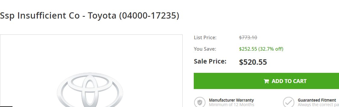

    Could order the TSB parts kit for a cool $520......

    Won’t work with supercharger intercooler :pout:
