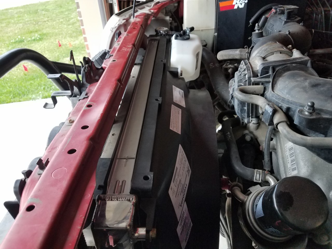

    Did anyone have issues with the bushings on the radiator? The ones in the ring..

    One of the rings on the new radiator was slightly bent on mine so it was more like an oval. I had to "persuade" it back to being round again. Other than that, no issues.

    One of mine was too, I forgot to mention that. The bushing did pop right in though, no problem

    Installed. Did not have to bend lines but did have to remove fan to make shroud fit.
