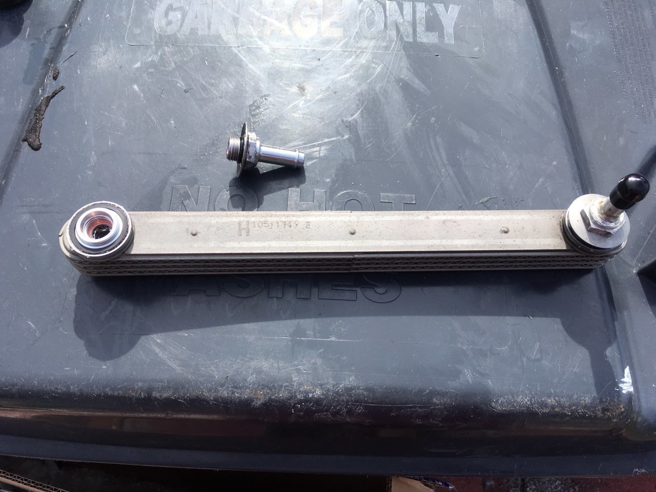

    I removed a gen 2 transmission cooler from the inside of a stock radiator. I agree 1-2 ounces of fluid at most.

    The new cooler is larger than the OEM one.

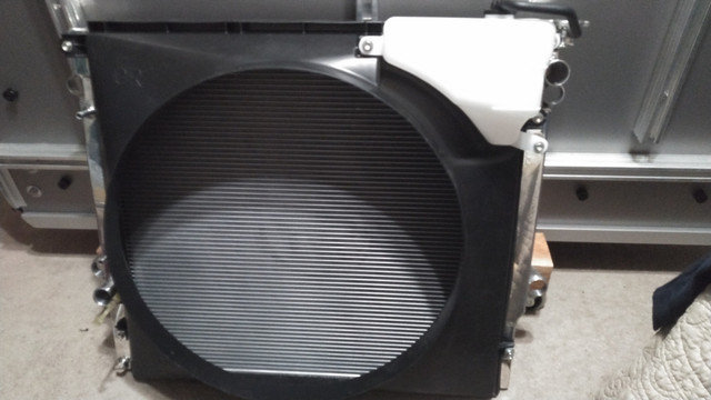

    Finally installing it since I was on the first list and it's sat in storage for a bit.. Pulled the factory radiator shroud and fan so just going to drain it and swap it out tomorrow along with new hoses. Sealed the new FJ shroud to the radiator using oem shroud and parts. Wondering if I should install my 160 T-stat since I am NA but I do live in the far South and tend to use this truck in the desert? Any way few pics glad I went with the FJ set up since it's bigger just makes sense if you are going to swap it for better performance...
    Bottom of the radiator used gasket sealer since the gap was small, sides and top used the rubber bulb sealer to seal it off.

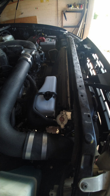

    Got her installed today super easy! I do need to modify my transmission lines since they are routed different due to my front bumper also need to fab up some type of side guards as well since the corners of the radiator are being exposed more because it sits lower. But looking forward to a cool running truck the factory radiator looks really sad compared to the CSF.
