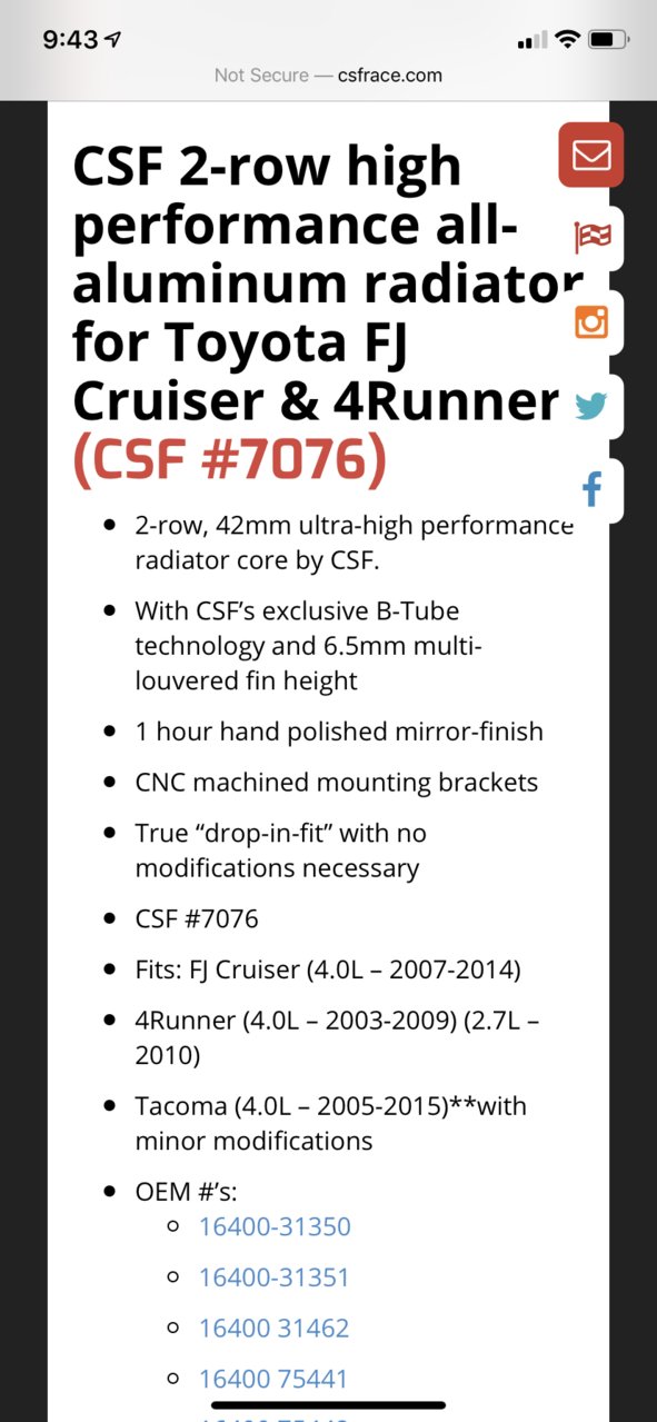

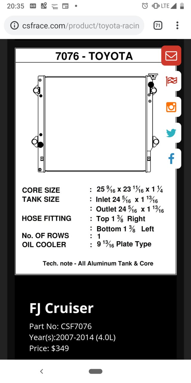

    I was going off of this... But I also saw an ad saying 2 row

    It’s a two row. I can take a pic tomorrow. I’m not sure why that spec sheet is goofed up though since the rest of their product page clearly states it’s a two row.
    As an owner I can tell you it’s a two row for sure.

    Yeah, I definitely read both when reading. I trust its a two row

    So when I went to the CSF website I saw that that FJ 7076 radiator is listed as having 1-row in some places and 2-row in others. I sent an email to CSF to clarify this and to ask about how it compared with the upcoming Tacoma-specific 7082. The 7082 is 3/8" thicker and 1-11/16" shorter than the 7076. Here's what they said:
    "Sorry for the delay in response. We were completing the final test fitment on our new Tacoma radiator and we just completed it today.
    The FJ Cruiser radiator - CSF #7076 - is a 1-row 31mm core with CSF’s B-tube technology.
    - we’ve fixed the discription and dimensions on the website.
    The new Tacoma Radiator - CSF #7082 - is a 2-row 42mm core with B-tube.
    Both are upgrades over the OEM units, the 2-row 42mm Core would be the best performance, and would be a drop-in fit for your vehicle. I suggest you go with this new model.
    - it will be available next week for sale once our dealers get stock.
    please let us know if you need a referral to a dealer to purchase or if you have any other questions.

    TL;DR the Tacoma-specific 7082 sounds like it's the way to go....especially if you don't want to modify your existing shroud to fit the FJ radiator or buy the FJ shroud/tank.
