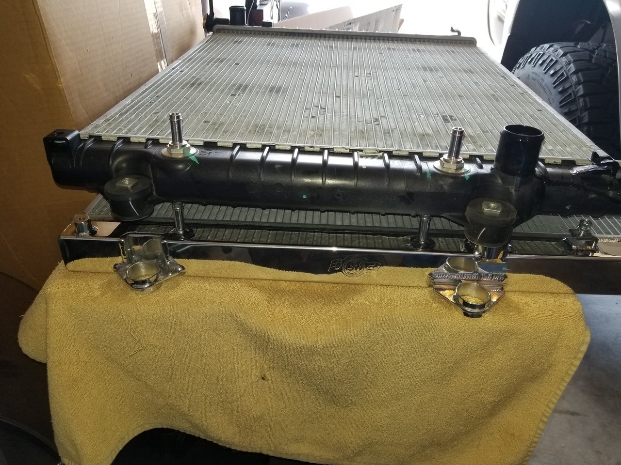

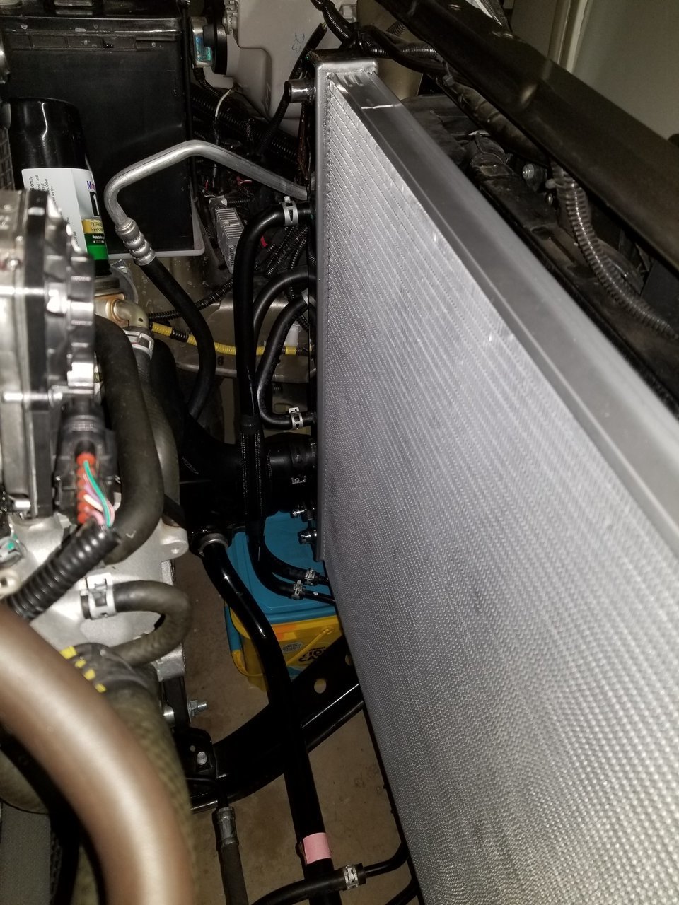

    I did, bolted right up with new 2.7 rubber mount things
    My mount hole looked like this but rubber squeezed right in so I didn't sweat it
