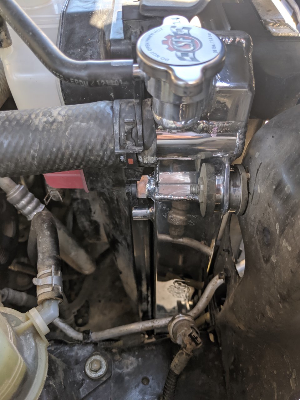

    Took some measurements since I still have my old rad sitting on the garage floor.
    The mounting point for the fan shroud is 1/2 closer to the engine than it is on the OEM radiator

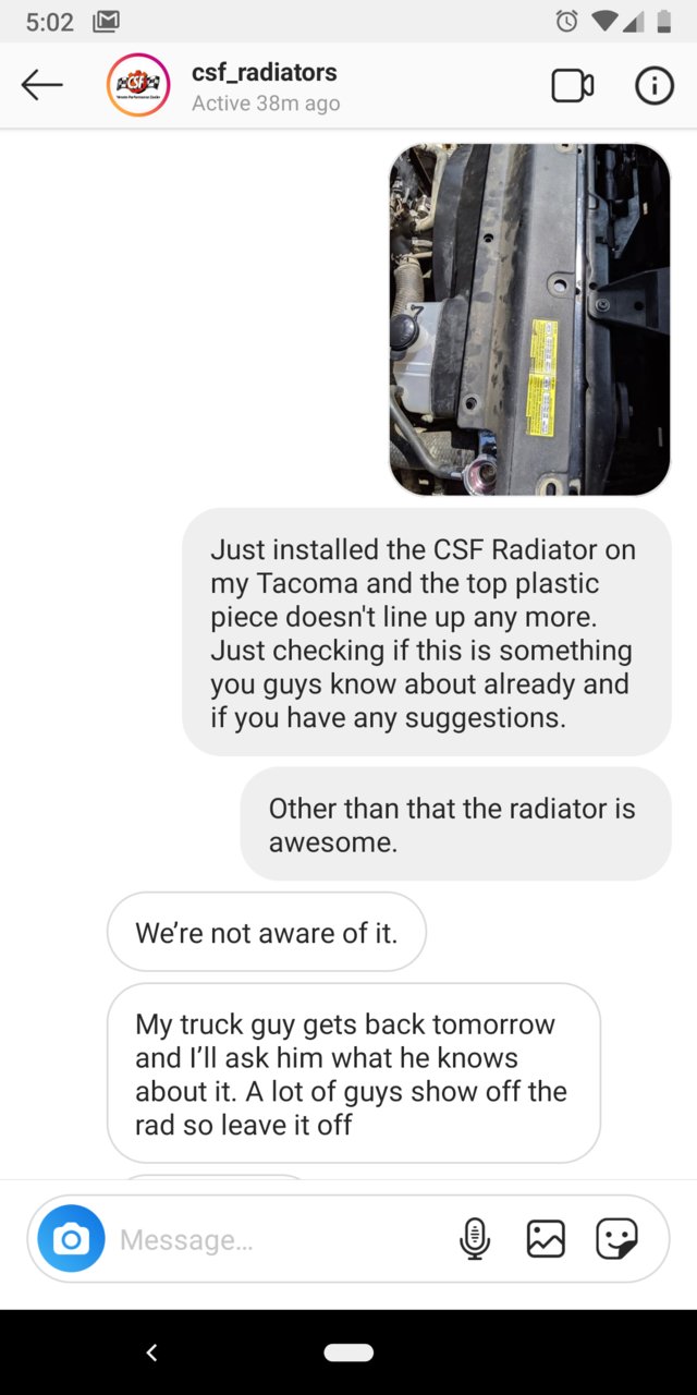

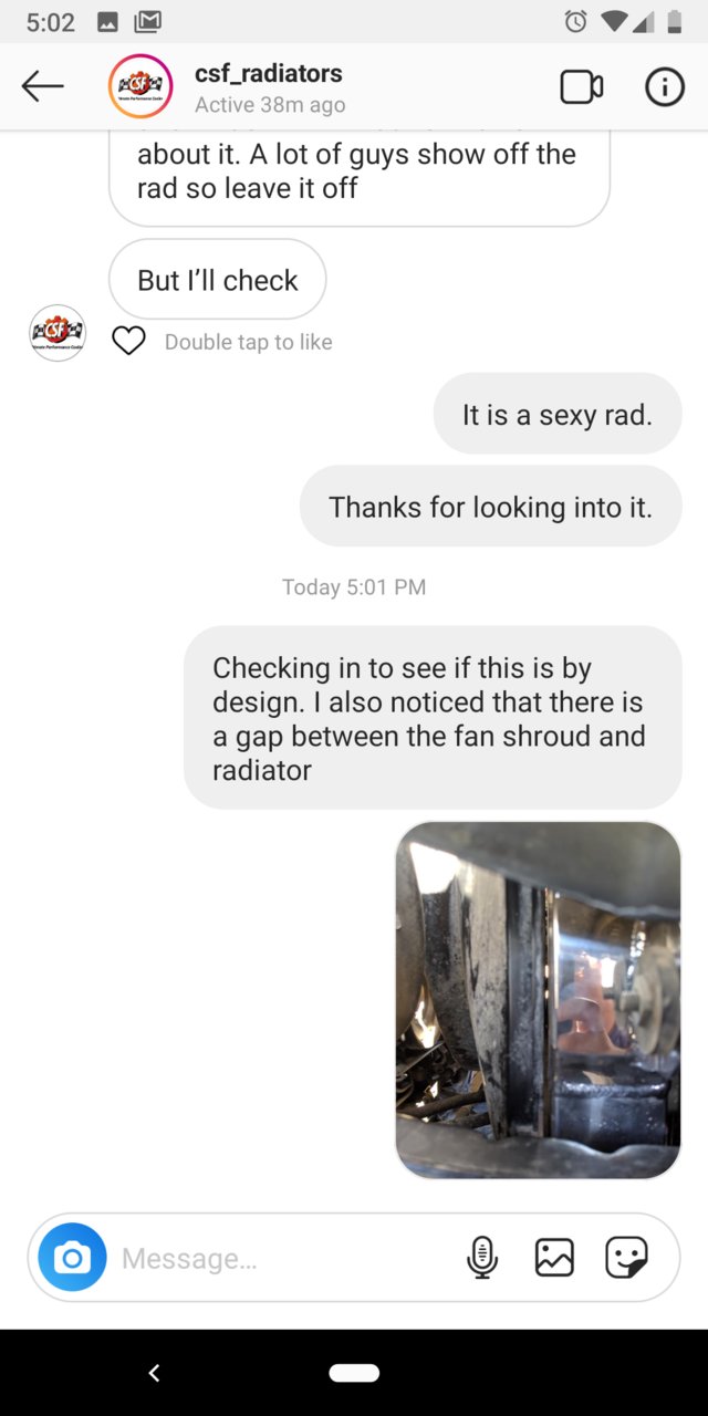

    Did CSF ever reply on the poor fitment issues of the upper radiator cooling panel (aka holes not lining up) when using the 7082?
    I saw from oni06's screenshots that CSF says "people leave it off to show off the radiator" but it does appear to have more function than just appearance as it forces air through the radiator vs over it and into the engine bay. Thanks.

    I also emailed a contact that I had at CSF about the top plate and never heard back. Shame. Seems like we will need to take it into our own hands to make it fit either with zip ties in the back or re drilling the front.
    Also, seems like we should take it into ourselves to seal around the shroud, while stationary or very low speed any gap around the fan housing will result in substantially reduced flow through the radiator itself. At speed it won’t matter of course, that is all velocity pressure from the front
