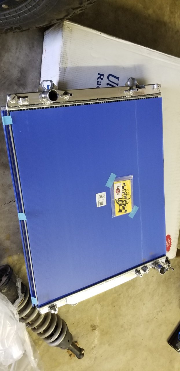

    CSF radiators, I has poor shipping contol. I have been reading a lot of stories of them being damaged during shipping! My radiator bushings were bent! The heck!!!!

    Ouch. Sorry to see that man. Some ingenuity could hopefully get that sorted back to normal. Maybe a little heat to prevent cracking?

    Great, I have yet to pull mine open yet. Better not be damaged.

    Looks like you better peak in that box.

    Damnit! So what have folks done? I assume this isn’t really fixable. I was going to install it today too funny enough
