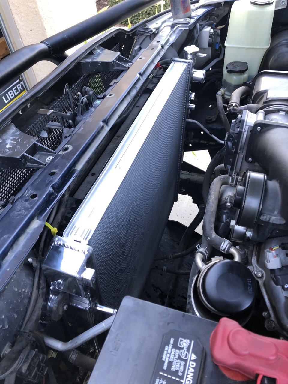

    Yah it wouldn’t be too bad if you had it new and empty. Going to wrap it up as is and order some sealant. It’s sold out on that link so need to track some down.
    No issues with the bottom at all. If the mounts were a hair shorter it would lay flat all around. I managed to get the top on. I had to re align it 6-7 times but came out not too bad minus the side gaps.
    P.S. this thing take a gang of coolant. Having that engine and radiator to fill plus the S/C system and extra capacity if that CSF.

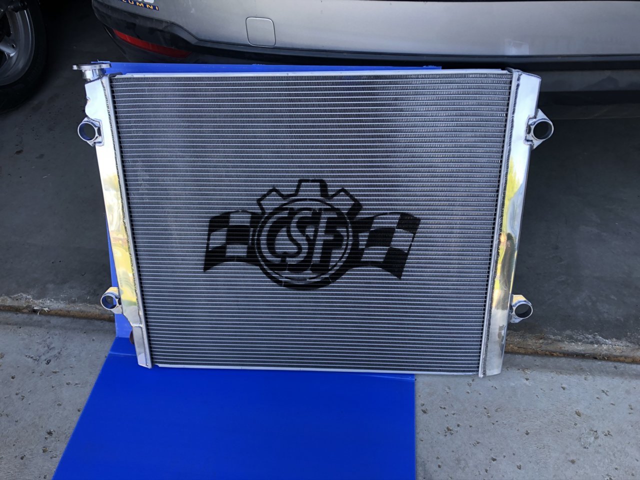

    Just like my CSF Subaru radiator, this thing is beefy. Bent a few of the fins on the bottom while putting the fan back in unfortunately, but won't affect things or leak. I wish there was a foam gasket for the plastic OEM shroud to make a better seal, but I don't see any big issues.
