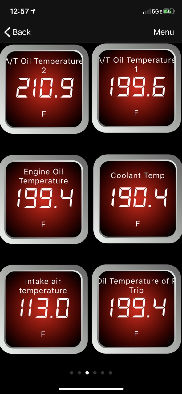

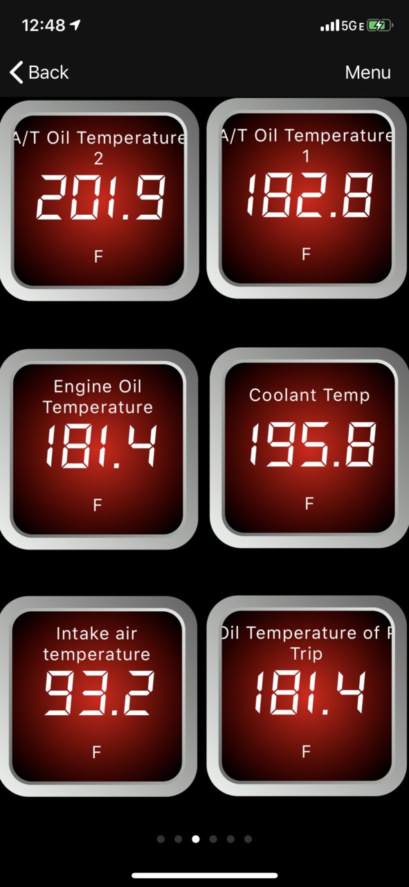

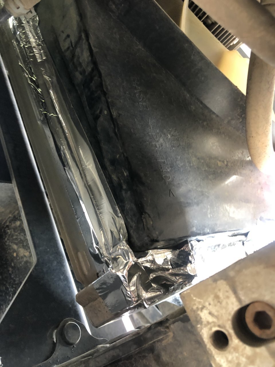

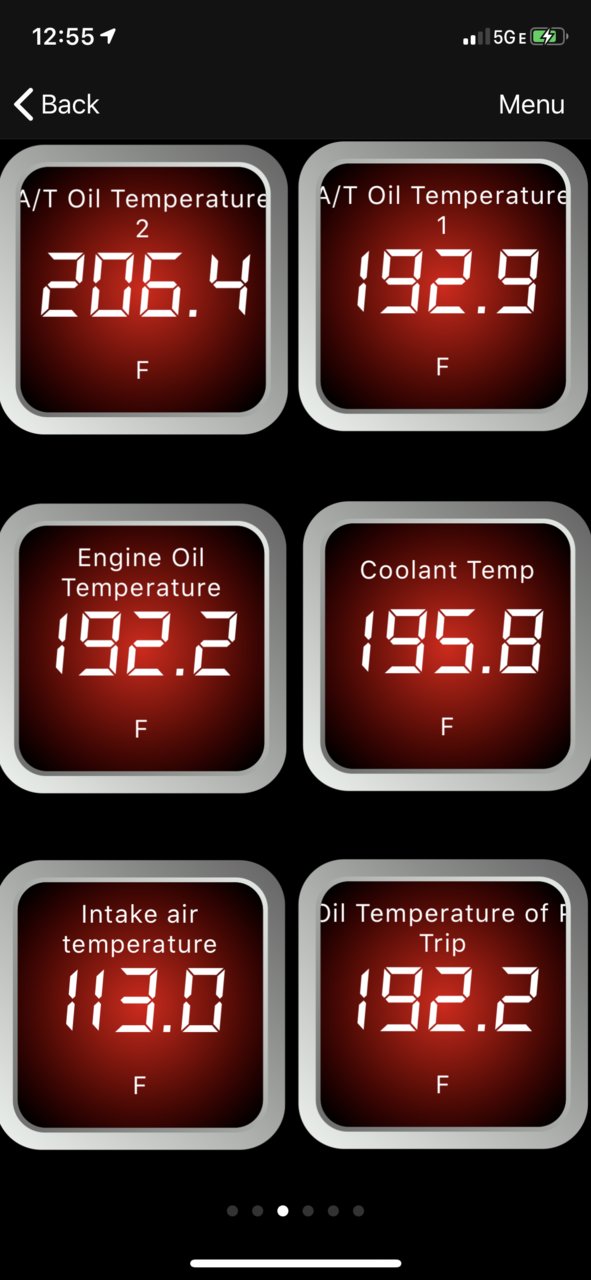

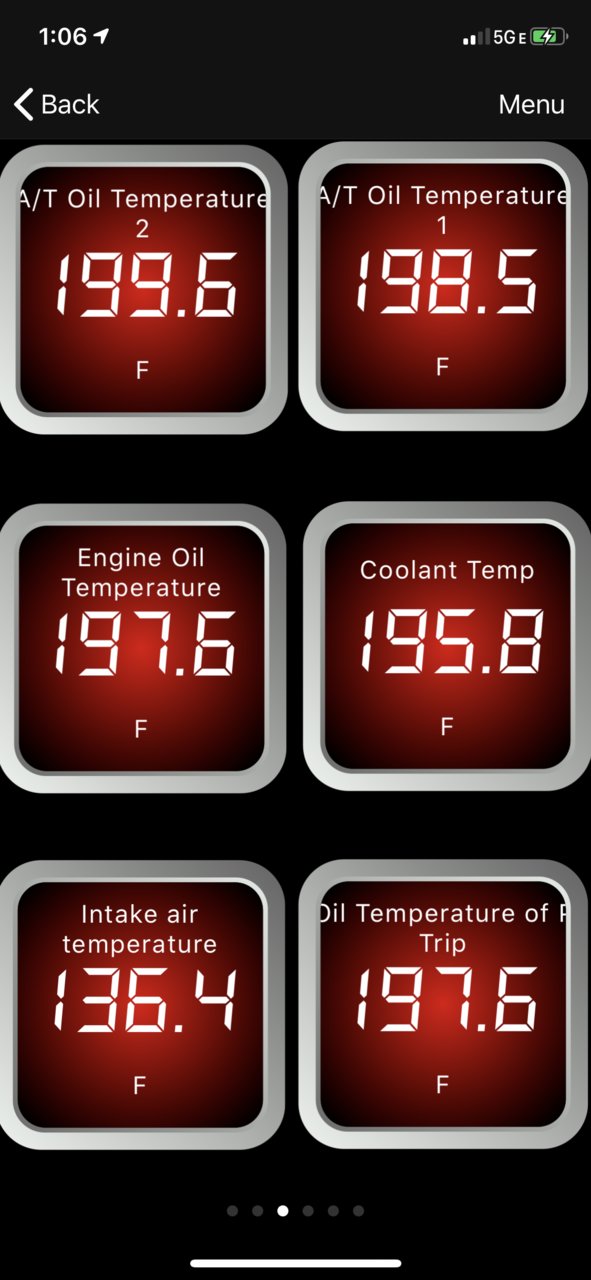

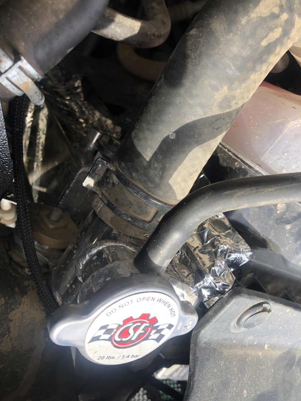

    Ordered some new seals for the shroud but was impatient and found some HVAC tape in the toolbox. Ran it all around So at least it keeps the air flowing. This stuff should be air right once it seals. I figure if the radiator stays under 200 most of the time should be ok for the test has a temp rating if 200 or 345. I forgot which one this was. A bigger AT cooler is still a good upgrade and I’m sure with how hot it’s running and age of trans fluid a fluid change will help. goal is to do that and valve body job at the same time which makes sense. Need to see which AT cooler setup will work for me.
    85B6BE4D-4095-4A49-8780-FF4AE9983DB6.jpg 65E58E8D-FDBF-47C2-B445-3080AB166D7B.jpg 1D8CA205-8AB1-4A27-BDC8-B2EC7B4921BA.jpg
    5-10 min of basic driving still wanting up.
    after a WOT throttle 10-15 min
    After a second WOT that was much longer and taxing
    Back at the house initial temps
    Let the truck idle in the driveway for 10 min or so to see if would get worse similar to the 240 I was getting at idle.
    henryp likes this.

    Those are pretty close to my numbers. I think you found your problem.

    That’s good to hear. My next question was going to be what are others Getting it where should I be searching. It would still benefit from a cool trans with a bigger cooler but way better than 240-250 I was seeing. CSF needs to either fix the figment or supply a seal and specifically tell you to add it. the GAO didn’t seem too bad but I guess it was enough to basically make the shroud useless

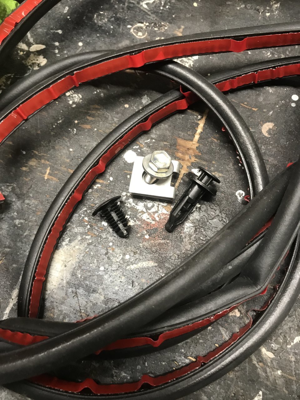

    Stuff to make it sealed. Just ask @nudavinci64 what happens when you don’t get a good shroud seal. There are several ways to do it. I used the rubber seal discussed on this thread.

    Shroud and overflow tank were the only things I bought then (based on a quick email search). I basically followed @Roostfactor ’s lead on this. I can’t remember if I used my old hose or the new one that came with the overflow tank. Also got the clips that @loginfailed quoted. Search those two usernames and you’ll get all the parts you need

    Here they are

    yah that seal is a game changer if you forget to do it. seal now! I just got a new seal I need to toss on, its a bit fatter and I may look into using some heat tape over it to make sure its tight. Basically whats on there now and its working fine now. At least from feedback im back into the better S/C heat ranges.
    I have the Tacoma version if it matters. Install was super easy. I did not have any issue getting the top on the top like others have. Its tight but doable. You need to play with the position of the radiator though to get it in a good spot.
