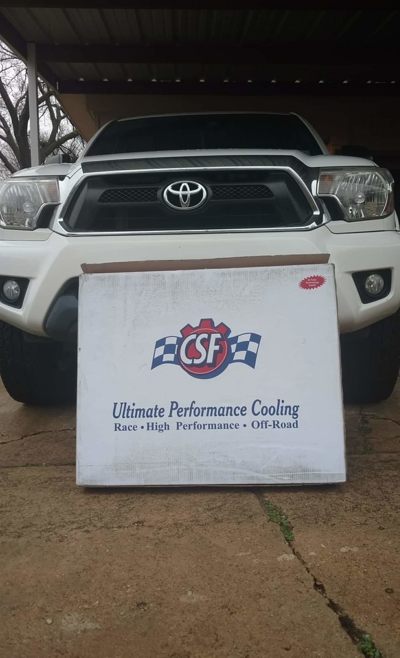

    Got one!

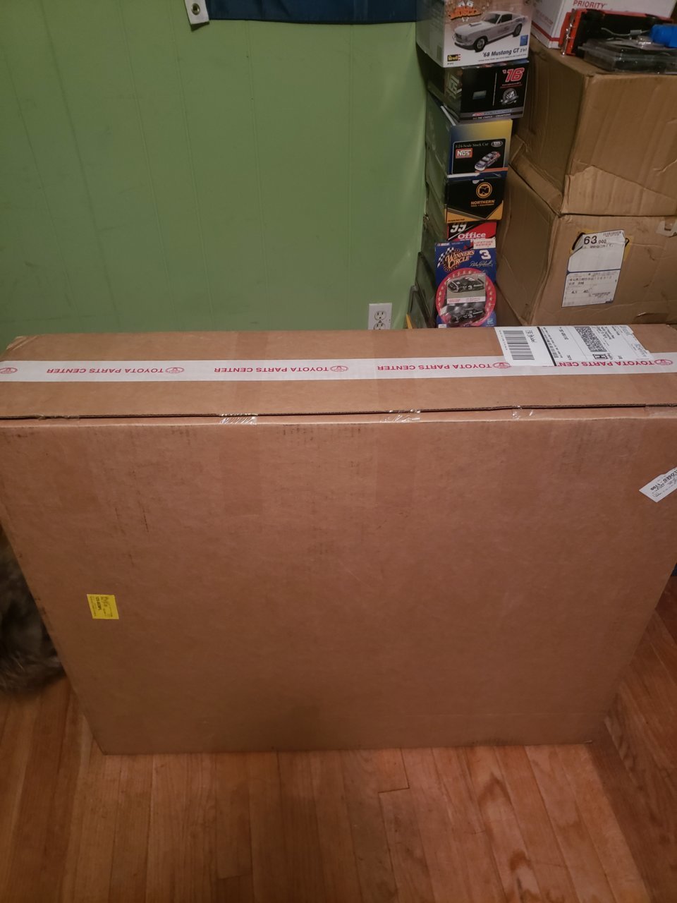

    Guess I should chime in. Ive been watching this thread for a bit now. Ive had the radiator 2 years already. Didnt realize i was dragging my heels that much. Finally ordered the parts last week. New oem fan shroud and coolant tank from a 2010+ fj
