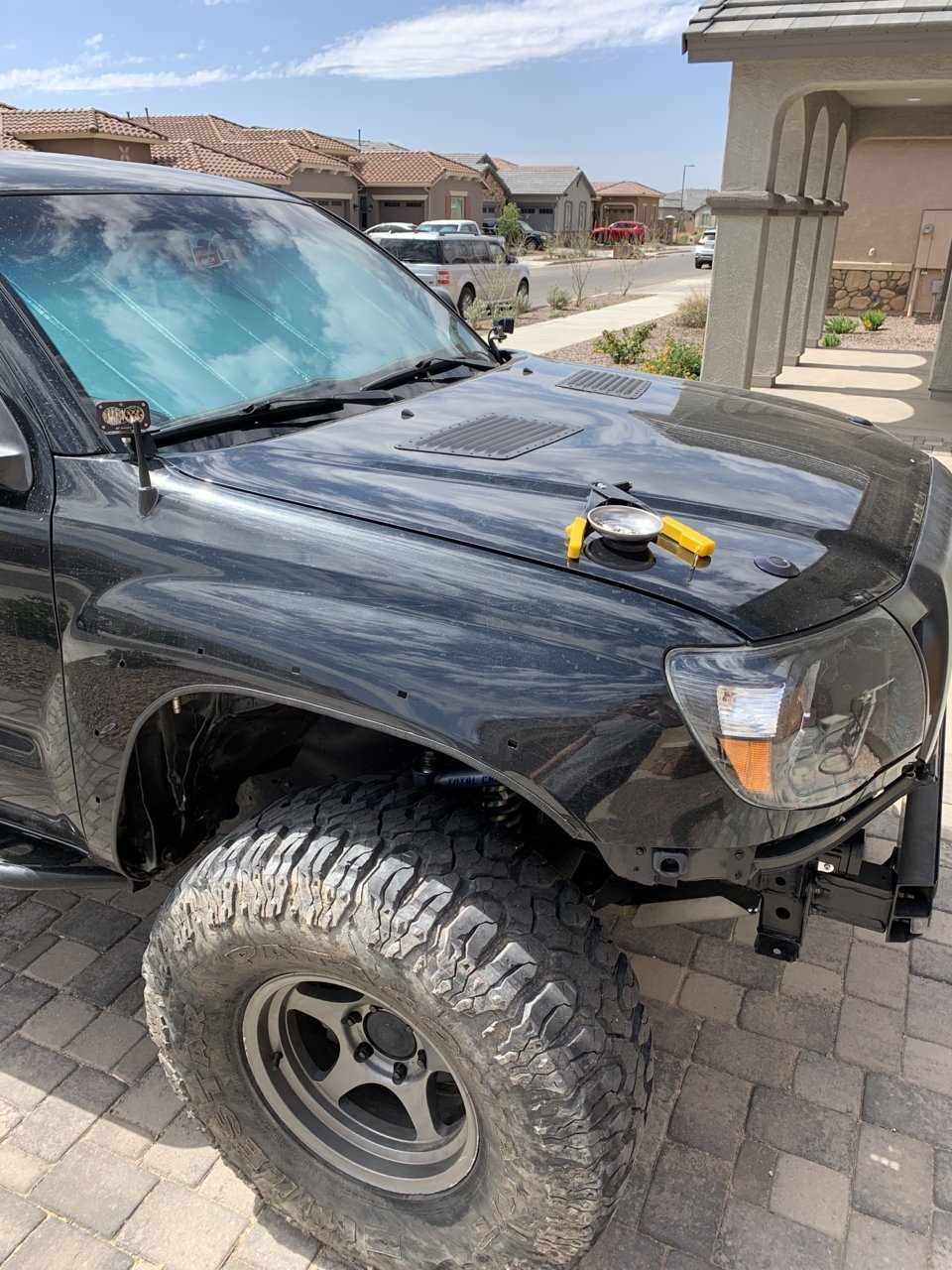

    Temps are well controlled 99% of the time. But I still tend to overheat when crawling. I attribute this to the slower circulating coolant of idle rpms. Options are:
    to turn the fan controller down even more but I'm down two turns past as far as I'm supposed to go on the potentiometer.
    Add a second temp sensor- theoretically modifying resistance so I could then be back in the middle ground of the potentiometer.
    Or cut holes in the hood- tastefully and mostly over the headers like so. (These are the louvers I purchased but not my truck)

    White hot thermal image at the bottom.
    Initial observations- temps seem to drop faster,
    Cab noise at highway speeds is noticeably down!?!?
    Mirage visible outta vents when stopped.

    Nice, finally someone did it right!! I always cringe when I see the crude cuts through the hood skeleton

    Where did you get the hood vents?

    Well done man. :thumbsup: If you're seeing the mirage effects, it is definitely venting some good heat.

    Ordered last night. Cuz I’ma copy cat, lol. Thanks though

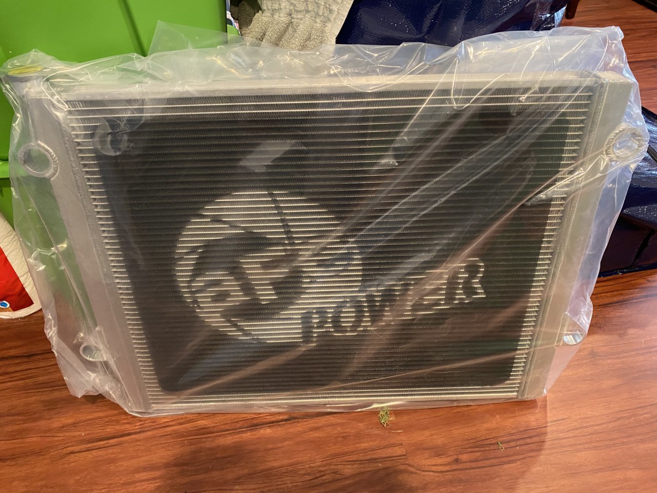

    I just bought one. AFE is having a 22% off sale that ends tomorrow. $381 shipped
  12. Apr 28, 2021 at 6:08 PM
    #1912
    fatfurious2
    Jun 28, 2014
    #132884
    49,776
    David
    Ashburn, VA
    2010 TRD OR Access Cab
    Got it today. Ill get some pictures tomorrow. Looks beefy!
