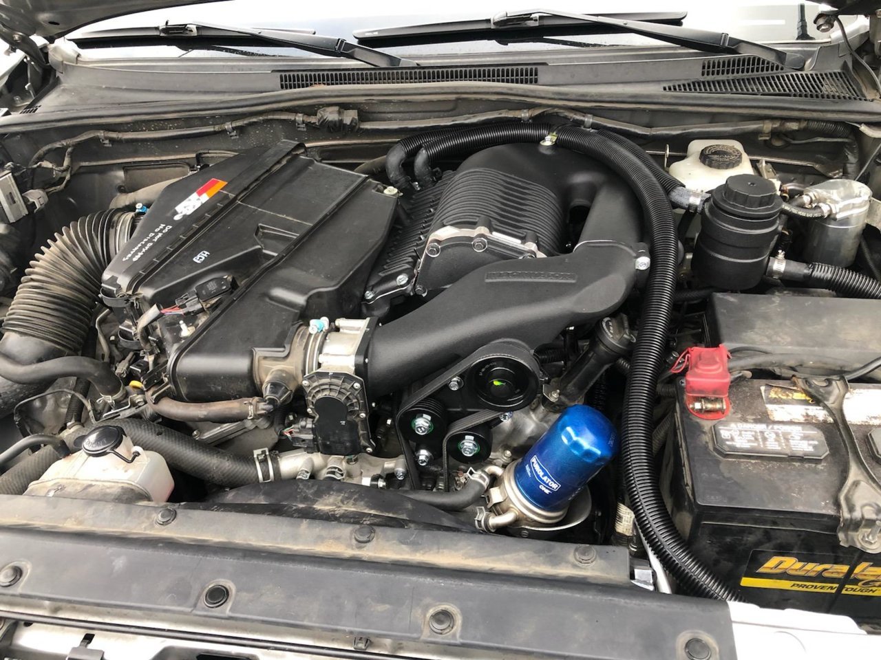

    finally got everything done! new rad is in with the supercharger... should help keep things cool.

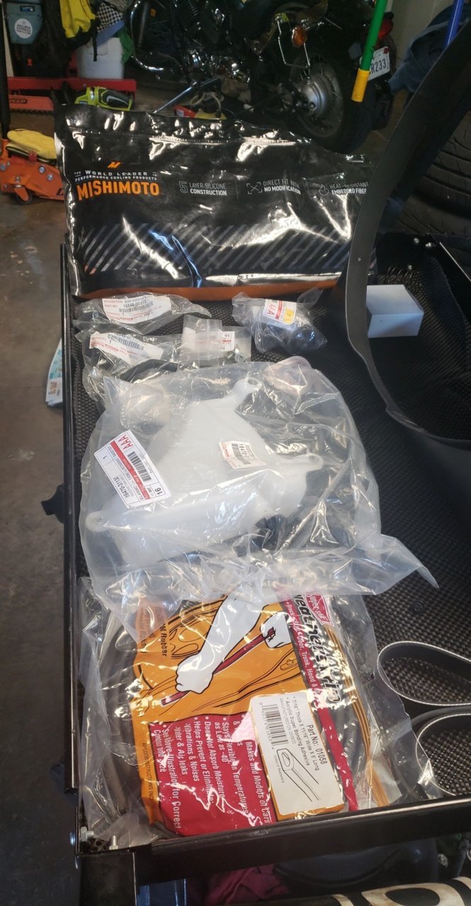

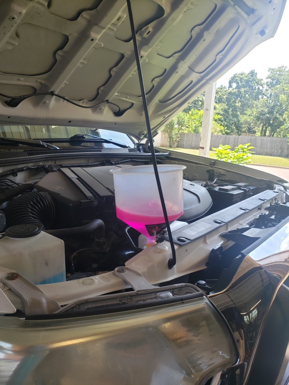

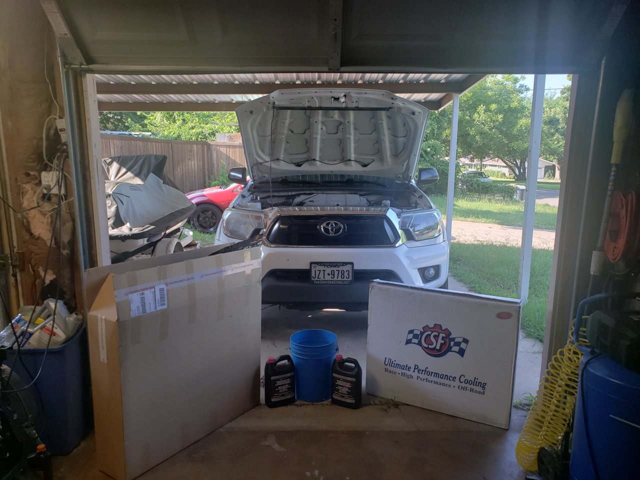

    Install day for me. It wasnt super hard overall. Drained the passenger side of the block as well. The driver side drain just wasn't having it so I left it alone. I think I need to rebleed the system. Im seeing alot of temperature fluctuations sitting at lights. I also need an after picture.20210708_091255.jpg USER_SCOPED_TEMP_DATA_MSGR_PHOTO_FOR_UPLOAD_1625754196848_6818907330858206839.jpg 20210708_151718.jpg

    Still have air bubbles in the system?
