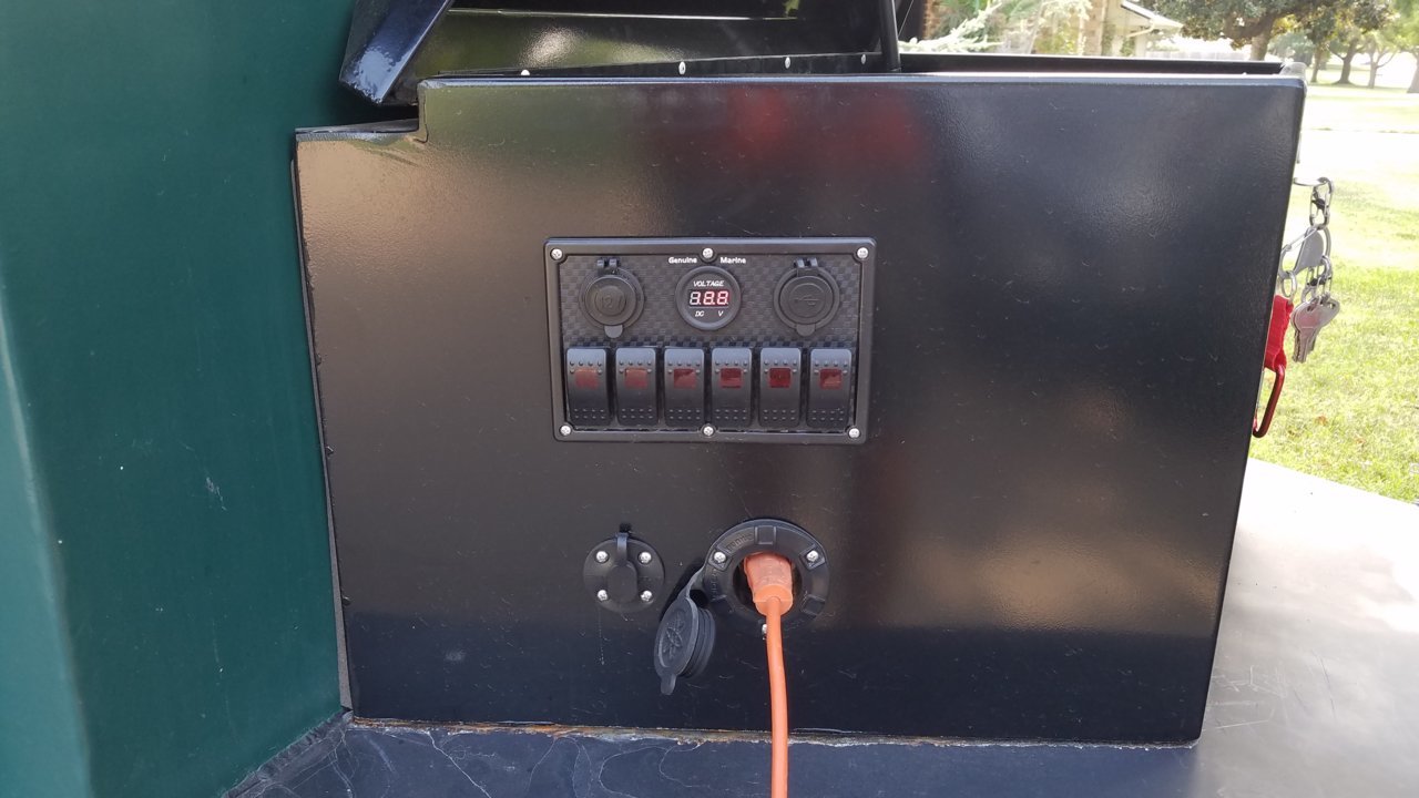

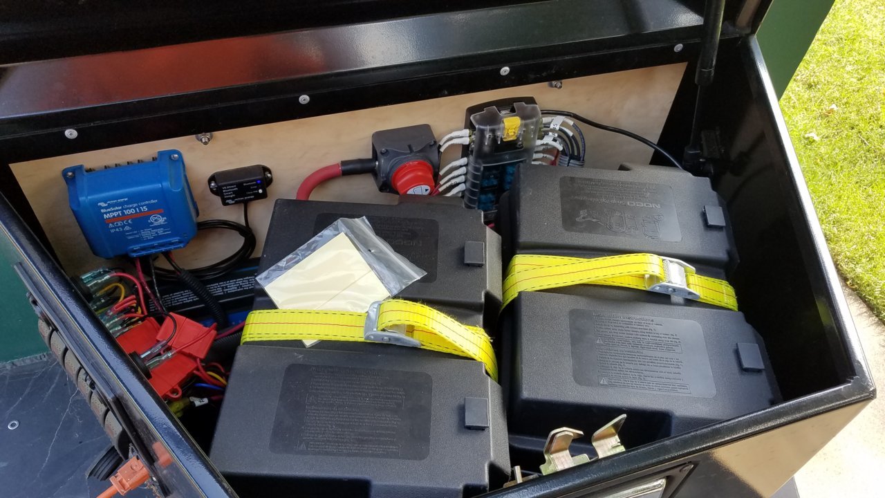

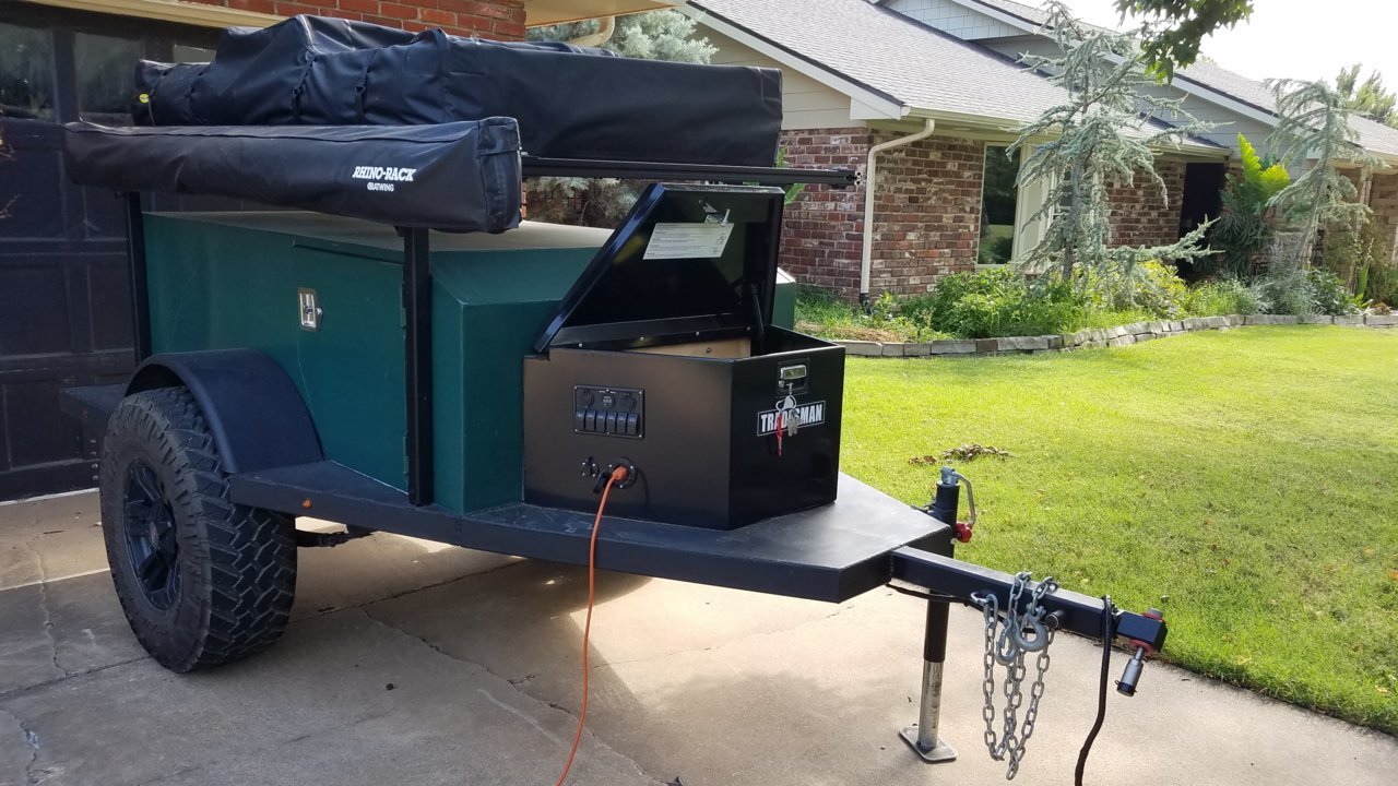

    I have one of these refrigerators and I've measured the power draw at roughly 1.0 amps/hour.
    That means you'd need approximately 72 amp hours AVAILABLE to power the fridge for a long (3 day) weekend without recharging. (note: in order for your battery to last longer than a few short years you shouldn't draw it down to less than 50% of it's capacity, unless it's lithium, then it's a different story)
    A 12v flooded deep cycle golf cart battery is probably your best bet.
    Trojan makes a great 150 amp/hr battery for ~$200, which would net you the 72 amp hours needed for a 3 day weekend.
    Probably the best dollar/performance value are two 6v flooded golf cart batteries wired in series (12v). You can get roughly 230 amp hours (115 usable) for around $200. This is what I did in my system.
    Cheers.
    Pics of the electrical system on my trailer:

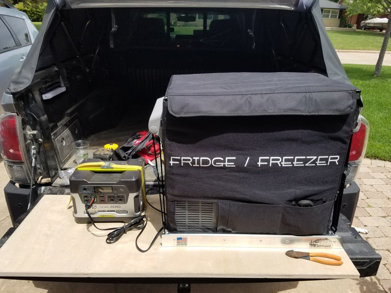

    Kind of similar to TW above, I will also mount mine on a platform in the bed of my truck when we go Boy Scout camping.
    It's powered by a Yeti 400 that charges off the bed outlet when driving.
    Cheers

    I'm using the DFG Offroad refrigerator slide that fits the fridge perfectly. I mounted the slide to a 2' x 4' piece of 3/4" plywood I cut to fit around the wheel well. At the back of the plywood (behind the fridge) I mounted my Goal Zero Yeti 400 to power fridge. This keeps the fridge from tipping when extended out on the slide and I can plug the Yeti into the inverter on the side of the bed. I have an oem rubber bed mat, and put bolts up through the bed mat and the plywood, then secured with wing nuts.
    Cheers
    Again, this is what I use for when we go Boy Scout camping. The rest of the time I use my trailer's battery system as noted above.
