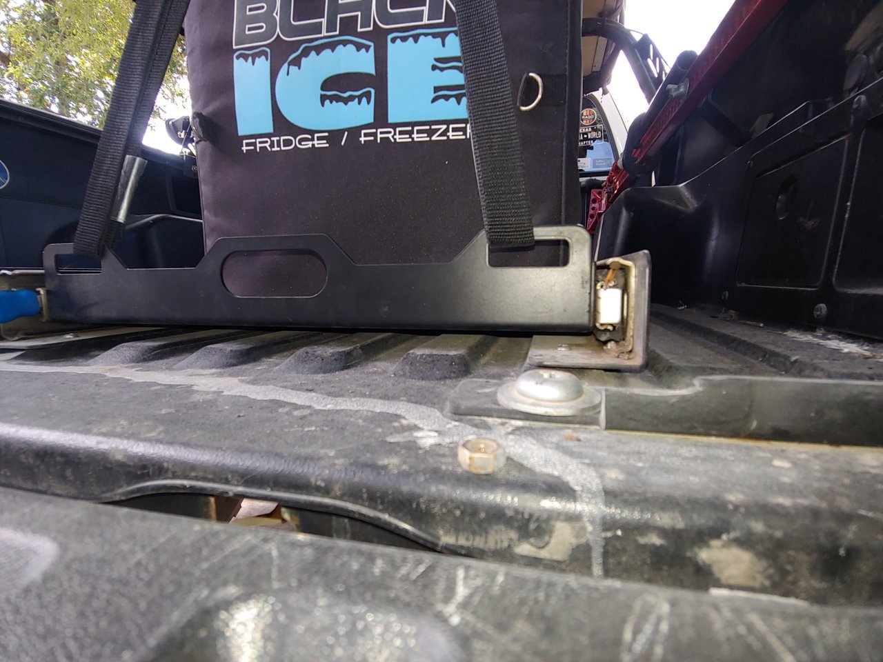

    I haven't done it yet but I was thinking about just putting a piece of wood underneath the slide to give it just a little extra height to get over the bed stiffener lip.

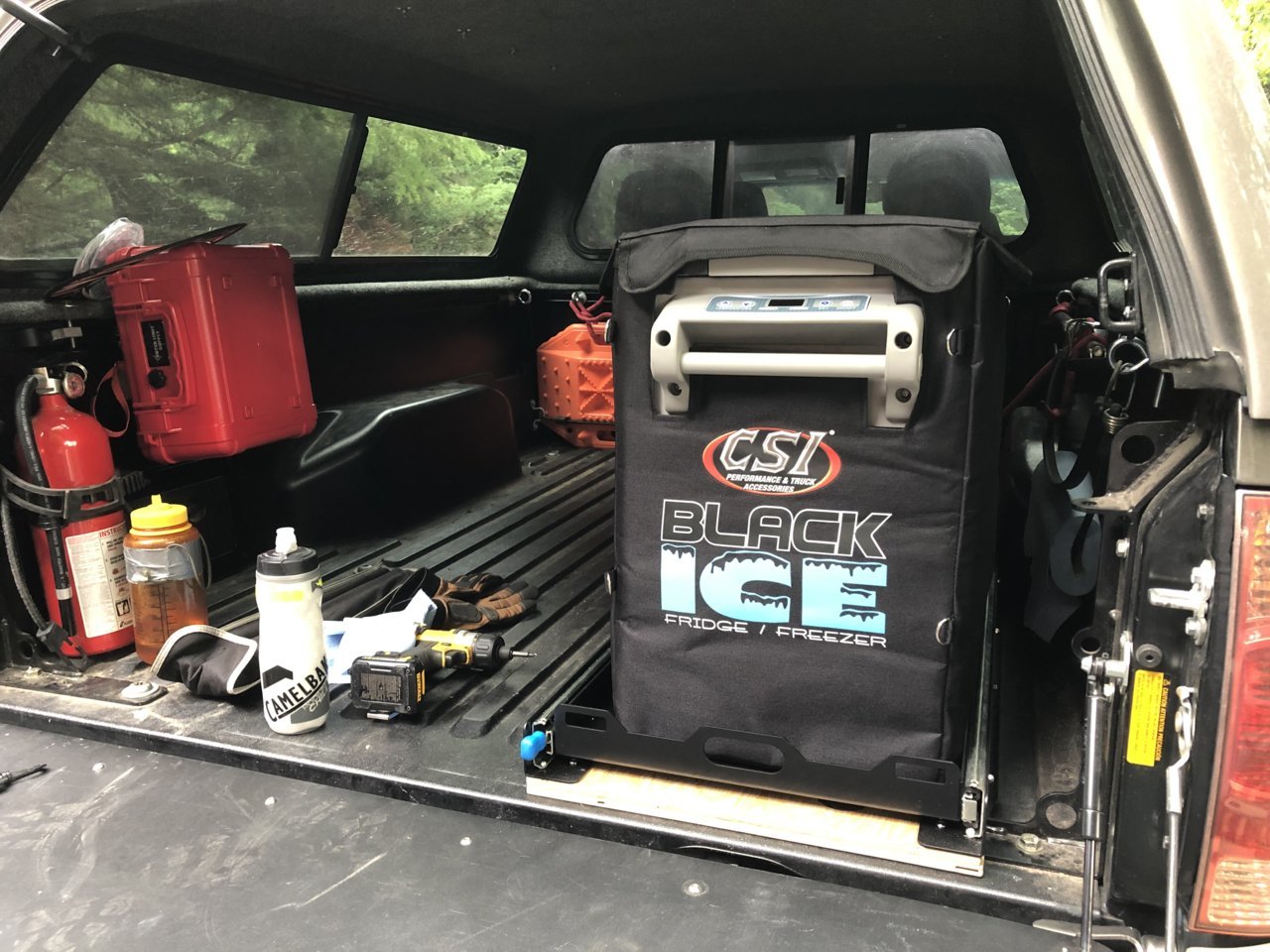

    About halfway done...
    81B7F52C-73C4-4F62-BCE0-2517E8C7C106.jpg 5EB0E0AF-7165-4B4E-8B95-D398657BC221.jpg 81B6E8AB-F837-479A-A11E-74B73478CC30.jpg F919255D-C336-4DEE-A5EC-892A31430BAB.jpg

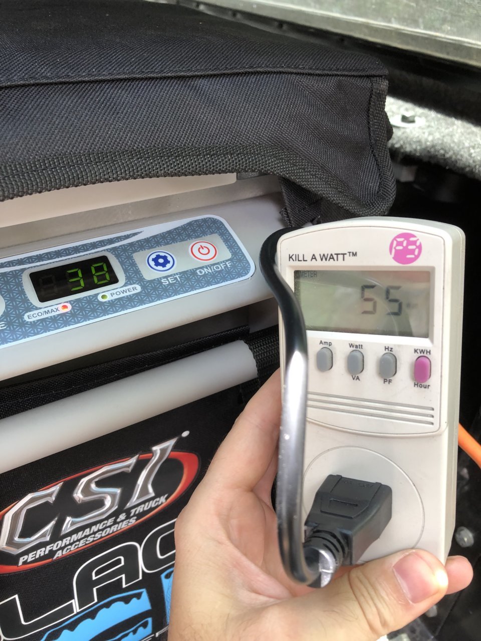

    So I plugged in my killawatt and found a 55watt draw. That was at 110v.

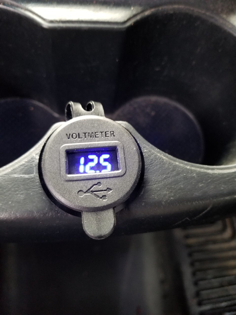

    I’m thinking of changing out my voltage gauge to one with amps and voltage.
    Yes I did 3/8 plywood worked great.

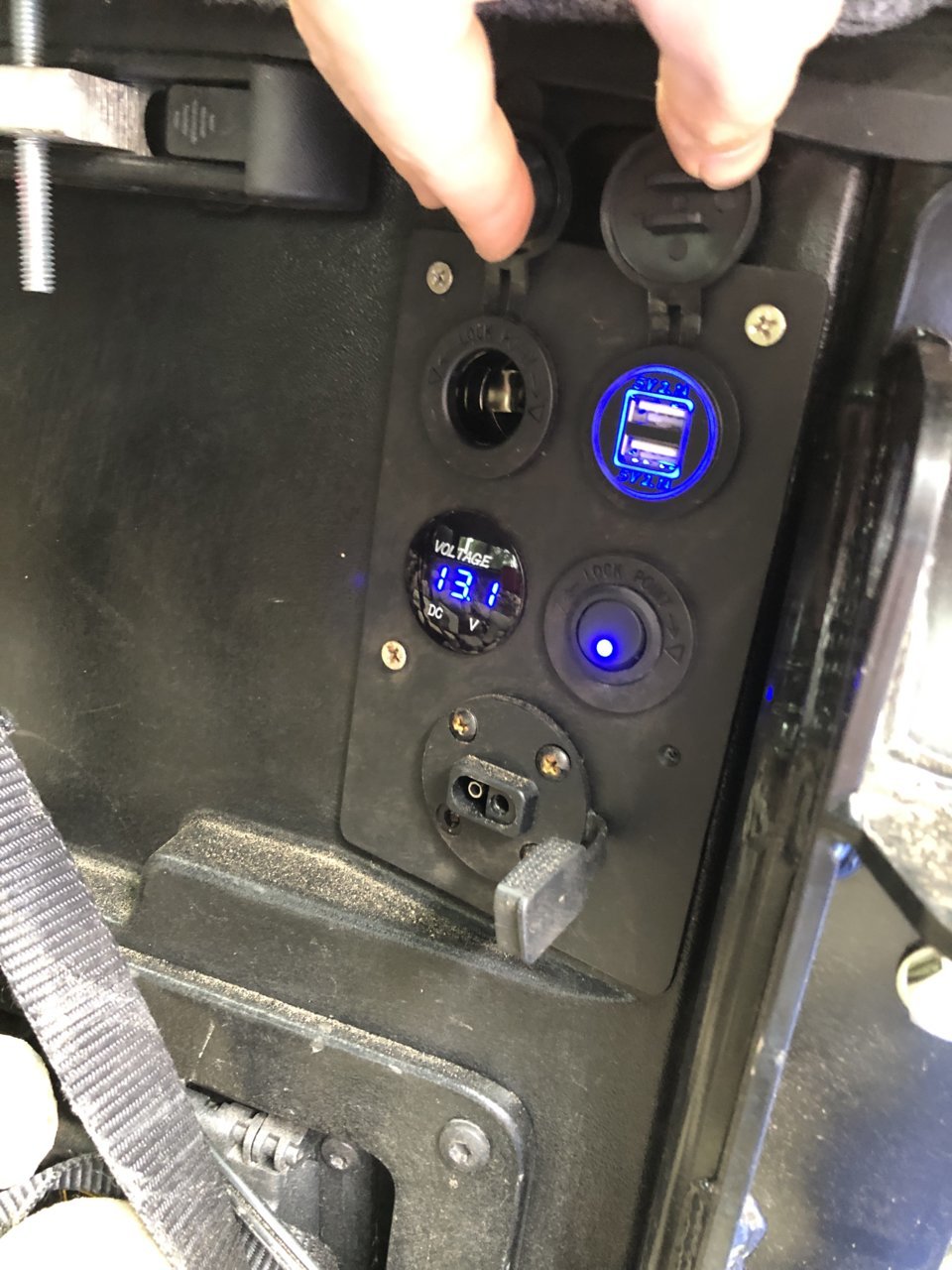

    For the always on outlet I used 10 gauge wire which still gave me a voltage drop from main battery (0.2)
    I used ASE plugs instead of cig light outlet thinking it won’t vibrate out.

    I totally forgot all my electrical knowledge once I graduated from college, but this essentially means that it draws about 0.5A? I feel like that number is really small, although I am comparing it to a 20A portable AC unit.
    If that is the case, then the 10AWG from the battery to the end of the bed should suffice. I assume a 10 or 15 Amp fuse should suffice?

    15 amp fuse is fine. As noted the draw is 50-55w compressor running, average useage has many other factors like ambient temp, direct sunlight, fridge empty/ full.

    I cut a notch in my bed stiffener.

    -I used this
    Blue Sea Systems 12 Volt Dash Socket https://www.amazon.com/dp/B001U4ZZPK?ref=ppx_pop_mob_ap_share
    -this
    VOODOO (2) True Spec 10 AWG Gauge... https://www.amazon.com/dp/B07CXZB5X7?ref=ppx_pop_mob_ap_share
    -and this. (Although get the 12 gauge wire)
    and haven’t had any issues.
    my only complaint is the wiring is white on the outside.

    So is 10awg better to use than 12

    I don’t think the thousands of difference matters between 12 and 10 gauge. I personally think I ordered wrong, and just decided to run with the 12 gauge. Haven’t had an issue yet. Fridge ran in the truck with no issues for 7 days while in Colorado running trails. Good, Rocky, shake the truck trails.

    10 AWG wouldn't hurt, plus if you want to run any additional items later on then you wouldn't need to upgrade wiring.

    Bed stiffeners aside, is that seriously the recommended mounting method for that slide? Looks like a bunch of tiny #8 sheet metal screws just driven into the plastic bed cover.

    I believe a lot of people screw down 1/2 plywood first then attach the slide. At least that's what I plan on doing

    It's a composite bed capable of supporting more than a fridge. I wheel mine at least monthly and have had no issues whatsoever.
