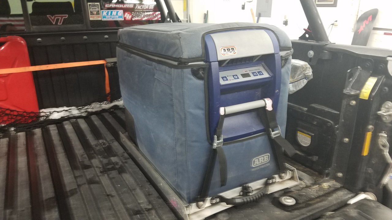

    I wouldnt use sheet metal screws. I drilled thru the bed and bolted it down,it's not going anywhere!

    How did you mount your bed slide? What did you use?

    1/4" grade 8 bolts with a fender washer and a nylock on the bottom side of the bed.

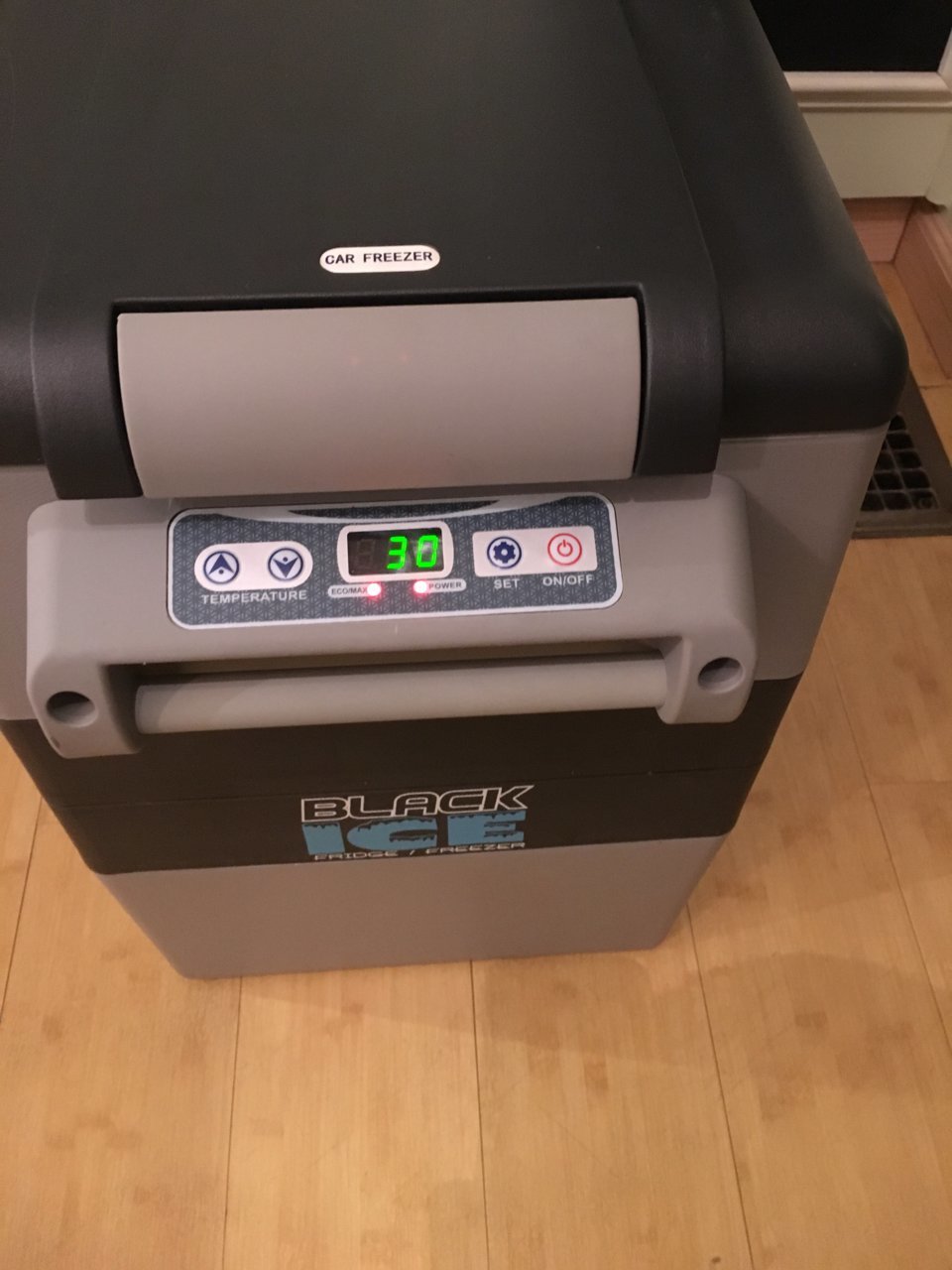

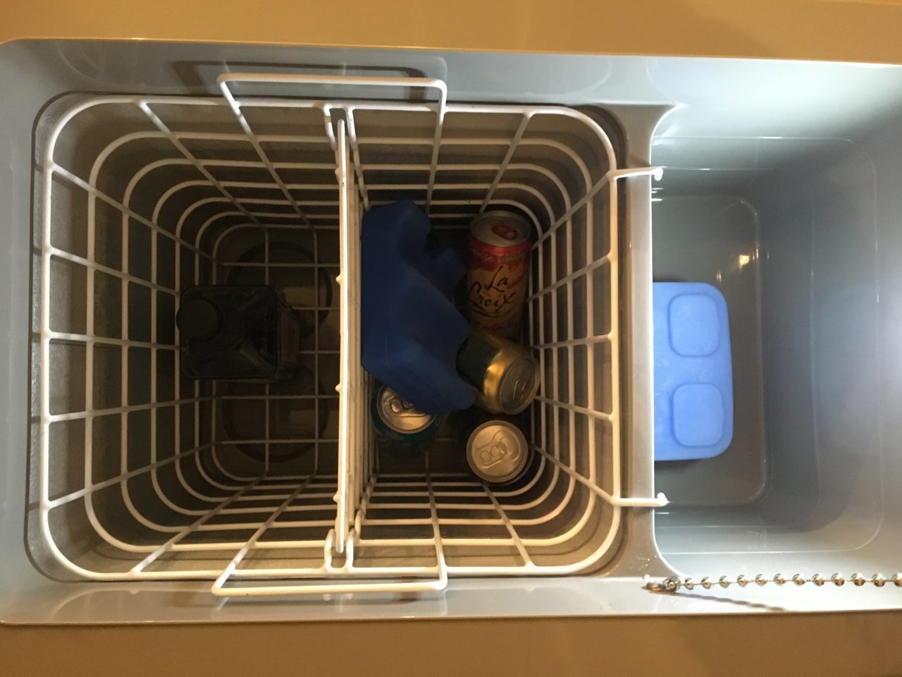

    Pre-chilled for a trip and it took 10 minutes to cool from 61f to 30f. I put some room temp beverages in along with a couple frozen ice packs to give it some mass to cool.
    4th time out with it (including a 10 day trip and a 7 day trip) and I've come to the conclusion that no more ice is awesome. No soggy food. No more running into town to get ice on long trips and I feel like this is one more thing that lets us get on the road faster as well...unplug from house and plug in the truck, strap it down, and go. We usually load it a couple days before heading out and just leave it plugged in.

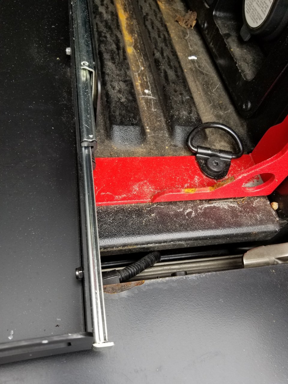

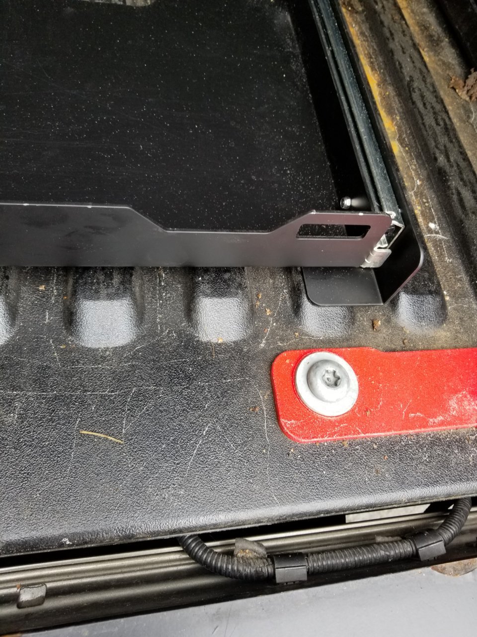

    I have the At The Helm Bed Reinforcements and the slide works perfectly without any modification.
    Greg.Brakes.Tacos and Beretta4x4 like this.
  19. Oct 7, 2019 at 9:09 AM
    #539
    Unchained 5150
    Unchained 5150 Rick
    Sep 25, 2014
    #139054
    65,355
    Rick
    Auburn Ma
    2021 TRD Poser Pro Manual.
    I will attach it right though the bed mat to the composite bed.
