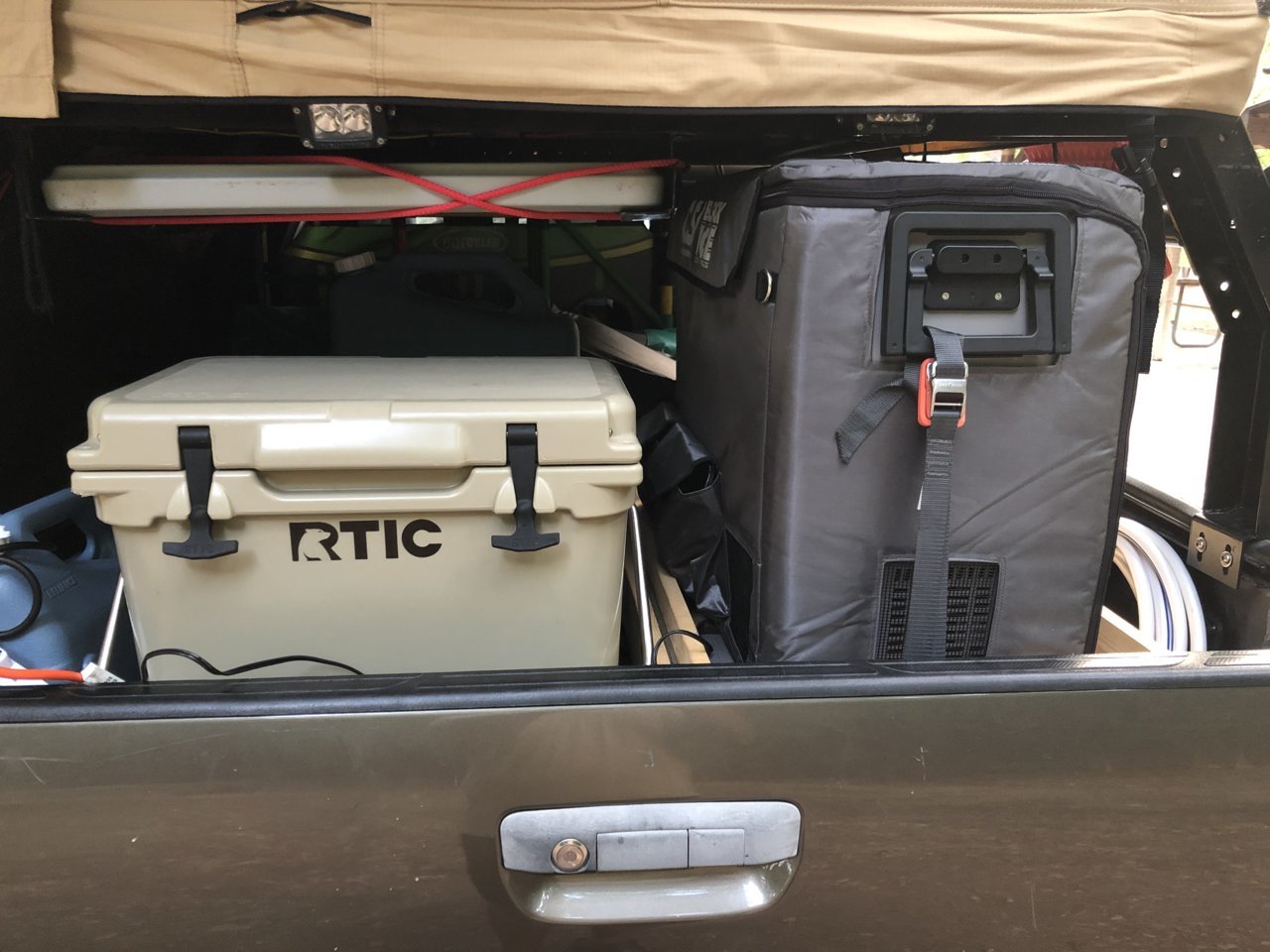

    The fridge worked awesome on a family camping trip we had for a week. Luckily we had power at the camp but while driving around towns the fridge ran off my battery. We took a small rtic to hold drinks since we had the fridge stuffed with meat, milk, eggs, etc.
    Thanks Mike for the awesome service and speedy delivery.
