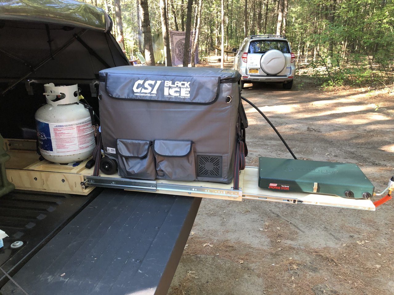

    Went camping friday, saturday and today with the fridge and it worked pretty good. I had it on the lowest protection setting (9v) to avoid the issues above and ended up having the opposite problem. The fridge drained the battery today and I wasn't able to start the truck. I had been idling the truck in the morning and evening for about 20min to charge the battery but I waited a little too long today (10-12 hours) before trying to start the truck and it gave a weak try then just clicked. I was using both sides as a fridge set at 37F on ECO and noticed about a 1 volt lower reading on the fridge while the compressor was running vs an installed voltmeter at the outlet. When the compressor was off the readings were equal. The fridge is currently running with both sides still at 37F on ECO set at medium protection and I'm trying to see how long before I get the F1 code. I have noticed that voltage has dropped below 11.5v without the fridge shutting off when the compressor is running, seeing 10.8v right now.

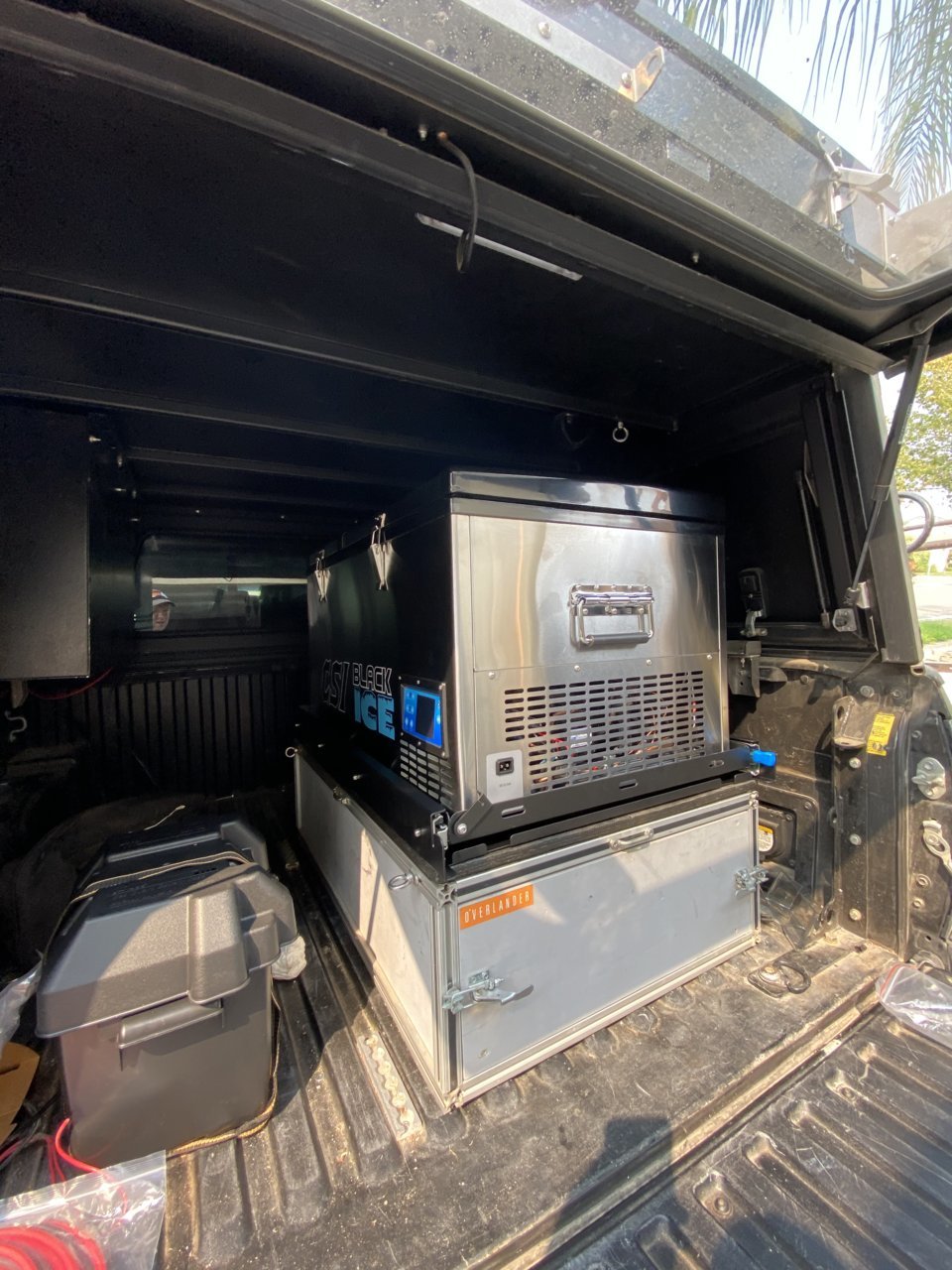

    Received my W55 today with slider! Initially, great quality minus the ding in the corner, which I guess I can get over. Once everything was mounted in the bed, I applied 110 power to it to get it cool before switching it over to my battery. However, it never cooled. The fan came on and the compressor made a terrible noise which sounds like a knocking compressor. The first 2 hours I had it set to 37 degrees eco mode, then I switched it to max mode for 2 hours with it not cooling a single degree. After 5 hours of being on AC power, the unit is not cooling at all. So overall, not initially happy.. tomorrow I will reach out to Mike and see what can be done. I will leave it on AC power throughout the night, but I’m not hopeful.
