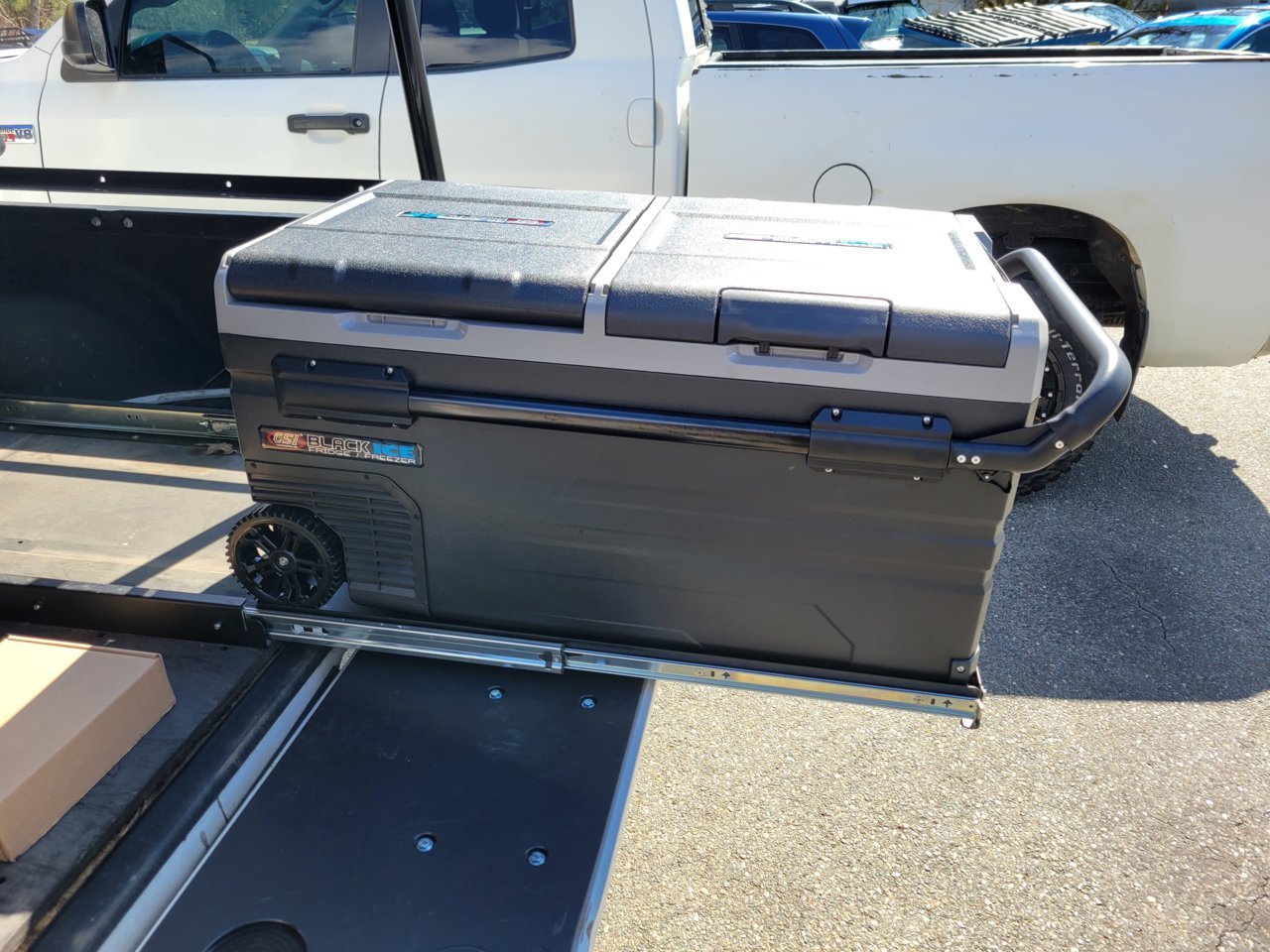

    Well it fits on the slide, but will require removal of the rear wheels to really be mounted.

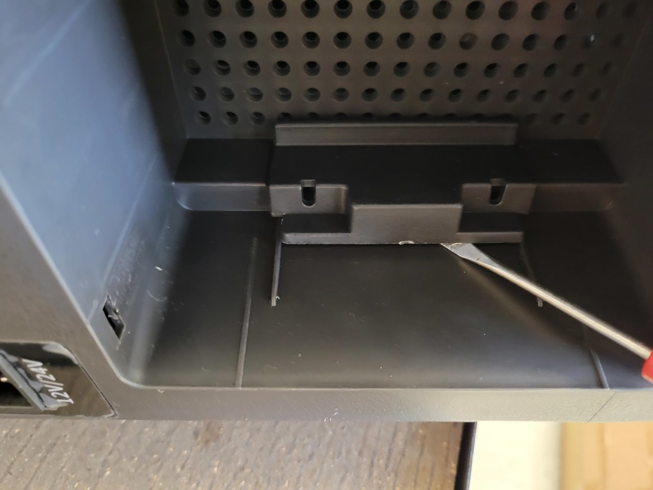

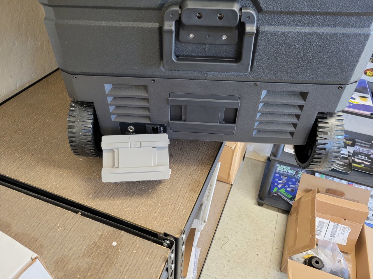

    When installing the battery, remove cover and inside there is a protective cover for the battery pins that require removal then simply insert battery,push the on button and away you go.

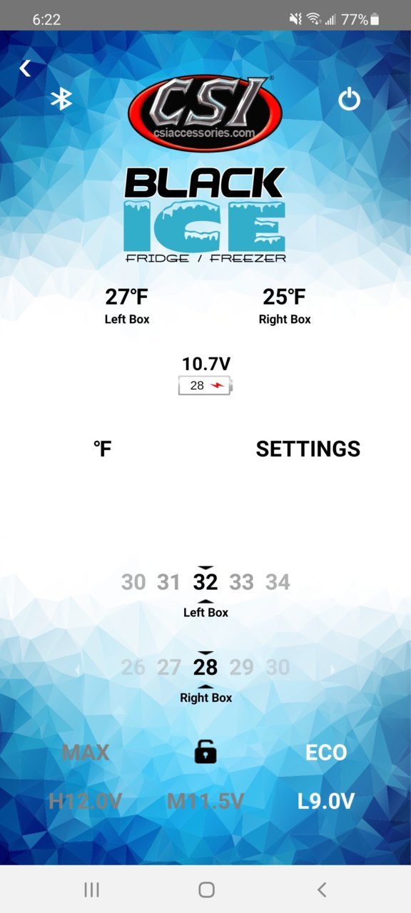

    Did some testing on the run time of the internal battery and here is the result after 9 hrs running by itself. Still had some life left. Screenshot_20210317-182231_CSI Black Ice Fridge Freezer.jpg

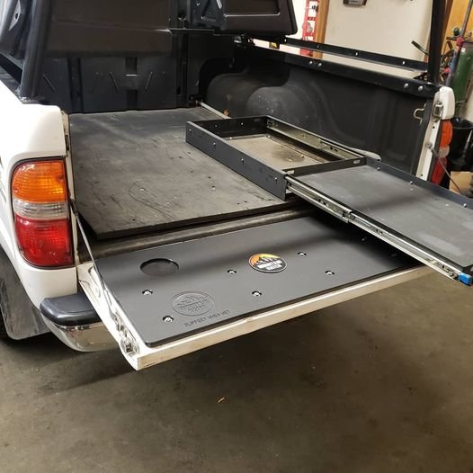

    I am interested in the 53 Mike. I am wondering about the slide however, how is it usually mounted in the bed? Is it stable enough to strap down the fridge tight to the bed and use the slide unmounted or is it required to be mounted? I don't have a drawer system or anything I could easily mount it too right now. Thank you for any information!
  13. Apr 8, 2021 at 12:12 PM
    #893
    Mike's Custom Toys
    Mike's Custom Toys [OP] Well-Known Member Vendor
    Jun 28, 2017
    #222593
    1,092
    Grants Pass, OR
    Most of us mount it to a 1/2" sheet of plywood.

    I have a different fridge and slide mounted in the bed of my truck. I just drilled 3-4 small holes on each side of the slide through the bedmat and thru the bed. I then slid a bolt thru with some big fender washers between the bedmat and the bed and one under the bed so the bed is sandwiched between the two fender washers. I was going to use some bigger flat bar aluminum as a big washer along the length of the slide but so far the fender washers have been holding it well without issues.
