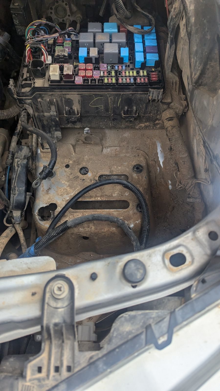

    Swapping out the main power cable harness for funnsies.
    Ok actually because the Genesis dual battery system has worn through my negative to engine block cable, cranking battery is constantly dying and busted up/cracked my mounting location sheet metal (known issue, find a way to fix that later)

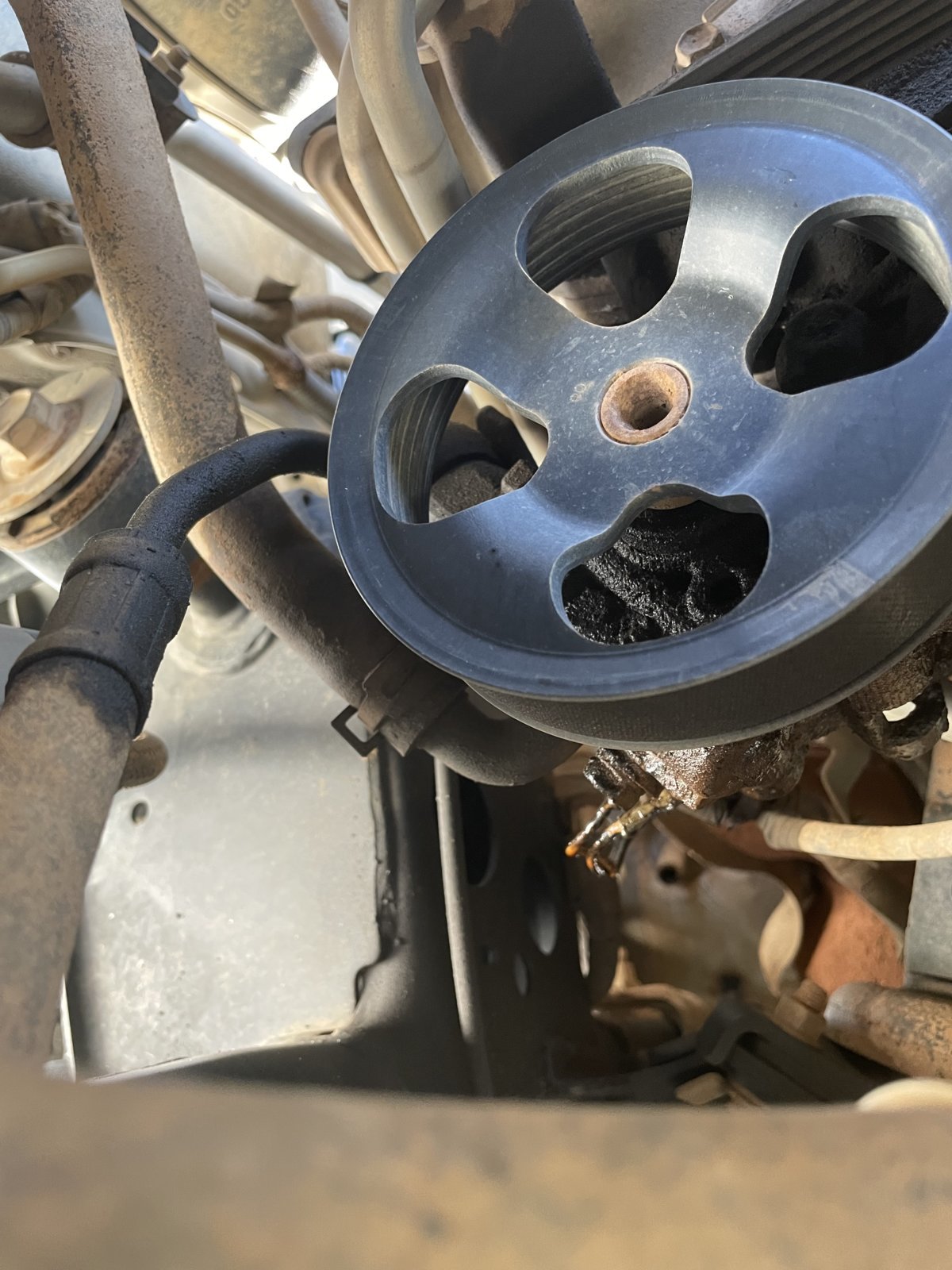

    Ohh look finally got timing chain cover leak I’ve always wanted!

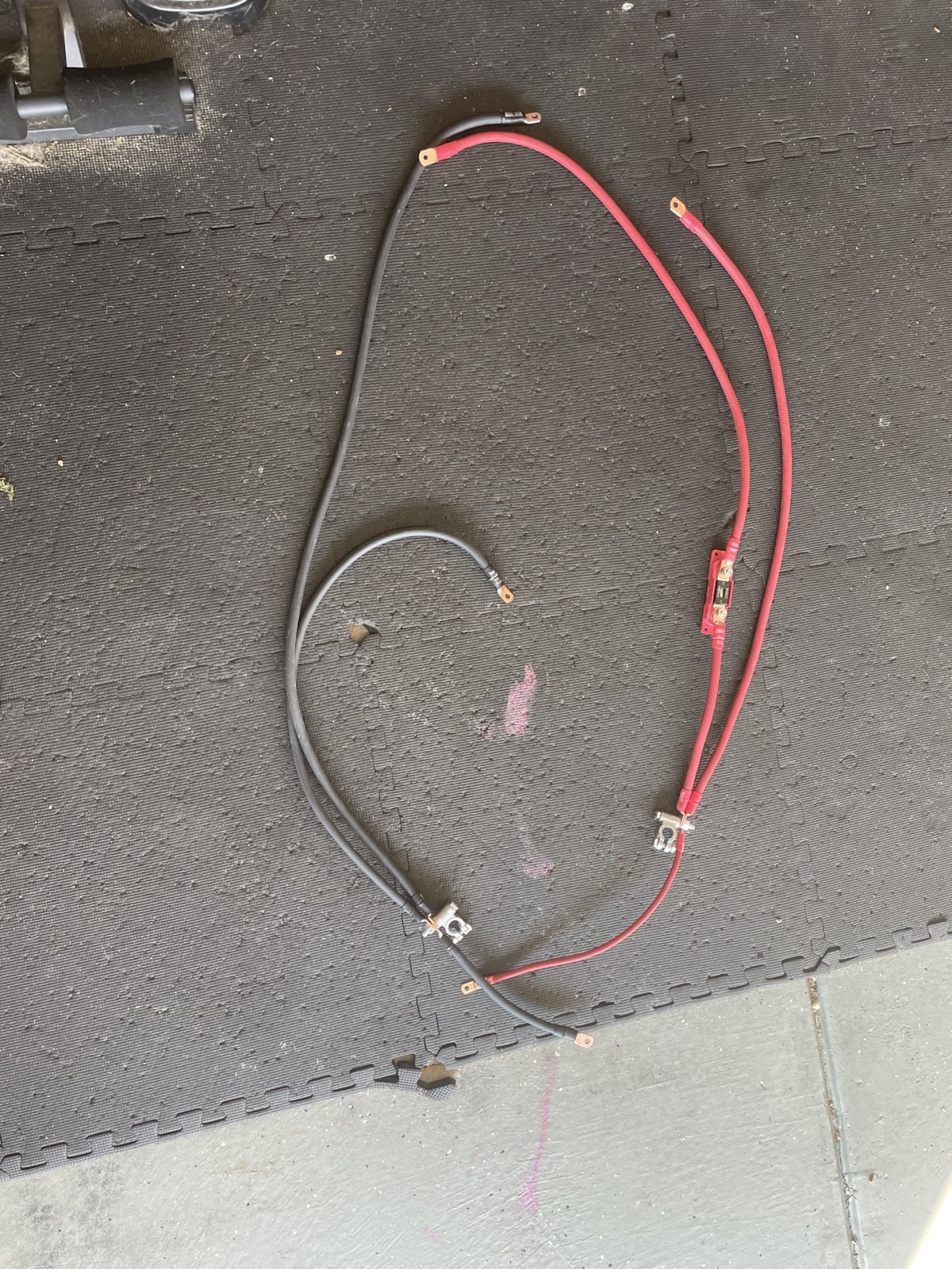

    Managed to go back to a single battery setup and change out the stock battery harness with a 1 gauge substitute!
    Amazingly the truck started!
    Group 31 battery fit in the stock tray and the new cables reached the front side +/- posts.

    Group 31 has served me well for quite a while. Also cracked my sheet metal a bit though…

    Cracked mine a ton with 2 in that spot!
