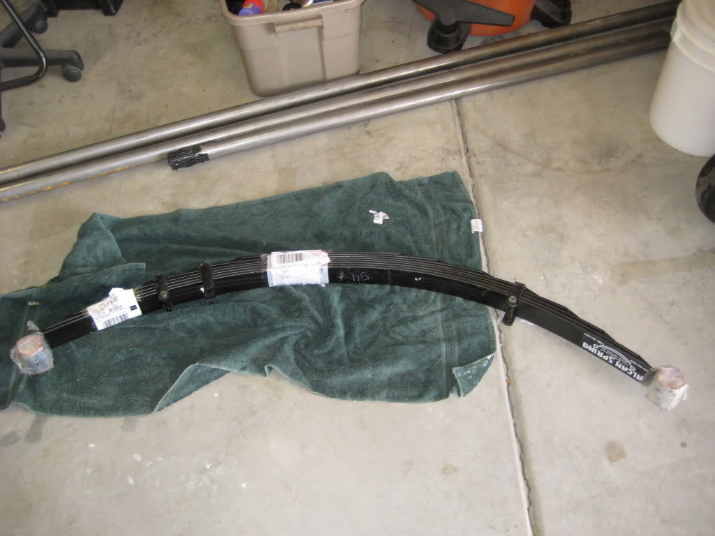

    Alcan Leaf Spring Addition
    Alcan builds the leaf springs custom to your specifications. They already know the length that is required for different heights for the 05+ Tacoma and probably for the 1st gens as well. You just need to specify what additional weight you will have on your truck that will affect the ride height. The springs are already built to have 1/2" additional height on the driver’s side to counter the gas tank weight.
    The Alcan's definitely softened the ride and gave more flex to the rear. The biggest downside is that the back of my truck is roughly 1/2" lower than the front. When ordering that was one of my key points, that I wanted to level it out. Oh well, shackle flips in the future or adjust the coilovers.
    Another downside, they are not impervious to rust. The salt and mag chloride definitely broke down the paint and rust started within the first winter.
    I went ahead and added the All-Pro U-bolt flip along with the Alcan’s. Added more clearance under the axle and cleaned it up a bit. I used the stock bump stop by tapping the plate that came with the U-bolt flip. I quickly noticed that the bump stop was going to be far too short with the extra added space between the frame and the axle. I need to get a longer bump stop now.
    All in all I am happy with the purchase but still require spending more money on the rear suspension.
    Not hard at all. Lift the truck by the frame or tow package so the axle can hang, then slightly lift up the axle and support. Unbolt the u-bolts then the leaf springs. I believe that I had to remove the shackles from the mount first then the shackle from the leaf springs.
    When putting the new ones on, remember that the drivers side had the gas tank so the spring will be a little longer (about 1/2") to compensate. Don't be like me and put them on wrong and have to do the install all over again.
    Another thing to keep in mind is the direction of the bolts. If you put them in backwards on the shackle side, the extra length or nut will hit and not allow for full articulation.

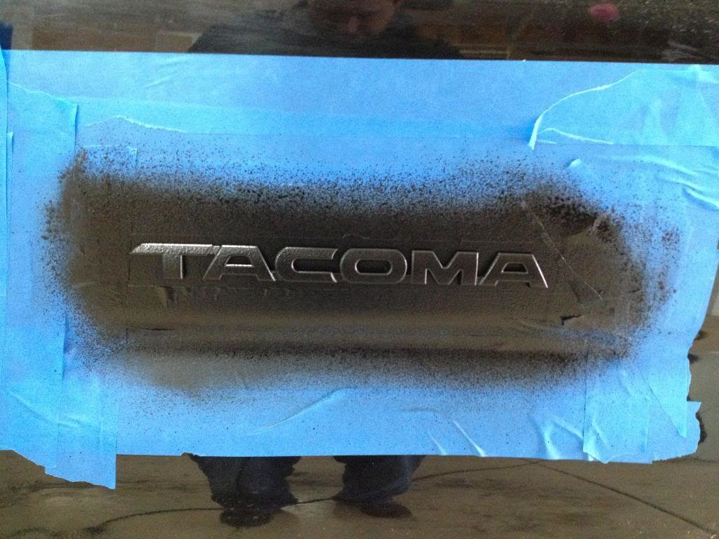

    Plastidip: Cup holder, door switch cover, side badges, rear bumper

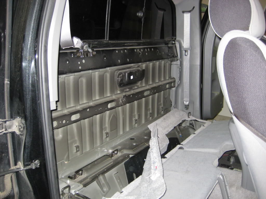

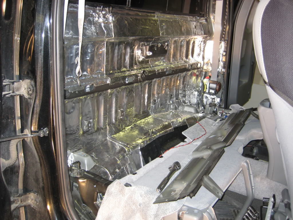

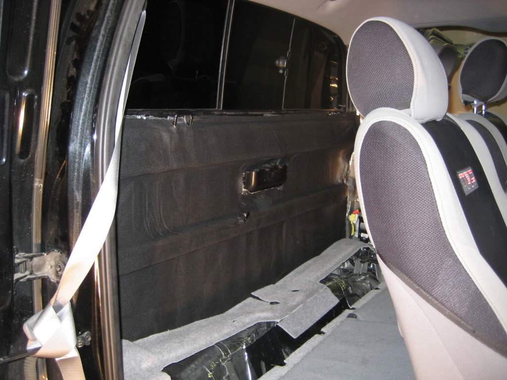

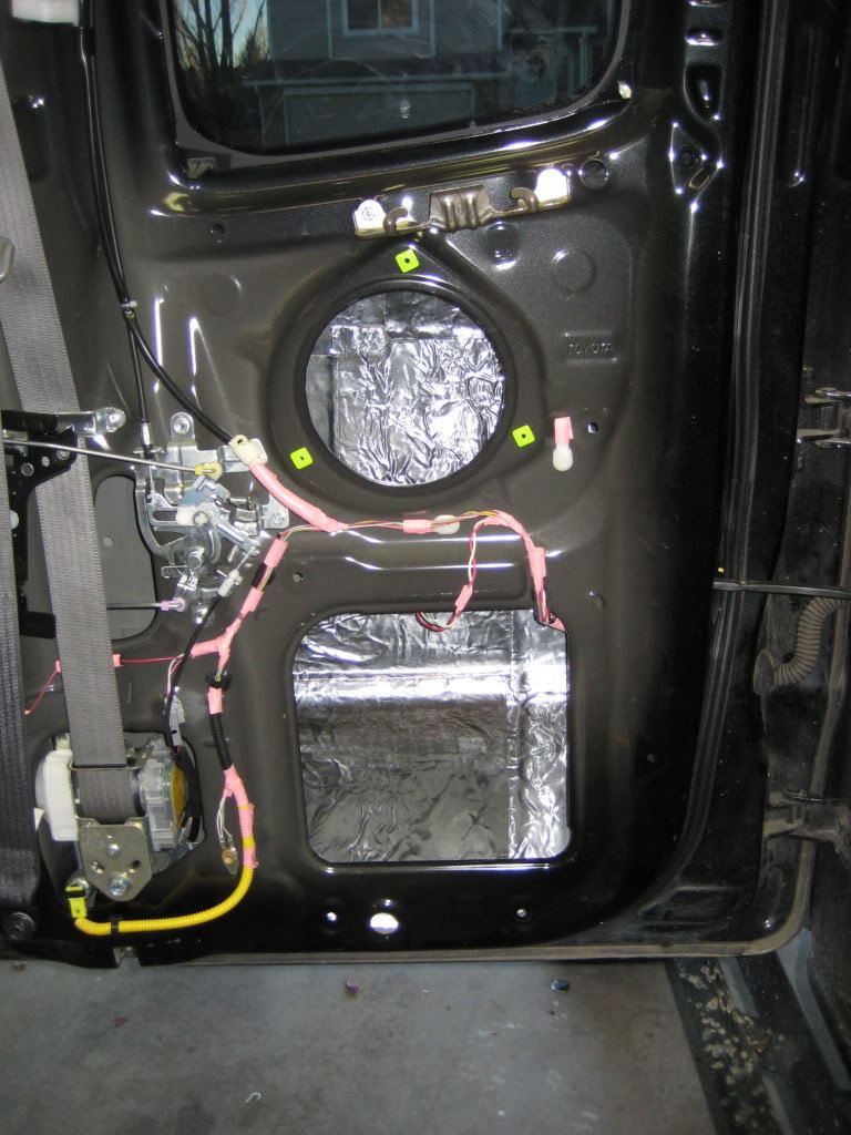

    Raamat Sound Deadener
    Took a long time to install but was worth it. Cut the road noise down alot. The biggest improvement however was adding foam to the vent hole at the back of the cab. It pressurizes the cab a bit with the AC or heat on but reduces the road/wind noise alot. I had plenty of cuts from the aluminum when i was done.

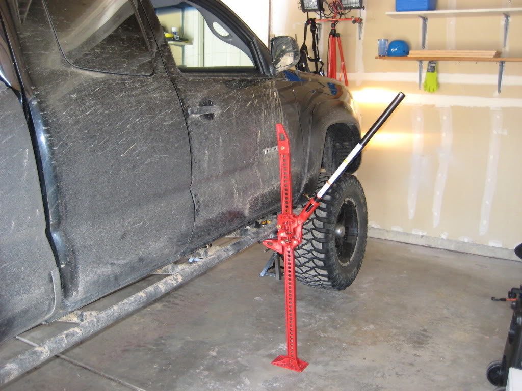

    Door Dent and Scratch - I was lifting the truck like the below picture shows and the hi-lift slipped out from under the truck. Must not have been straight up and down and the floor was slick. The top of the hi-lift went into the side of the passenger door.

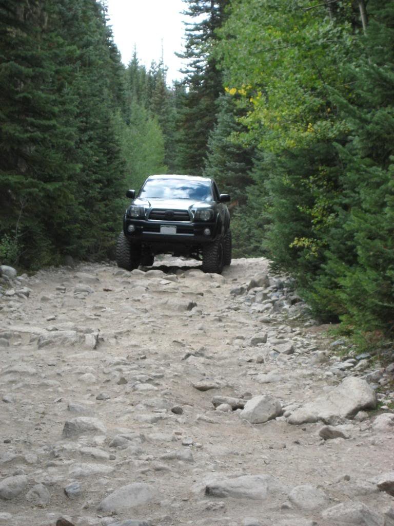

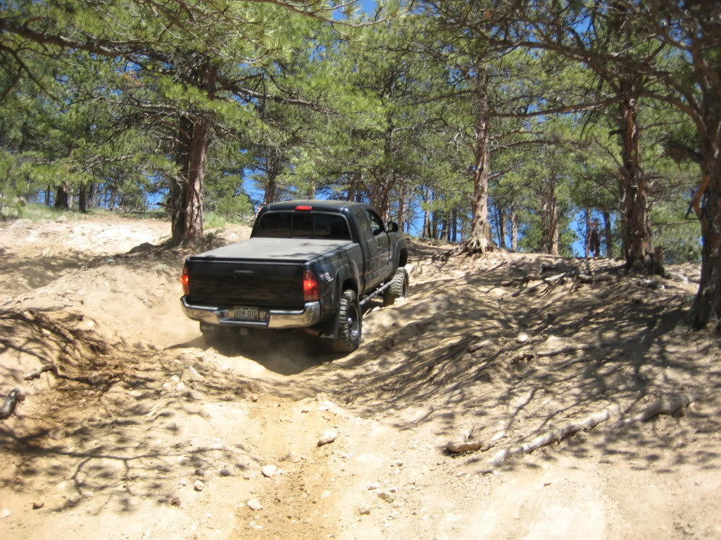

    My truck is the tallest one in the center of this pic. This was the trail ride after the first Colorado Mod Day.

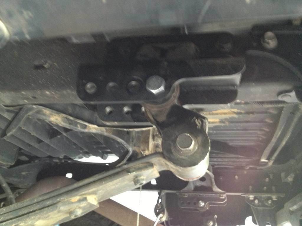

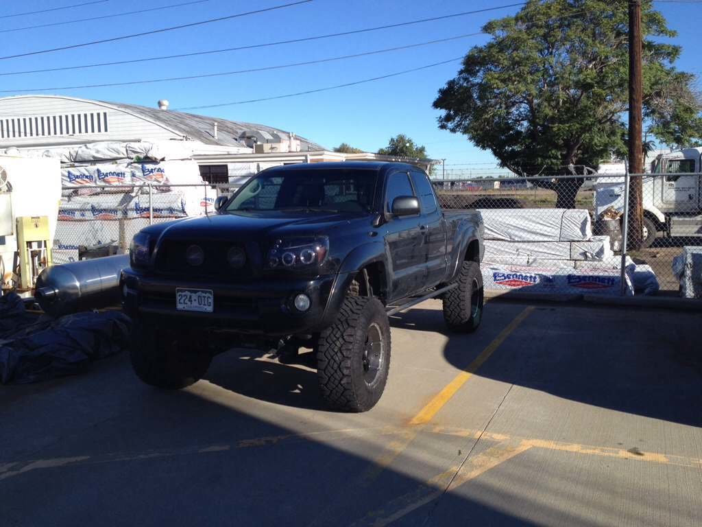

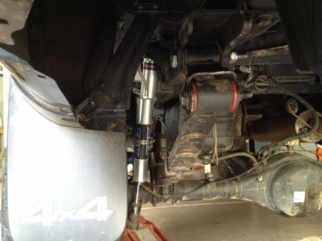

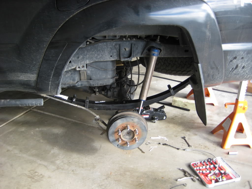

    Did some work last weekend:
    Was up till midnight Sat night drilling out the rivits and installing the new shackle flip hanger.
    Make sure to use a right angle drill or BFH and some heat to the frame.

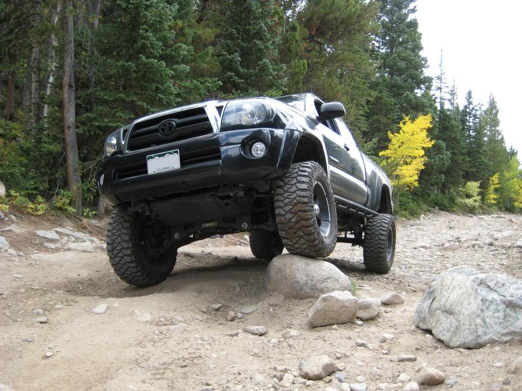

    Just purchased and installed some used 315/70r17 Duratracs.
    Joined the 35" club :)
    Now I need to cut the front plastic and the cab mount so that i don't have any rubbing.
    Currently the rubbing only occurs if I am turning hard and the suspension flexes from a bump or curb.
