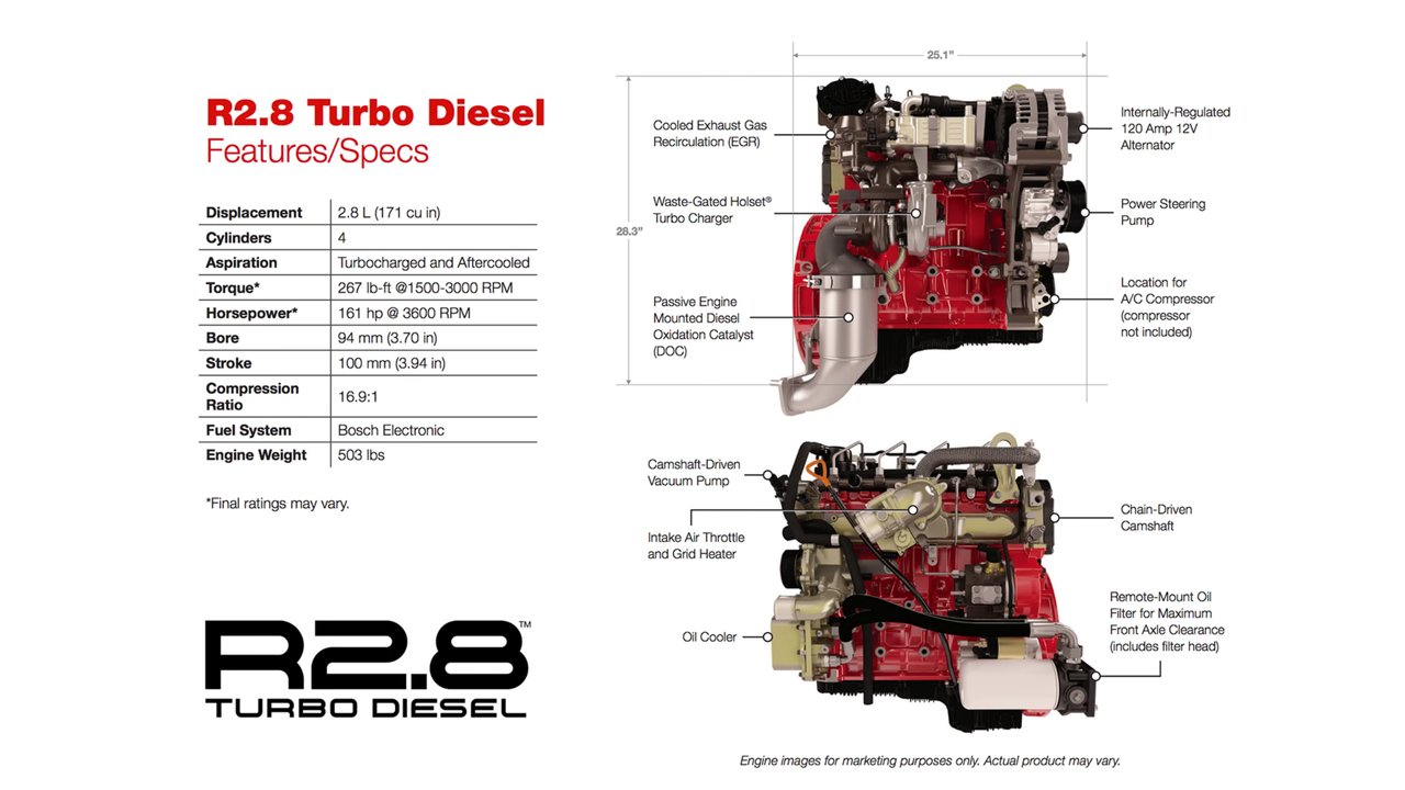

    The engine manufacturer is asking the public to create engine swap kit engines. Drop in for the most part. Not talking about compliance as this would be tested by the engine manufacturer.

    The one in the video is a Cummins. You might have got a better reception if you explained why this swap is worth the time. It might have also been better if the demand was there.
    I'm sure that it's very "drop-in." You should be the first one to take this leap then.

    Better reception...
    It's diesel roughly the same size as the existing engine. Engine weight nearly identical. Horsepower adequate for a cruising vehicle and torque nearly 80 foot pound more than the 2.7 and very close to the 4.0 and 3.5 gasoline Toyota engines.
    Also if people would actually read the first post they would realize the link goes to the Cummins Repower page which you click on the greyed out engine that says coming soon and go through the survey. If Cummins receives enough good reception they actually may do something.
