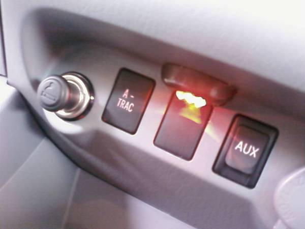

    ok here are the pics and i will add some step by step
    first remove your center console, its easy if you dont know how im sure u will be able to find a thread for it.
    second with the entire console removed pop out the blank switch space, mines in the center, it comes out with a flat head screw driver.

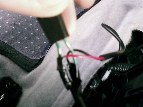

    third run the wire through the hole and down to the shifter
    now remove the face plate of the shift bezel and you will see a led light that is orange, twist the bottom of it and it will come come out
    one side is a pos and one is neg
    strip them down and and connect you wires for the led light as shown bellow.
    with this accomplished the led light will now turn on only with the parking lights and and head lights

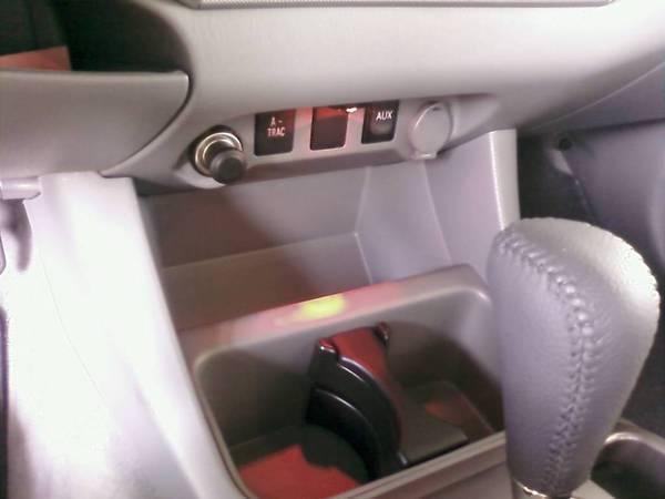

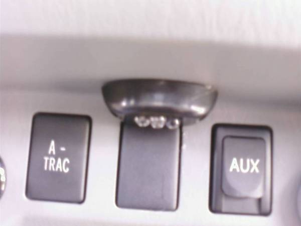

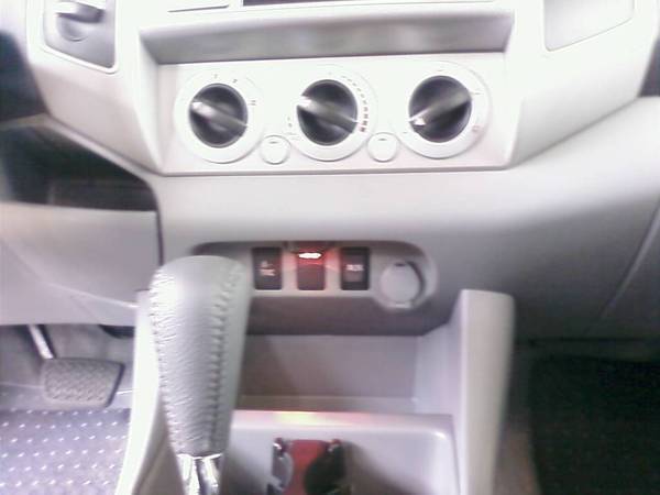

    if you are like me and dont want to screw anything down just double sided tape it in..... lol. here are some pics of it finished.
    and yes when it gets dark i will post some pics.....
