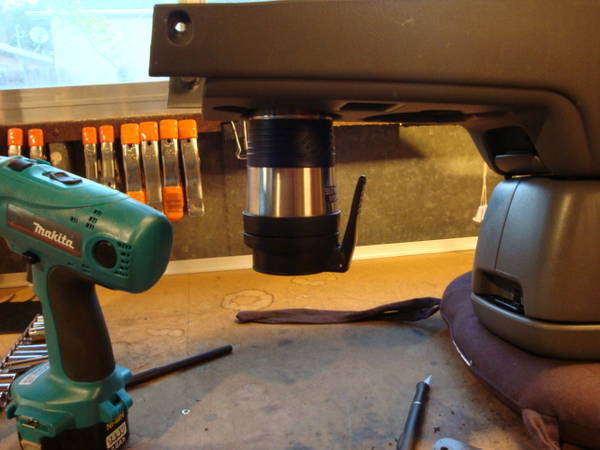

    I just made some new ones today out of 1/8 gasket rubber I found at the local hardware store in the plumbing department. I figured that if the original material was crap, it is still crap (weird foam sandwiched by weird plastic film), and I can do it better. Just take out the old ones (4 are identical, one is a double-sided deal), use them as a template to carve new ones with an Xacto blade, and it is better than new. You can make them in the amount of time it would take to go to the dealer and back. I took pix and will post them when it is not 11:10 on Sunday night...zzzzz.

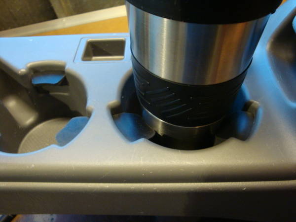

    Guys, I'm telling you, go to the hardware store, and in the plumbing department, get a small sheet of black rubber gasket material, 1/8 inch thick, and trace the originals onto this, cut them out, and drill holes for the screws. I did this, and it is literally better than new. Still haven't done my write up (do we really need one?), but it is awesome and you can't get any cheaper. Holds cups very firmly, but it's easy to pull them out, and the rubber will never go bad.
    Here is the rubber:
    And it is strong enough to hold an empty steel coffee cups upside down!
    And here is a shot from the top:
