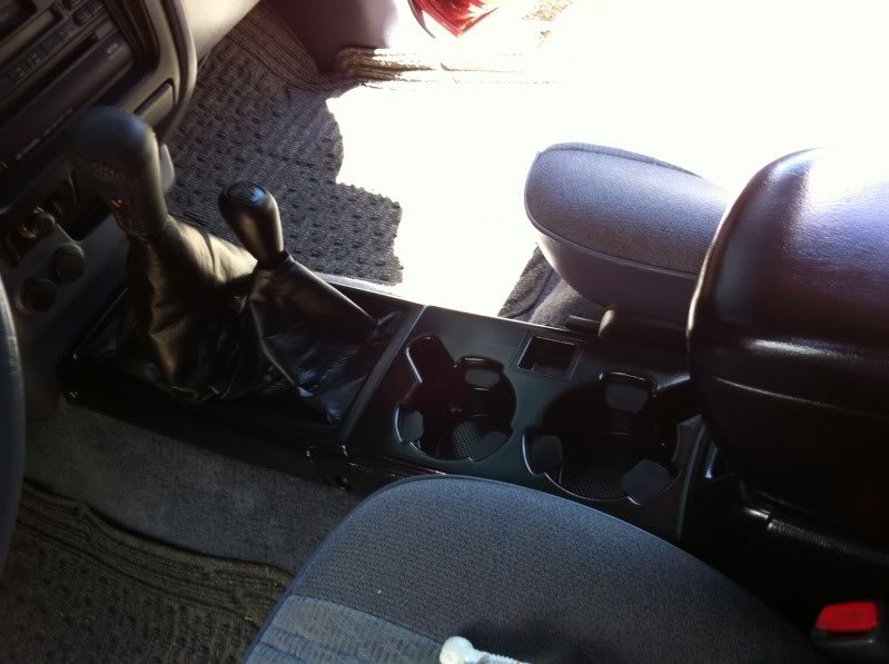

    However the best f'in mod ever is to swap in an 01-04 center console/cup holder assembly.
    There are very few things that actually improve my life, this was one of them.

    Just pop the switches out, cut new holes in the 01-04 assembly and pop the switches back in. Or get a switch plate for your single din cubby and put them in there.
    It's been, I don't know, 6 months since I put the 01-04 in my truck and I don't know how I lived life before.
