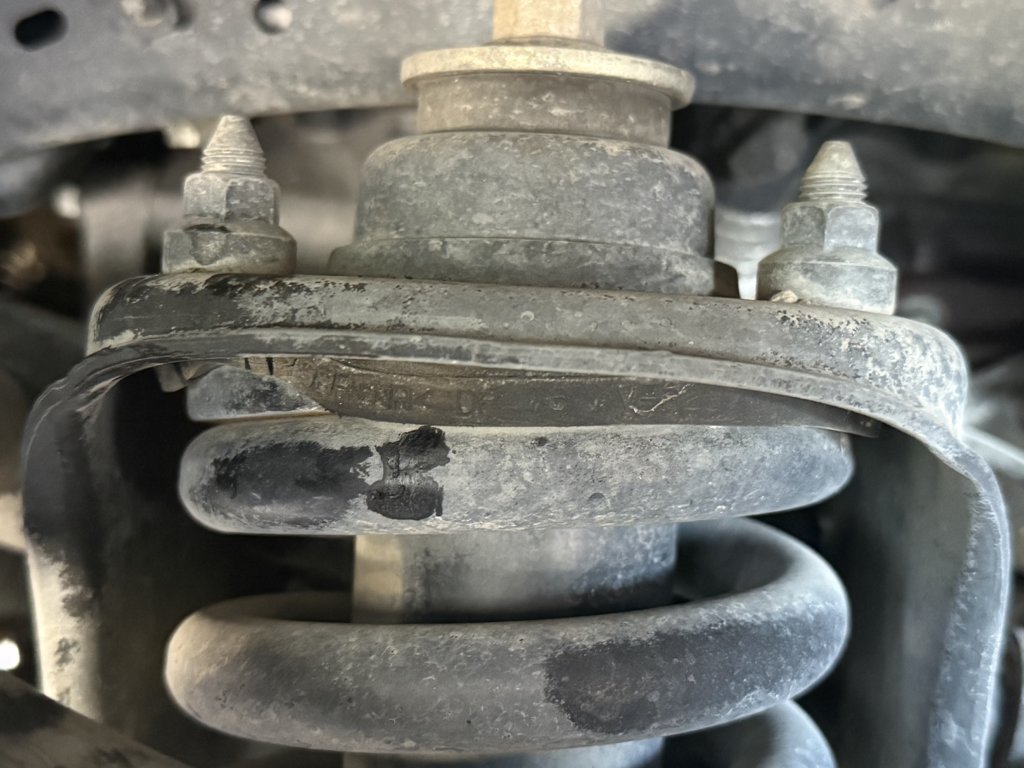

    I found this rubber gasket looks a little off on driver side. Also found greasy tie rod boot on driver side. Not sure if from road or rod. The CV axle has a little play and a squeak. Next, both tires in front have the same amount of lateral play. It’s small so not sure if tie rods with how good the outer end looks. Didn’t have time today to check inner due to apartment manager driving by and telling me no car work.

    The top of the spring coil isn't flat, so the rubber isolator will always look like that.

    The play in the CV joint, the crooked rubber spring isolater, oily steering boots etc. are all very typical on these trucks.

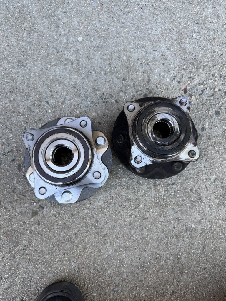

    Update for anyone following, the play on the wheels seems normal, you can see the steering wheel move for lateral movement and if you hold the wheel like @4x4junkie said, there is no movement. After more inspection it looks like it’s the driver side bearing that’s donezo. I didn’t notice y axis movement yesterday but found it today, and considering the cupped tire was on that wheel before my last rotation, that’s gotta be it. Looked into bearings and gonna go with @05Taco4x4 pressed hub and bearing kit. Thanks to all that replied!

    It was the bearing. Replaced and everything good now. New tires being installed as we speak and alignment tomorrow

    I got the both hubs and bearings pressed from @05Taco4x4 for $350 even. Had all the tools I needed aside from a 35mm socket I got for $8 on Amazon. Knocked it out in 2.5 hours so no labor charges. Not sure if he sells only 1 but if you do it I’d say just knock them both out.
