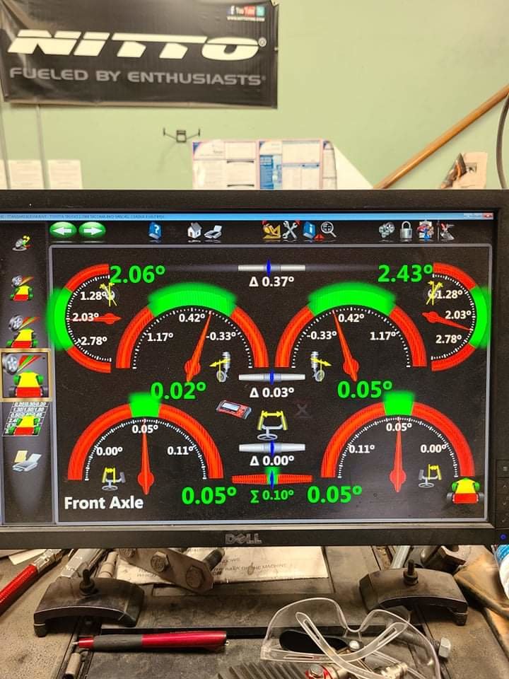

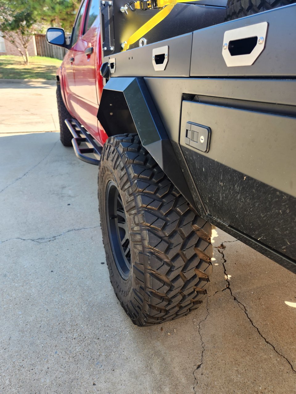

    Brute Force Fab front bumper Dobinsons Snorkel 35" Nittos Bilstein 5100s ICON leaf springs RSI SmartCap Bed Replacement Diode Dynamics lighting Custom built morimoto headlights RCI full skid
    That is the craziest thing I've ever heard. 100% worth looking at the alignment numbers to see what they look like. Alignment I did 2 years ago on my truck and not touched it since. Zero cupping/feathering with my tires. Currently running Nitto Trailer Grapplers 35x11.5r17. Put about 15k miles on some Falken MT 285/70R17 and almost have 10k miles on these Nittos. For reference I have Bilstein 5100s with OME 887 springs up front and factory upper controls arms. Also I run about 28 psi all the way around.
