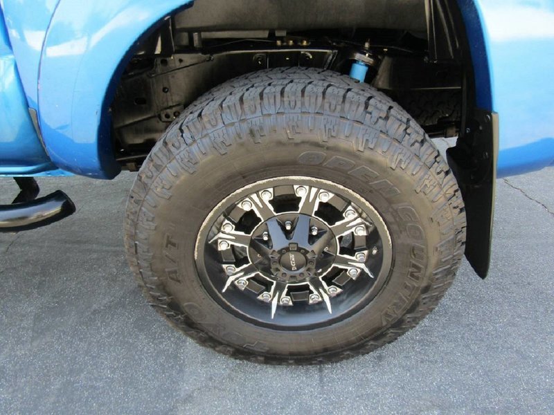

    Whats the best way to tackle curb rash on a rim? Recently bought a 06 Prerunner that has some nasty curb rash I'd like to repair. Let me hear them ways.

    That unfortunately is not an option seeing as I just spent a lot buying the vehicle.
    I've read you can fill the curb rash with Sandable body filler but unsure how well this will hold and not crack and fall off.

    Need some pics.

    So I'm very new here. Just got my Tacoma home today actually! Anyway just wanted to say, previously I had a 2005 Ford Ranger Edge with some pretty severe curb damage to one of the wheels. I removed all 4 wheels, placed index cards in gap between wheel edge and tire all the way around and evenly and heavily coated them in black plastidip (about 4 coats). I very much loved the look but mainly they hid all damage very well. If you didn't know it was there you could't tell. I did this in 2011 and it never came off or flaked and that truck got totaled last week. My wheels were aluminum so that may be the difference but it worked like a charm for me.

    I would just scuff the rough spots down and use a black paint pen. I've seen people try and use the body filler on car wheels before. Doesn't like the heat that gets transfered from heavy braking. There are shops that can "weld" in the deep spots and machine them down. But honestly the wheels you can get nowadays for arround $100 a piece are pretty nice.

    Seeing as plastidip isn't too expensive I might as well give that a try.
